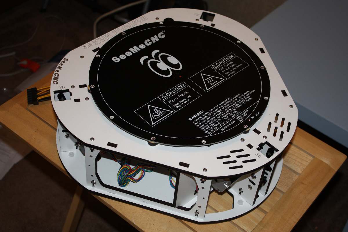

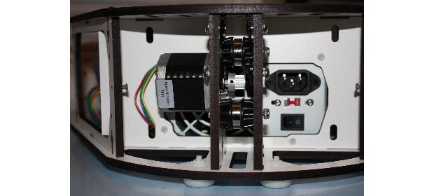

    The base is pictured as well as a view inside of the idler bearings, power supply, and a stepper motor. There are three stepper motors for the x,y, and z axis and a fourth, not yet installed that feeds the filament through the hot end/ extruder.

            Heated Bed wired up and mounted (complete with the elusive Kapton tape).

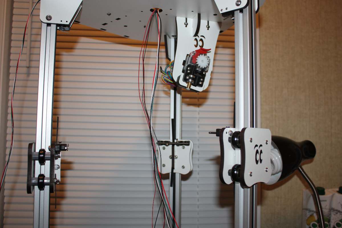

              Towers and Top assembled with wires streaming from every orifice. Next is cheapskates assembly.
                Skates mounted and belts properly tensioned. EZStruder mounted. Wiring is next up.

                  Delays abound! I got the HotEnd of the Extruder wired up and mounted, then I broke the effector putting the axles on. I emailed them last night and asked to purchase a new effector with the axles pre-installed. They are sending just that tomorrow morning and not charging me a dime!
                  The people of SeeMeCNC.com are the best people I have ever dealt with!
