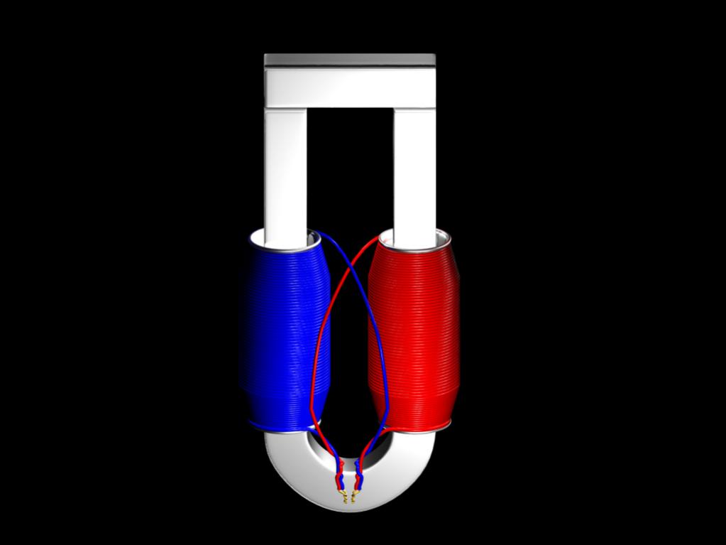

        • #34
ID:	46939 This is a simple picture of it...the bar accross the top is not attached. the idea is if you set the bar near the ends...one small tap on a battery creates "perpetual motion" because once you start the magnetic flow in a loop it just keeps going untill you disrupt it by pulling the bar off. Its just stuck in my head that a permanent magnet you take that bar off and the magnetism goes back to normal....in the pmh when you take it off you have to pulse it again if you want it to stick.
          I don't think the answer i am looking for exist yet ....im trying to find what causes the flux in the core to "get stuck". in a coil/core magnetism can flow .....in a magnetizer magnetism can flow i understand one is a far larger flow...but a river and a creek can both run a water wheel. so what is it that is the difference. is there just a certain point of flux that is reached and pow its permanant....or is it the starting from nothing and jumping to the flow causes by 10,000 amps that makes it stick. you said it was simply the characteristics of the core. so the deal is a coil can make magnetic flow in a core but if you want a permanent magnet from that core you would have to shove so much flux in that the core overloads itself and becomes a radiating permanent magnet?
