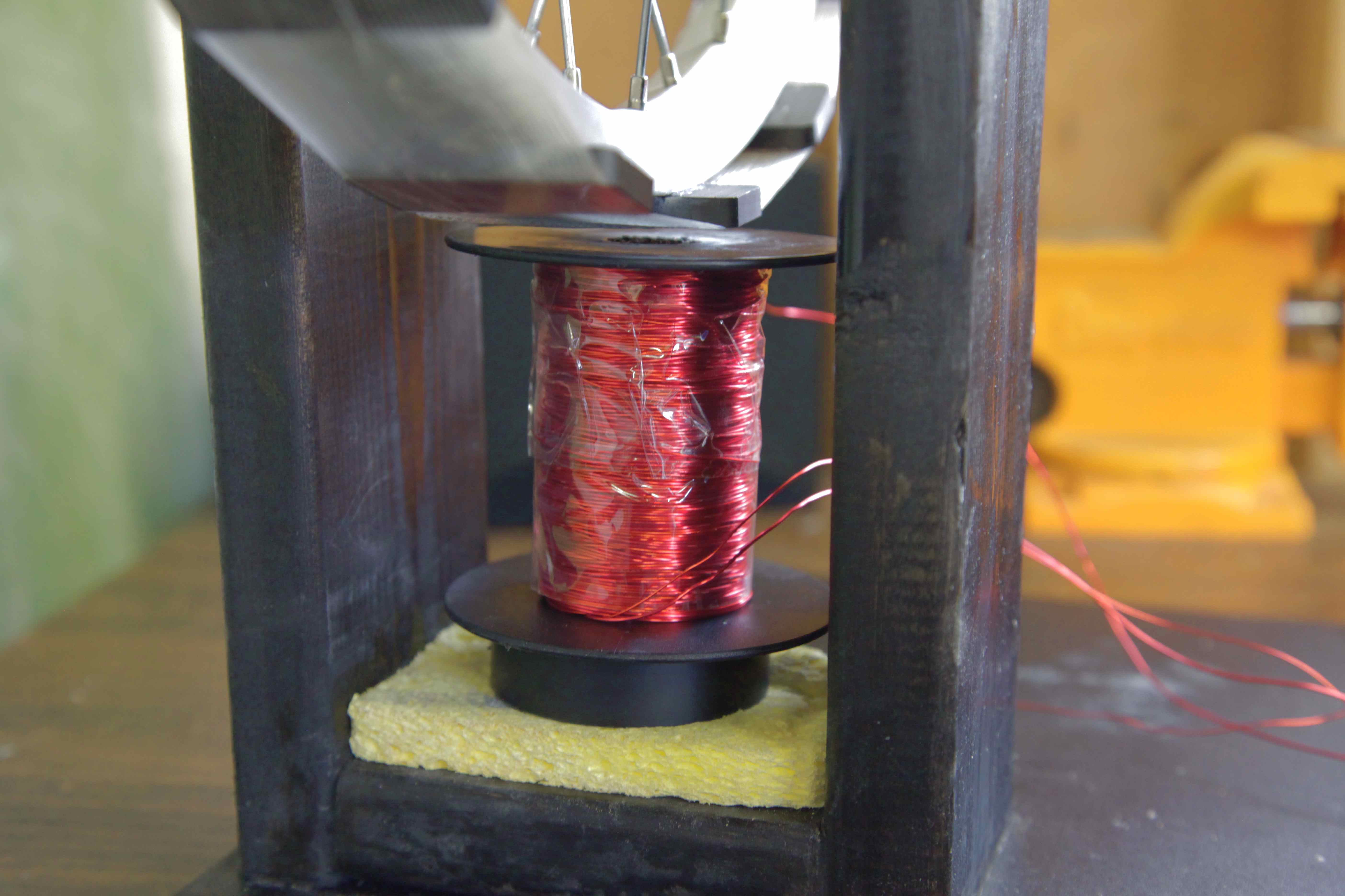

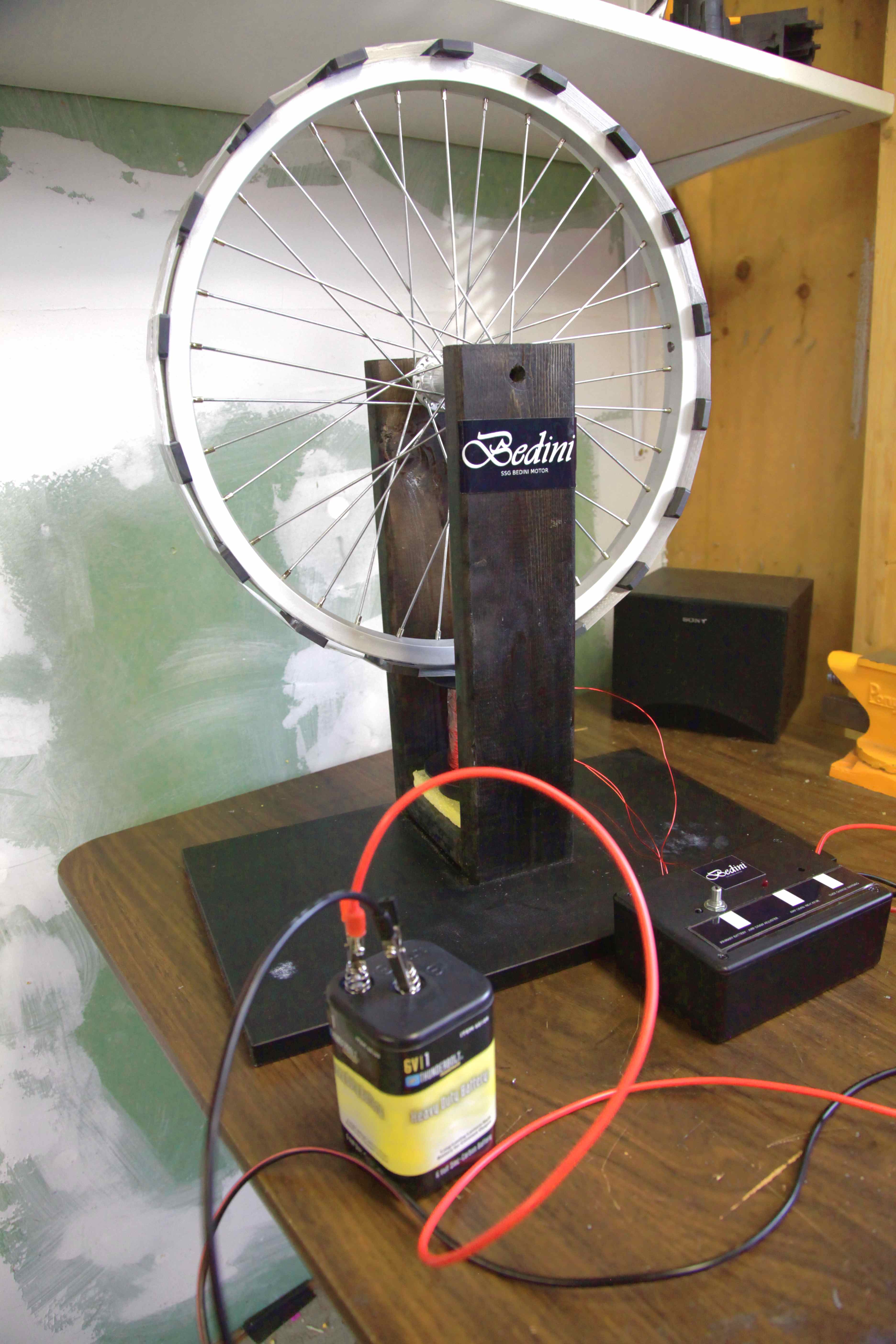

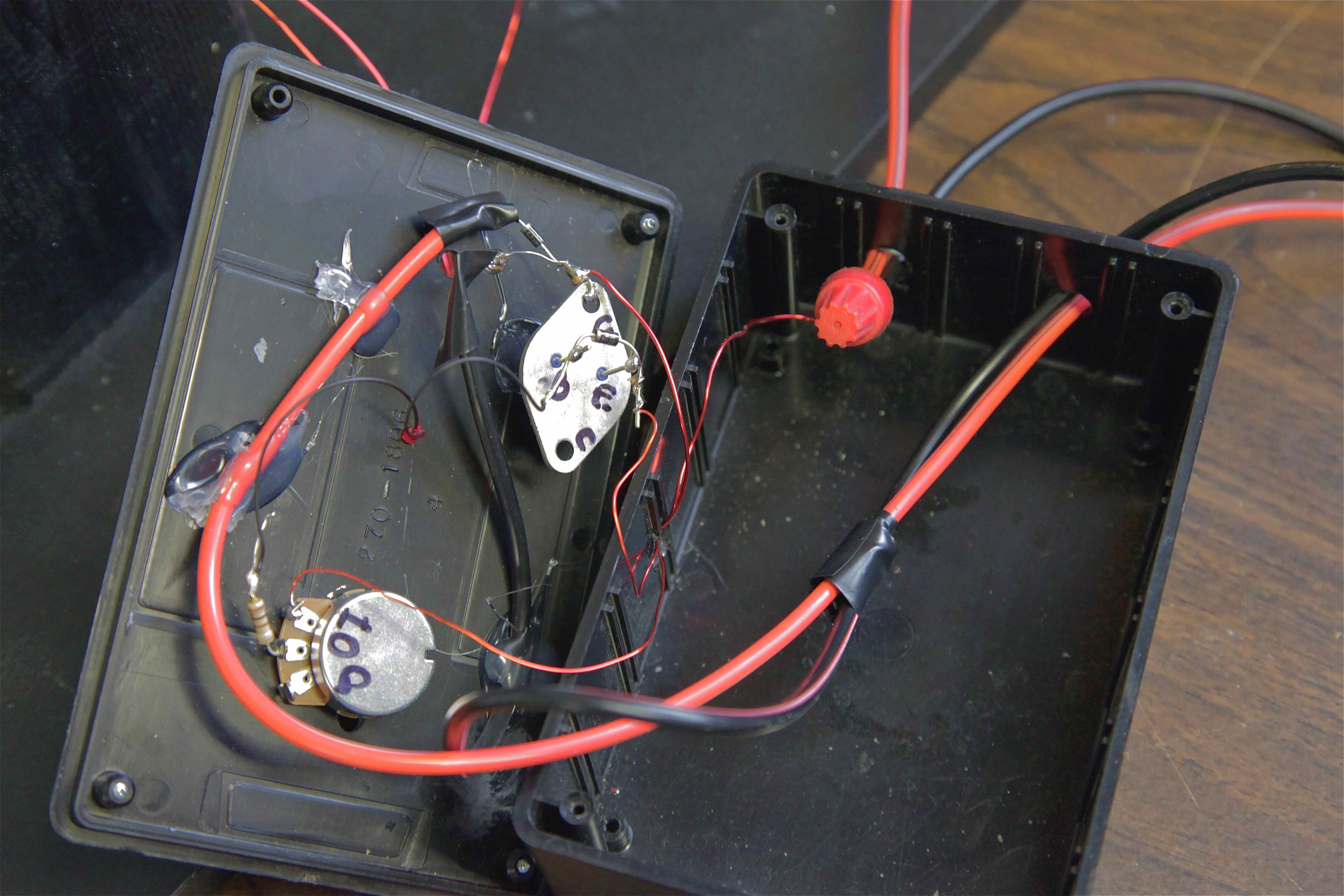

      Fantastic! That would be awesome. I can forward you my contact info. Here's some pics of my motor:

        Paul Fraser have you the magnet wire the same size ?

          Please do the following:
          1) Twist the strands, start with 6 strands (5 power and 1 trigger)
          2) I guess you are using 2N3055..its good to start with. But better is MJL201194
            Paul, is that an LED I see between the pot and the base of the transistor? If so, you need to remove it.
            A bifilar coil with one transistor is fine - you can go to multi-strand coils later on. 2N3055 will also work fine for your setup.
            What gauge is your trigger winding? It looks a little bit too thick, so you may have to give the wheel a decent spin by hand to get the transistor to trigger.
            Also, the machine is designed to run on a 12V battery, not a 6V lantern battery.
