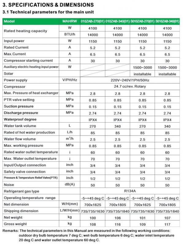

The specs are below, basically it's 1150W, Rated current 5.2A, Max current 6.5A, Compressor starting current 30A
