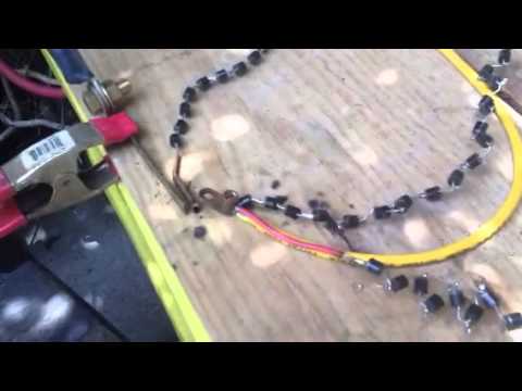

        • Diodes gone bad.
          After driving with plasma ignition on my Land Cruiser for about 5 months, the diode string to cylinder 5 and 6 went bad.
          I used 25 diodes, 6a10.
          Now I am ready for something more simple, like just one diode per cylinder instead of 25!

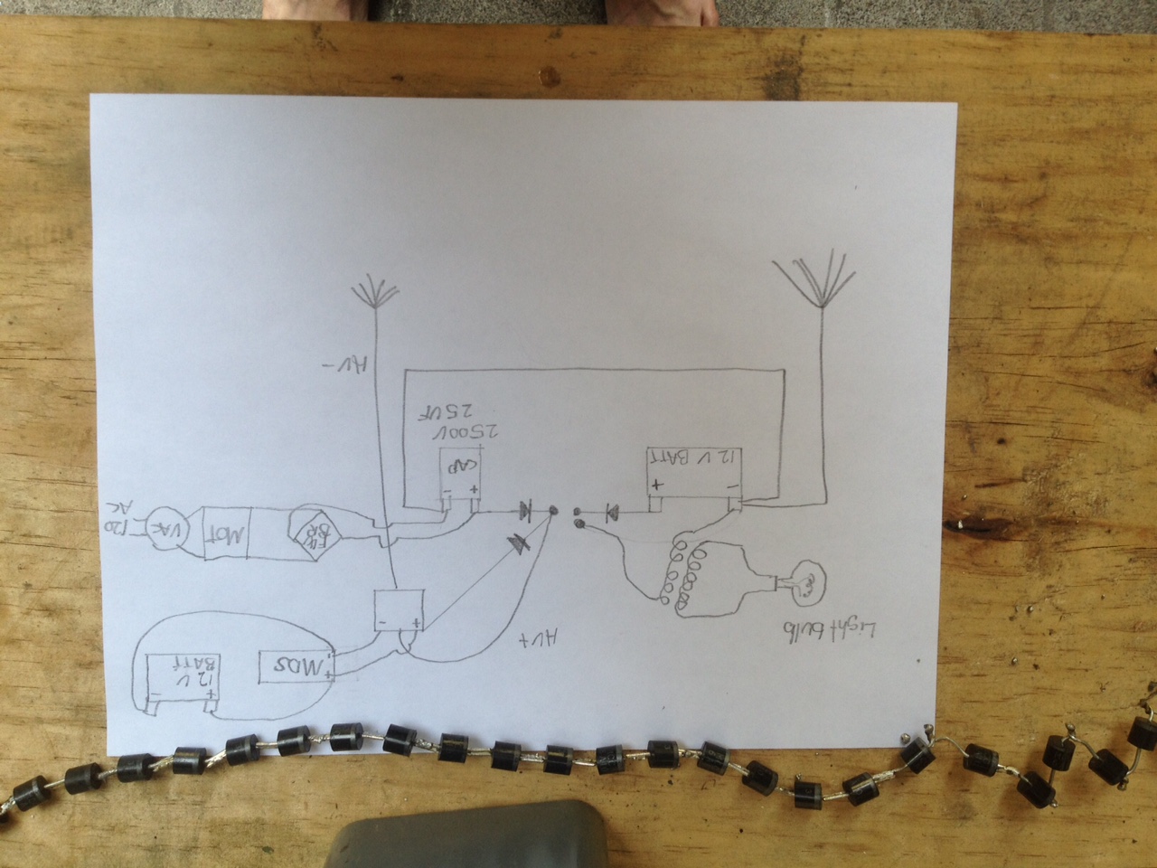

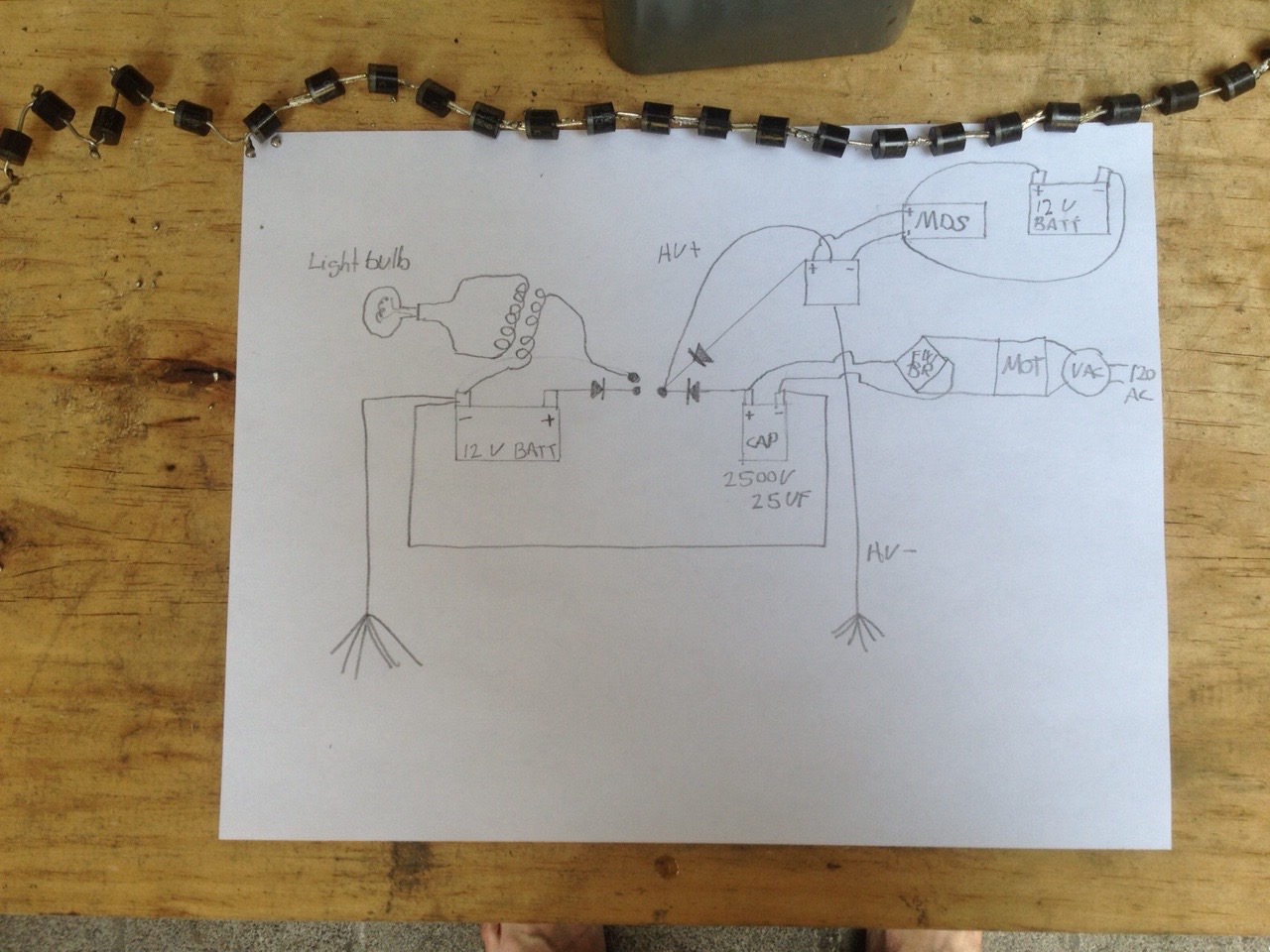

                          • Here is the circuit.
                            The filament is still working, but it does not take much to break it!
                            The coil I was using was a 23 # wire wrapped around a 2 inch pvc pipe, on top of that I used 6filiar litzed 23# wire. Just a coil from an old experiment.

                            • Originally posted by ThankyouBedini View Post
                              Thank you - makes sense.
                              I doubt your 12v battery is jumping the gap or contributing - it is just there to give the HV a place to go initially before the diode shuts off and the discharge is forced through the primary coil. So if you had 24v in batteries there instead of 12v, it probably wouldn't make much difference. However, I hope you can demonstrate that you can get a battery to jump there gap through an inductor.
                              “You never change things by fighting the existing reality. To change something, build a new model that makes the existing model obsolete.” ― Richard Buckminster Fuller

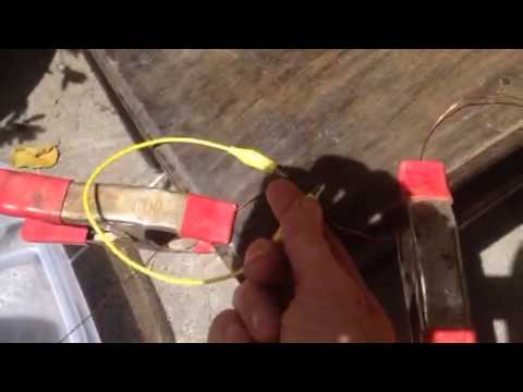

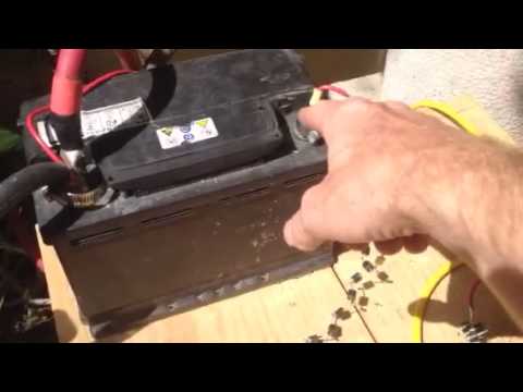

                              • Here is a video to demonstrate that by pulsing the positive post on the 12 volt battery the bang gets way louder.
                                How it would work with a 24 volt battery I will find out later...
                                Since this method gives the best bang, I strongly feel that somebody should try it in an engine to explode some water vapor....
