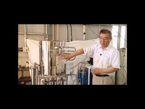

                  Do you have a link to the Sosie water?
                  It is easy to go to 50% water/diesel mix but it requires a certain additive. It goes go way higher, but the stability isn't that long - 50% can hold a very long time. The plasma also has benefits for diesel. The plasma is so strong it can run a gasoline engine with diesel fuel - that shows how much energy is released. If I had the time or inclination, I'd modify a diesel gen set with a spark plug port to have the plasma work in synchrony with the compression.
                  • Oops, I spelled Sosei wrong... Here's a link.
