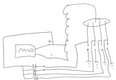

Hi Ron,
As you said, theoretically it should work!
I still have a few questions though.
#1 - Did you splice the negative coil wire from the igniter and MSD white wire together inside the distributor or outside of the distributor? (Where is the splice located?)
#2 - Which MSD wire did you splice to the other coil wire coming from the igniter and where is this splice physically located?
#3 - Do you still have a condenser fastened to the positive coil wire coming from the igniter that the other MSD wire is spliced to?
I'm wondering about Radio Frequency Interference to either the igniter, or the MSD module, or between the two (or maybe even the magnetic pickup and computer and wiring). Fastening a wire to the T-junction may cause it to become an antenna with nothing else attached.
#4 - Did you fasten the High Voltage Diode up to both the T-junction and coil positive at the same time to check for plasma? Or did you only try running the engine with the diode completely removed? (Wondering about RFI from an open antenna effect.)
