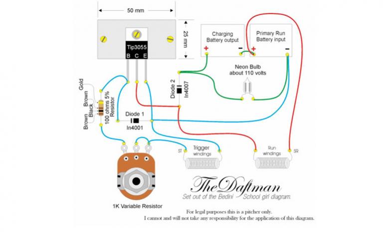

          It's this:
          18 magnets
          22" bike wheel
          850 turns bifilar coils
ID:	46108Click image for larger version

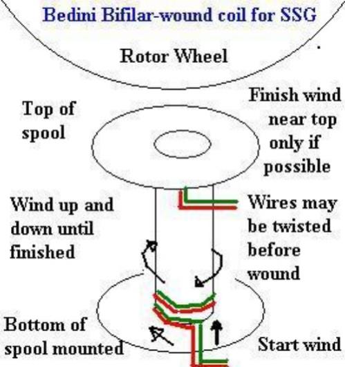

            Hey Marine.
            850 turns - you do not know about your coil length ?
            + put your transistor models, resistor values, missing....
            + I see your coil is wound clockwise from bottom to up. that should be the counterclockwise (ie from a repulsion to a attraction mode)
              Originally posted by Bung-ee View Post
              Hey Marine.
              all the parts are in the first picture. I'm not sure i'm following you??
              My coil is the same as in the pic. I just did what Bedini has asked.
              Coil length is aprox 3.5 inches
                Yes ok but I'm not going to study your pictures ah ah !
                just put the list you have here...what you have.
                for the coil : how many strands do you have, what diameter, what length of wire ? (I have performance pbs with 100 ft for instance).

                    Hi Faraday.
                    I'm using 4.5ah SLA batteries.
                    I've just made my coil a trifilar by just adding another main coil to my bifilar. I didn't un ravel it all, i just added it on to. That's ok right?
