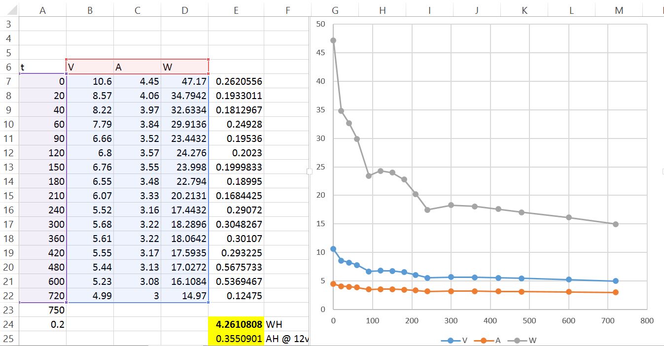

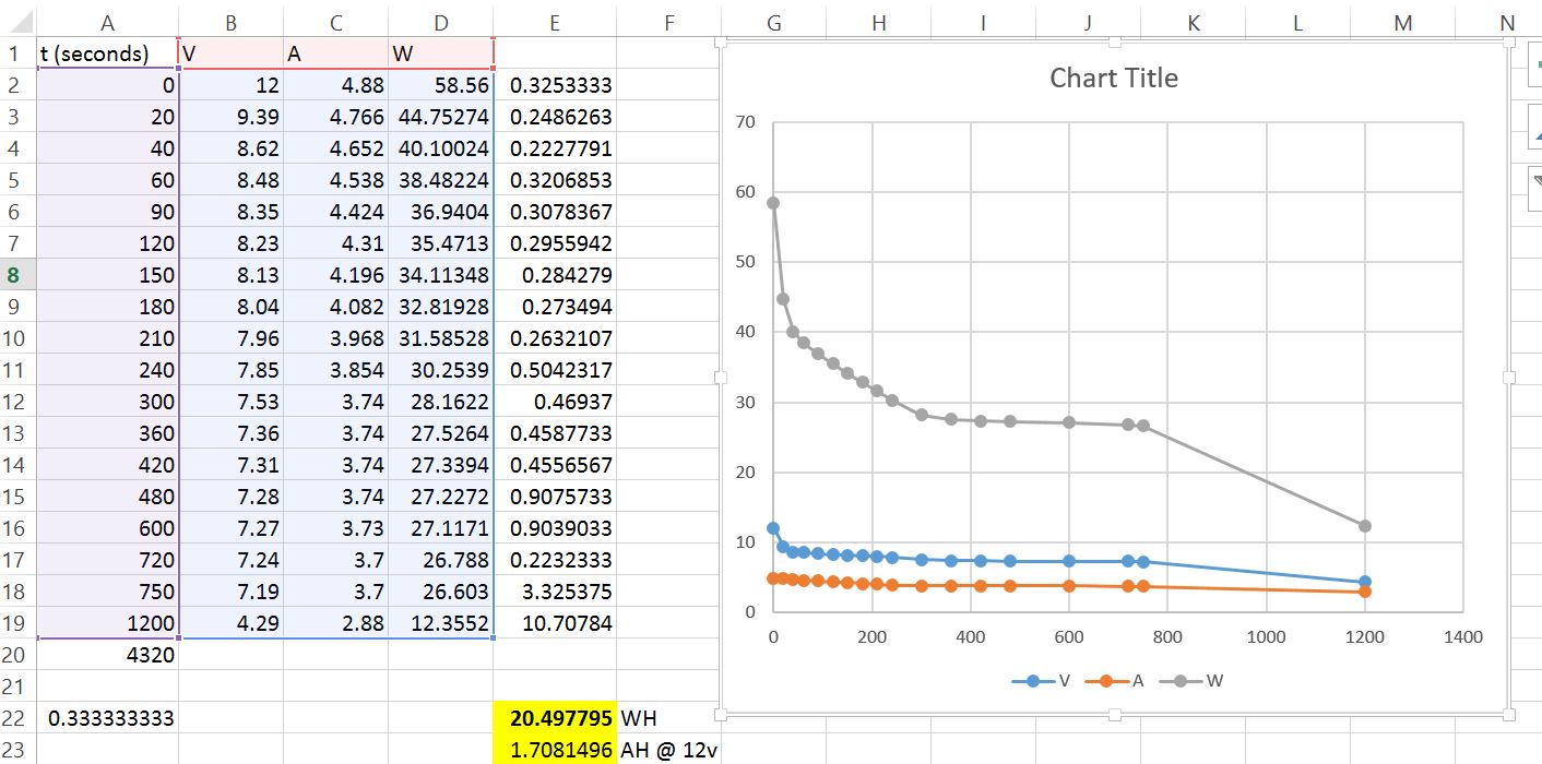

                            So I looked all over the internet but couldnt find any conclusive or data based results on the capacity of an alum battery before and after conversion so I thought ill take up the task myself. Despite the fact that the testing wasnt carried out "perfectly" but was close enough (some data points were interpolated, however it was done in such a manner that if anything the result of capacity for the alum battery would be understated) - the results are quite encouraging. I am sharing the excel file with all the data and the manipulation that I have done with it... feel free to play around with it and make up your own mind... and please share with others who are trying to get the data before going through an actual conversion.Click image for larger version
ID:	47160Click image for larger version
Name:	alum battery 2nd charge.JPG
