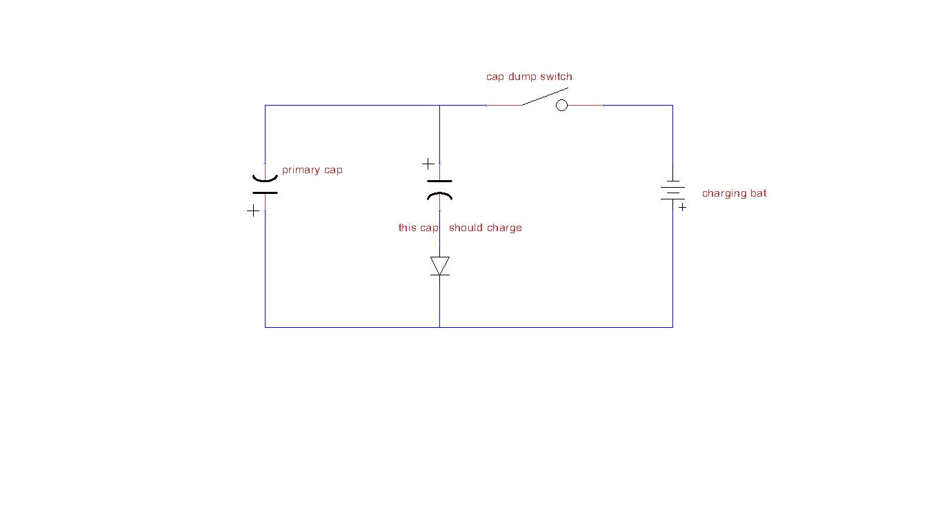

                            I must have something connected wrong, can you show me what I need to change or do a quick drawing of your own?
                            Thanks - Patrick
                              Thanks - Patrick

                              Hi Patrick,
                              The switch is in the wrong place, when does the primary cap ever discharge the switch is only between it and the battery, the primary cap needs to vent its energy out to another low voltage battery or be shorted or what not. So the cap dump switch needs to be between the + and - of the primary cap not where it is now. It won't work with the set-up from the diagram. I'll be curious to know how it works with a battery instead of pick-up coil charging the cap, I suppose that could be a problem, you will be shorting the bat at the same time as the cap but I think you will see the effect if you move the switch.
                              If you take a look at the two vids I posted on page 4 Radiant from Cap 1 and 2, they detail my set-up. Good luck.
