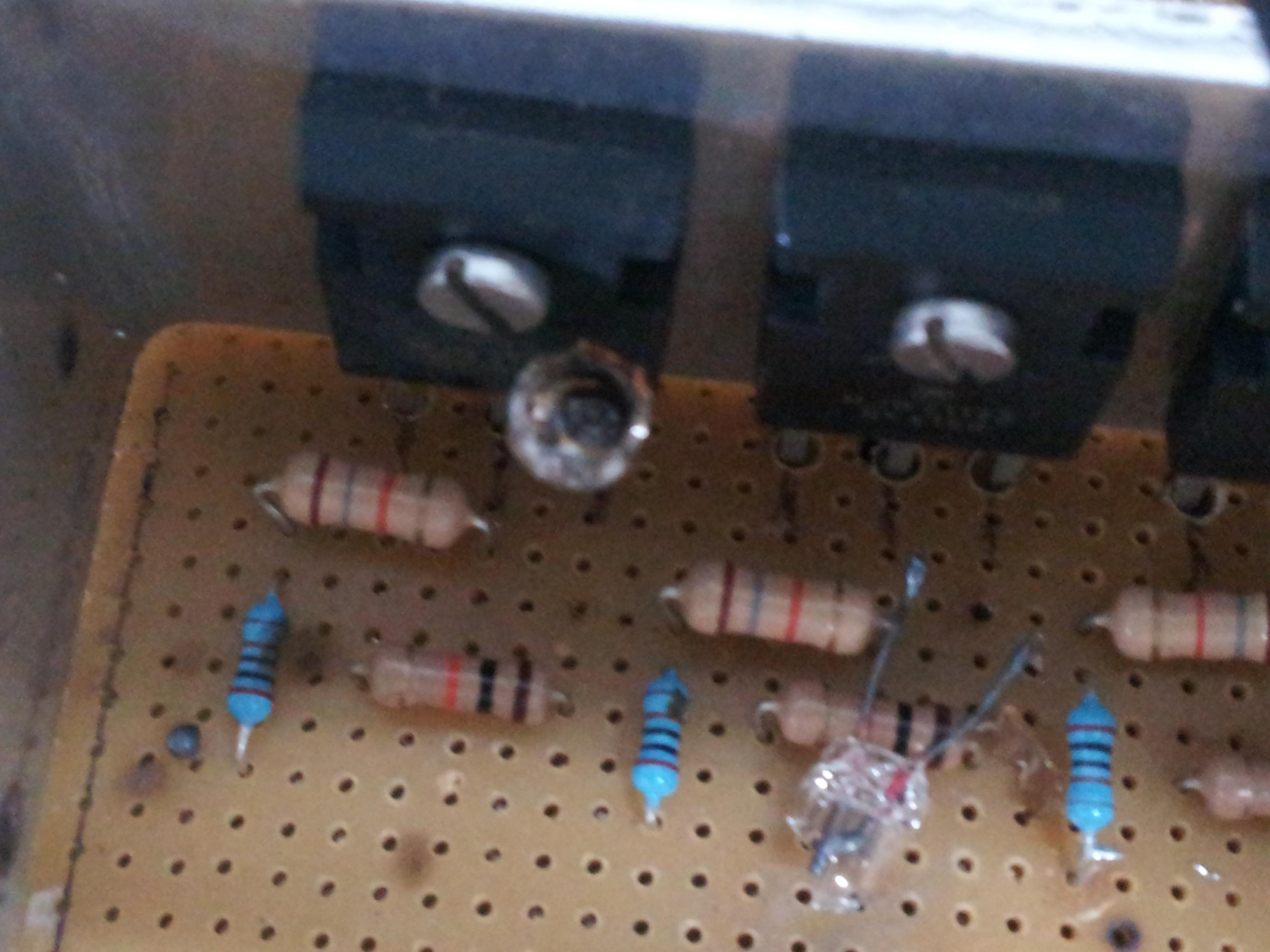

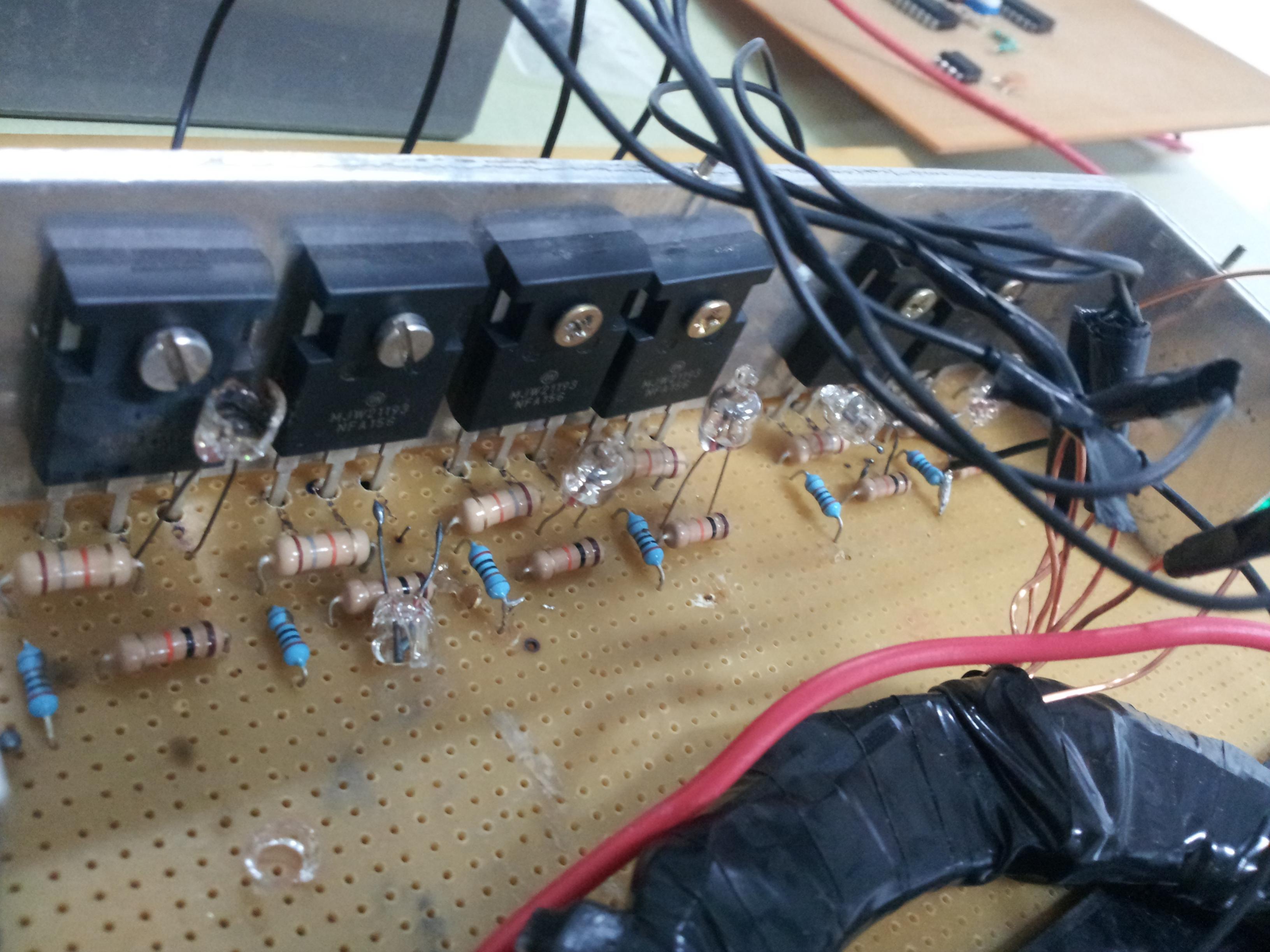

I again had the mishap today with the Solid-state SSG running and the wire lead at the Charging side accidentally opened up.... had Ball-Lightning popping all over the board...what is interesting is that the devices are consistently protected by such 'blow-up' and instead of just glowing which it is normally does.. the bulbs are blown into smithereens...i never had to replace even a single transistor or Diode in this set up.. i think i just understood how to save the Neons as well....more as i try out..

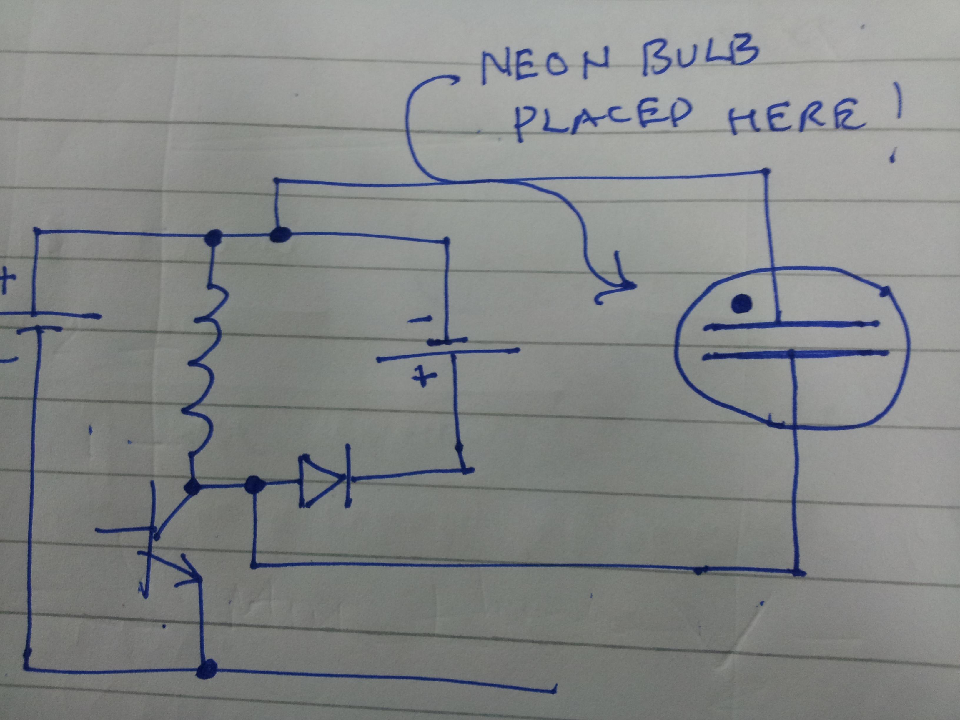

Here it is the solution to protect all of them......

I guess Diode 54 is the Reverse biased Diode between the emitter and base which is used to avoid spurious Oscillations (especially when it is Rotor Triggered SSG mode operated)..while the diode 56 is the equivalent to the normal Neon Bulb in the same location (between collect and Emitter) but with the difference that Neon Bulb would be more reliable than a solid-state diode cause neon bulb is a kind of 'self healing' to the spikes unlike the Diode ...and yes it must be a TVS or a hyper fast recovery Diode for the purpose...
what i showed in the diagram is a solution to avoid 'explosion of Neon bulb while at the same time, save all the other devices reliably..now just an experiment for you to try out.... connect a TVS/ Hyper Fast recovery Diode (the one across Collector/ Emitter) like shown in the patent and connect in parallel to this a Neon Bulb...excite this on SSG.....ummm Neon shall not glow.. but that doesn't mean the bulb is not at stress at all..actually speaking the very presence of Neon bulb evokes additional stress across the TVS and the bulb itself..yes it may breakdown well before its rated tolerance...i leave it to you to explain this effect...while this may be off topic here but nevertheless vital to understand the Radiant Spike...
