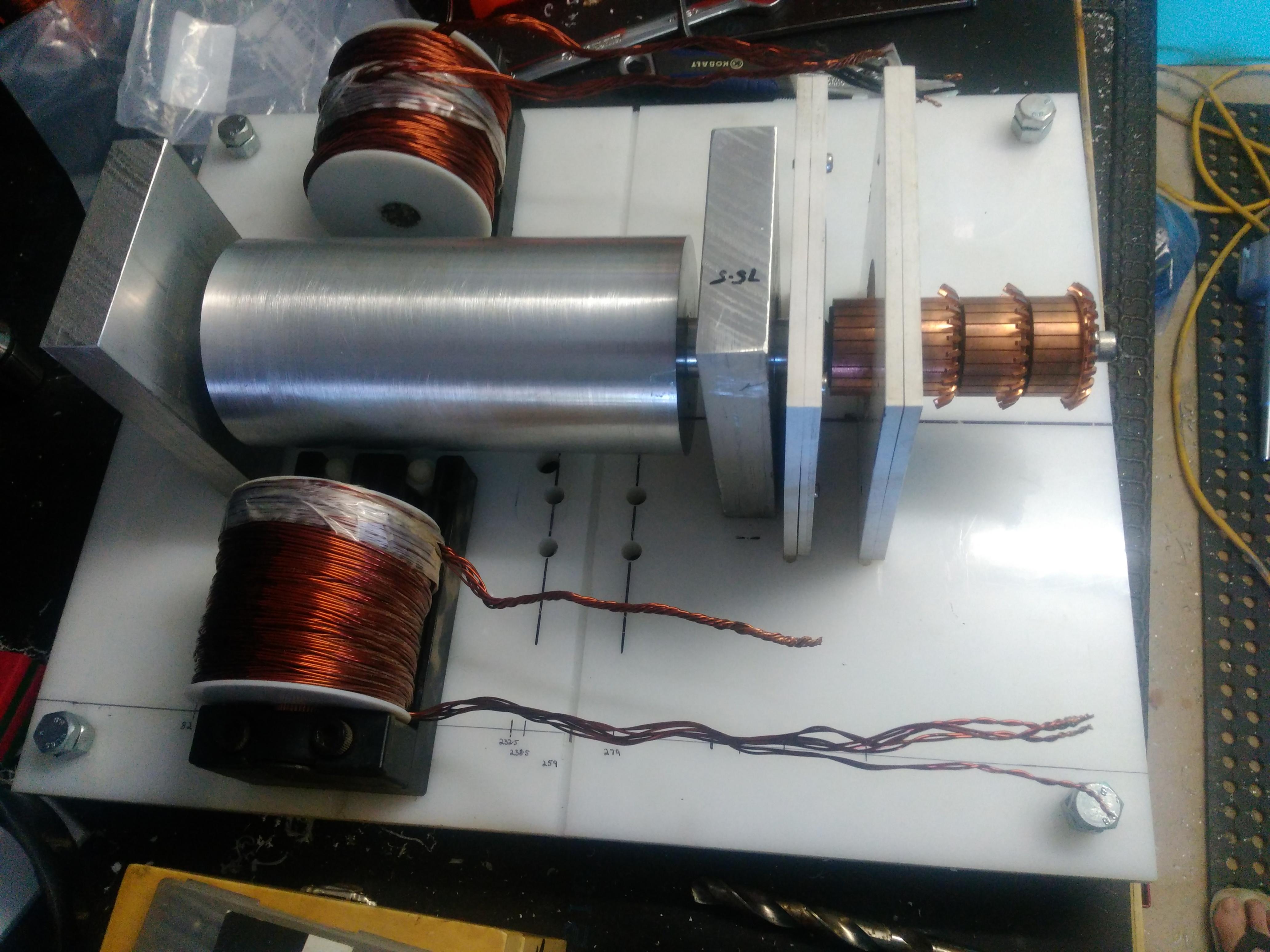

    I'm building it according to Bedini's old mechanical commutator drawings.
    While there are 24 segments on the commutator several of these will be soldered together to allow for maximum attraction time.
    More or less can be soldered to allow for tuning.
    The commutators themselves are held in place by an end nut which is variable too.
    The brushes will be mounted to 6mm PVC in a geared mount for tuning while running.
    "There is another type of controller I must make known, and it is the simplest of all. With three brushes and a commutator, you can do away with all the electronics and handle 100 times the power back to the battery. The simplest method would be a split commutator, of which a little less than 180 degrees would be copper. (see figure 12 Free Energy Generation.)"
    Allowing for two magnets in the commutator I will use a maximum of 12 segments per magnet.

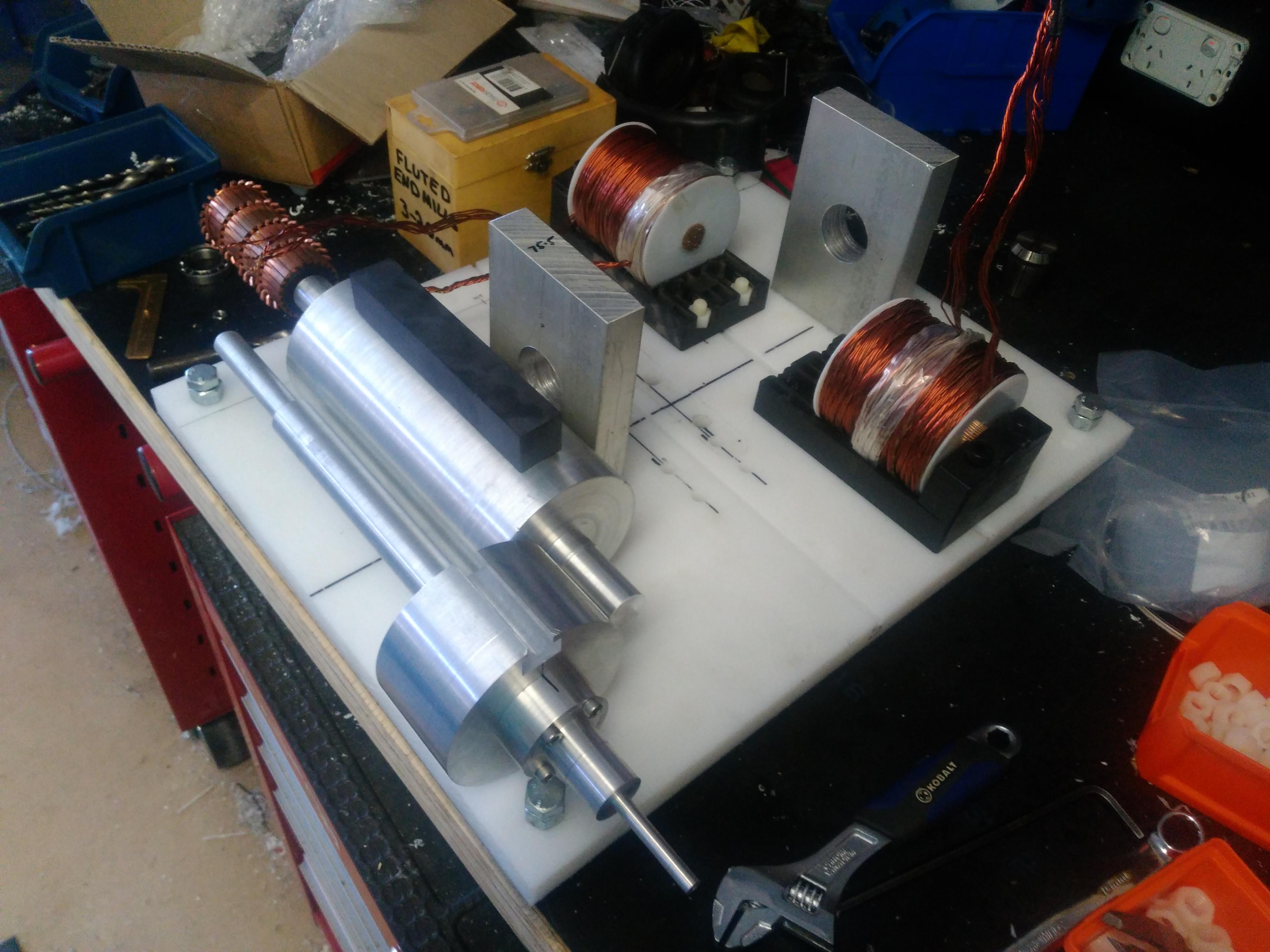

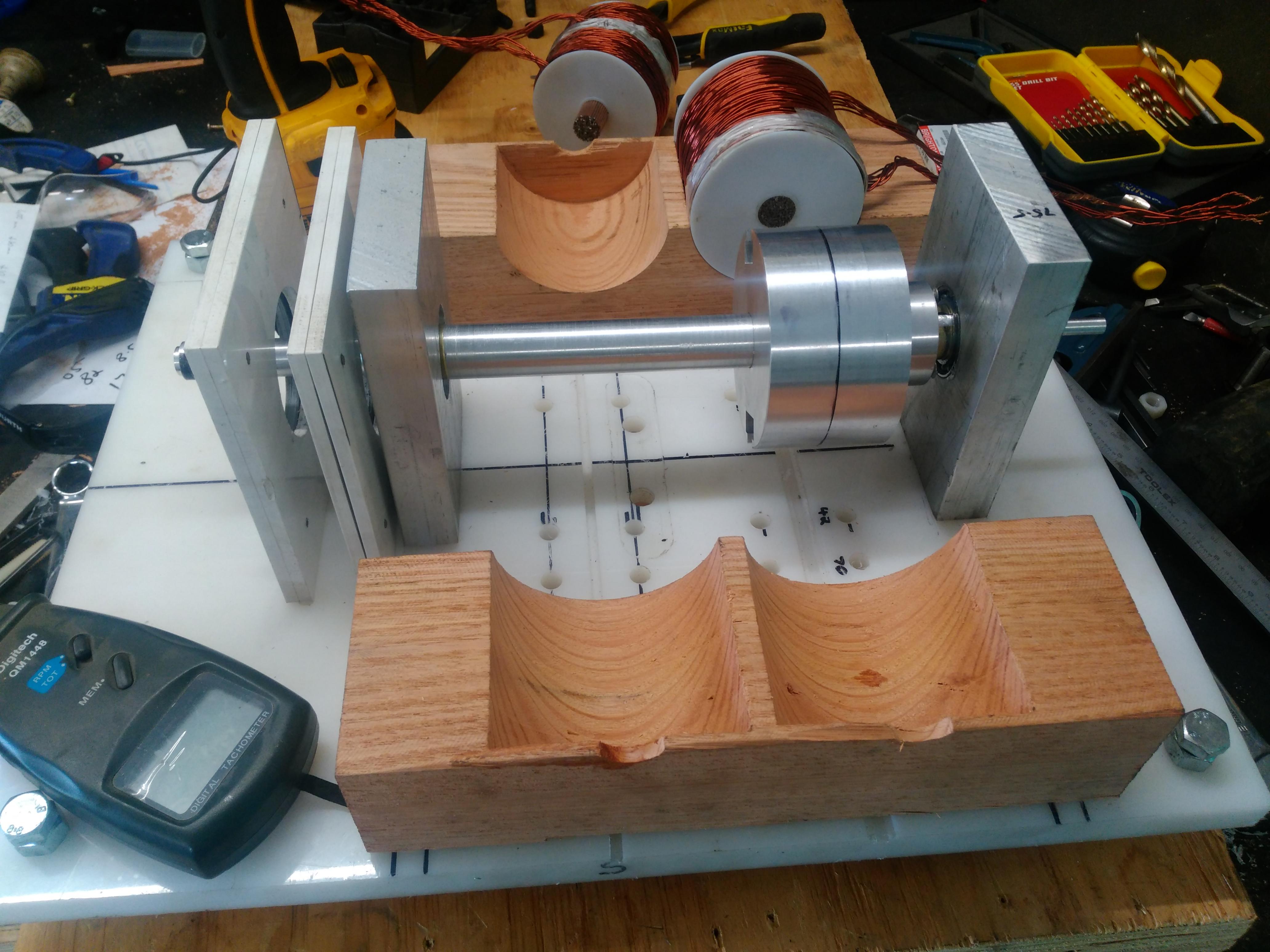

      2 X 18ga coils and coil holders milled into place. (10 coiler now becomes an 8 coiler, sorry john!)
      Nooo! Not the 10 coiler
      just kidding JD, all in the name of science mate

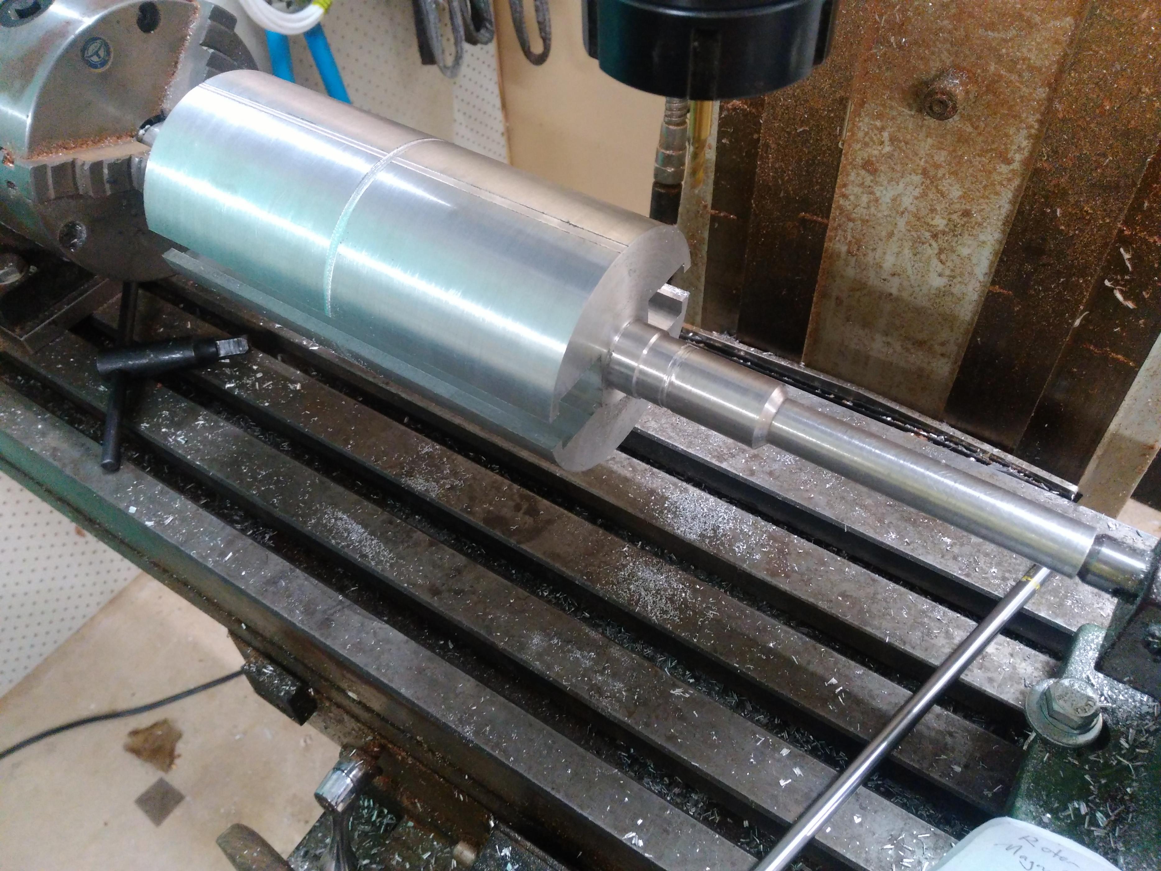

        New rotor machined from billet, ready for slotting larger and longer magnets. (4 of 25mm X 25mm X 150mm).
        Longer 17mm shaft to allow for 4 commutators if necessary.
        Bearings blocks moved to new locations.
        2 of 4 coils mounted.

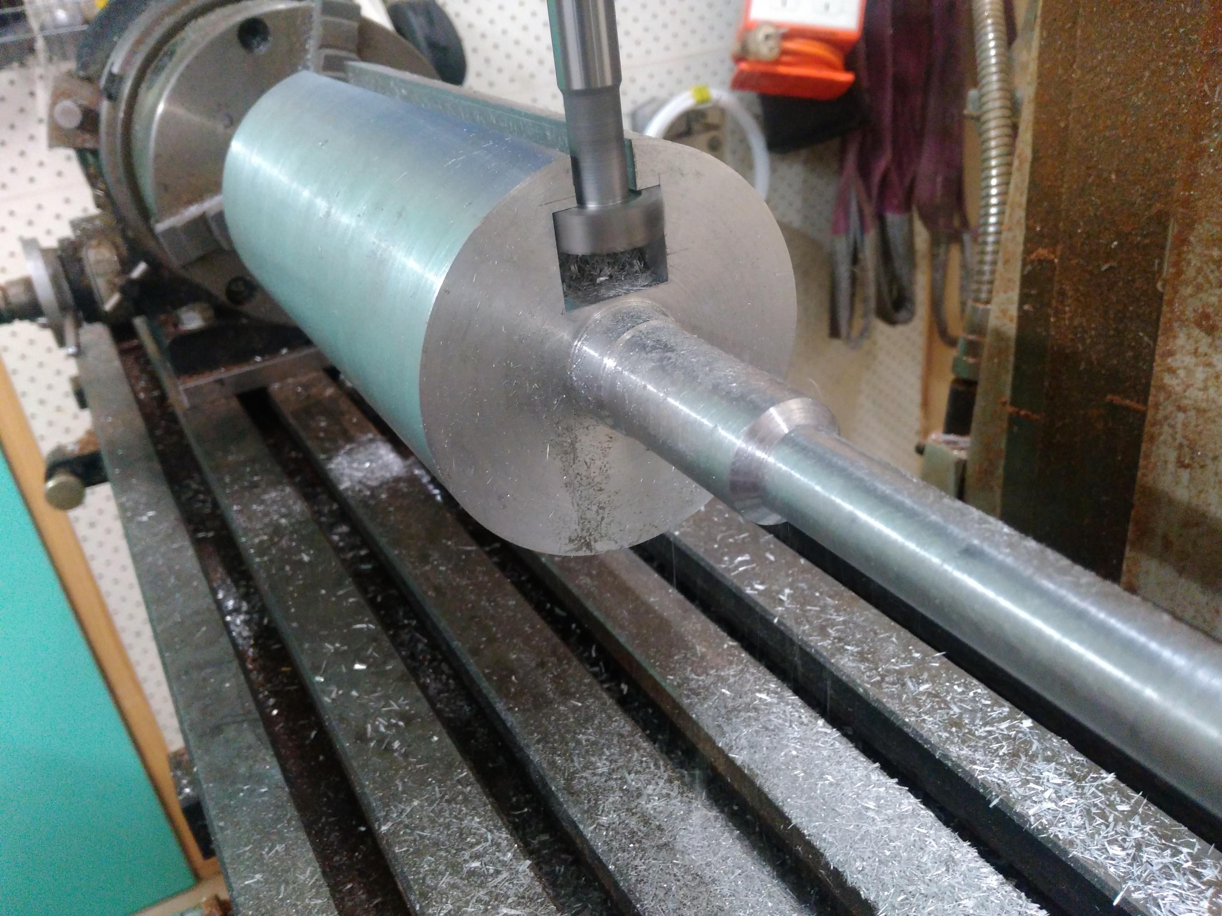

                        One side of the billet rotor is now slotted.
                        two 25 X 25 X 150mm ceramics waiting to be pushed in.

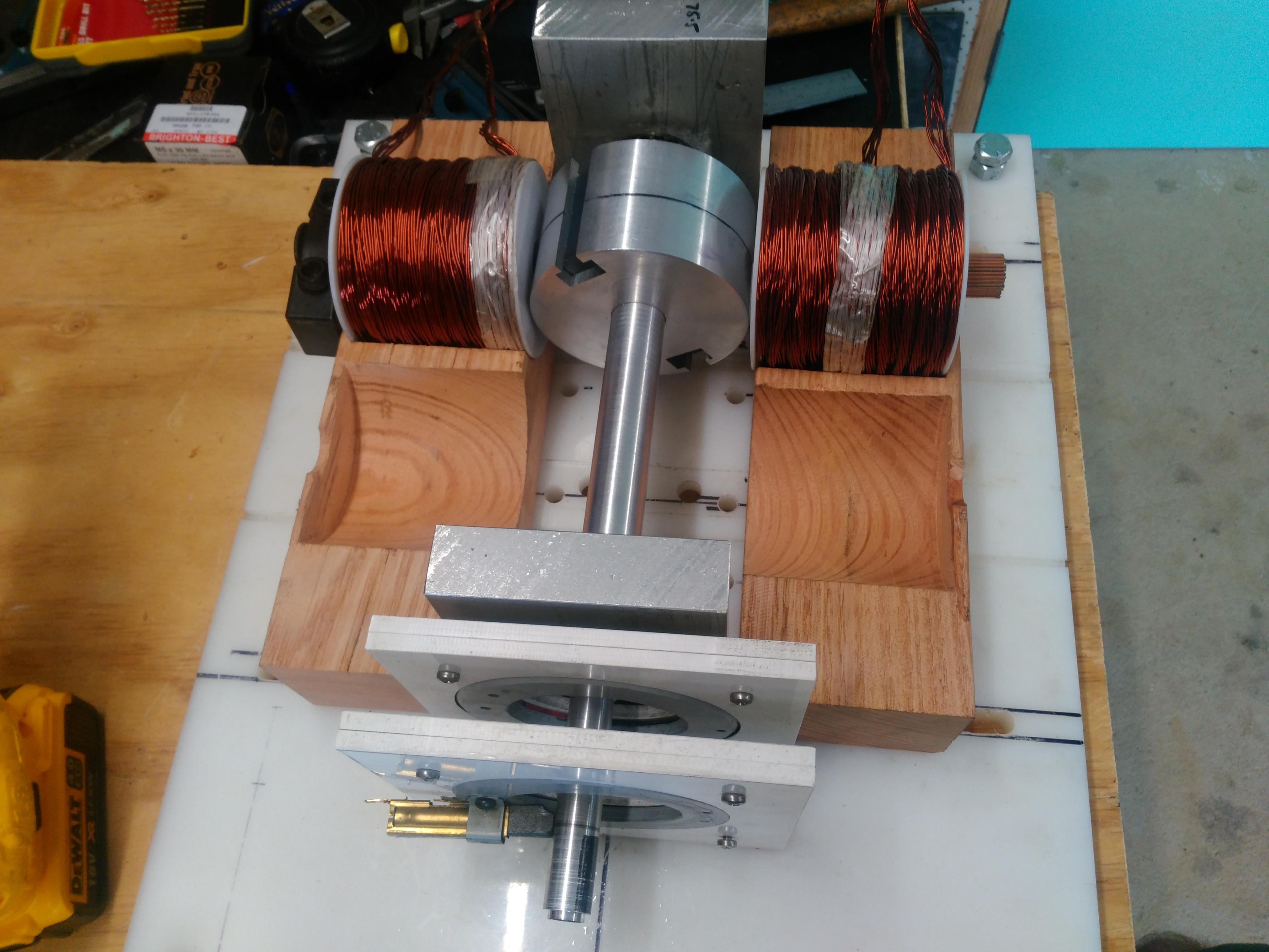

                            I couldn't find a gearing system for my commutator cards so they are finished.
                            The big rotor is about 3hours more work.
                            A bit of wiring and some hold downs for the coils maybe 20hrs to go?

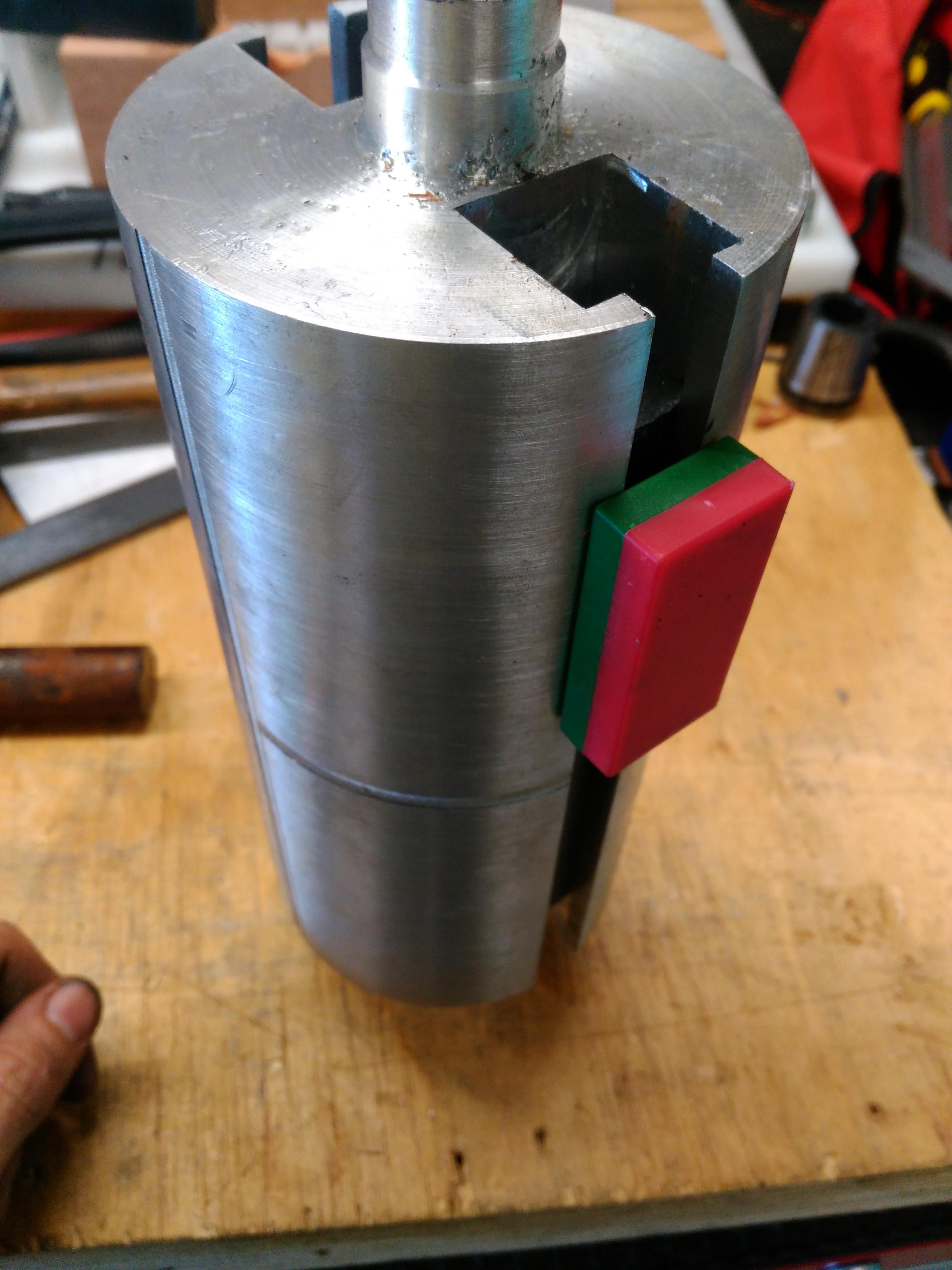

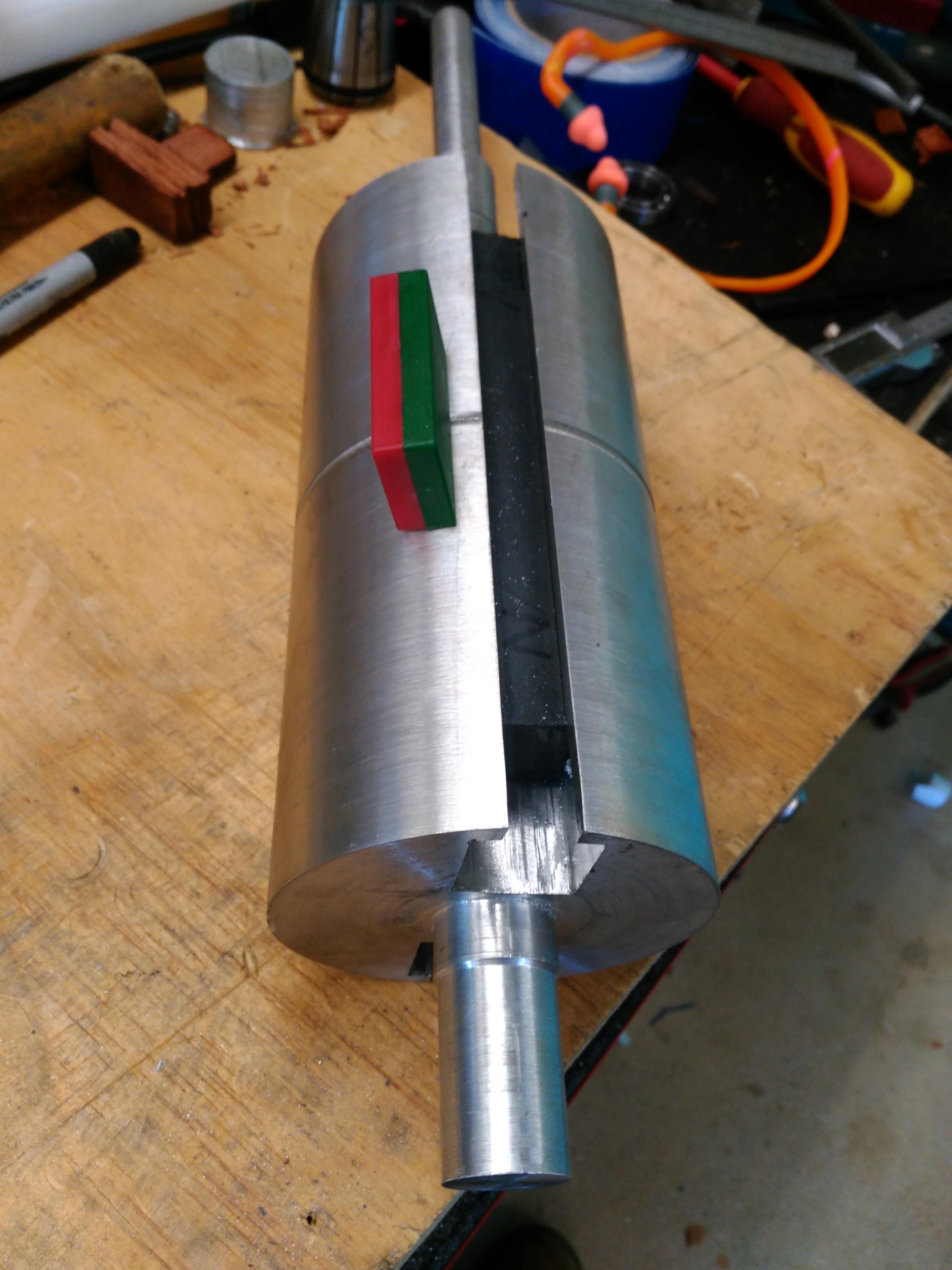

                              This bad boys out of the rotary table.
                              Tried to push the magnets in but its a bit tight.
                              need to shave .1mm off the sides.

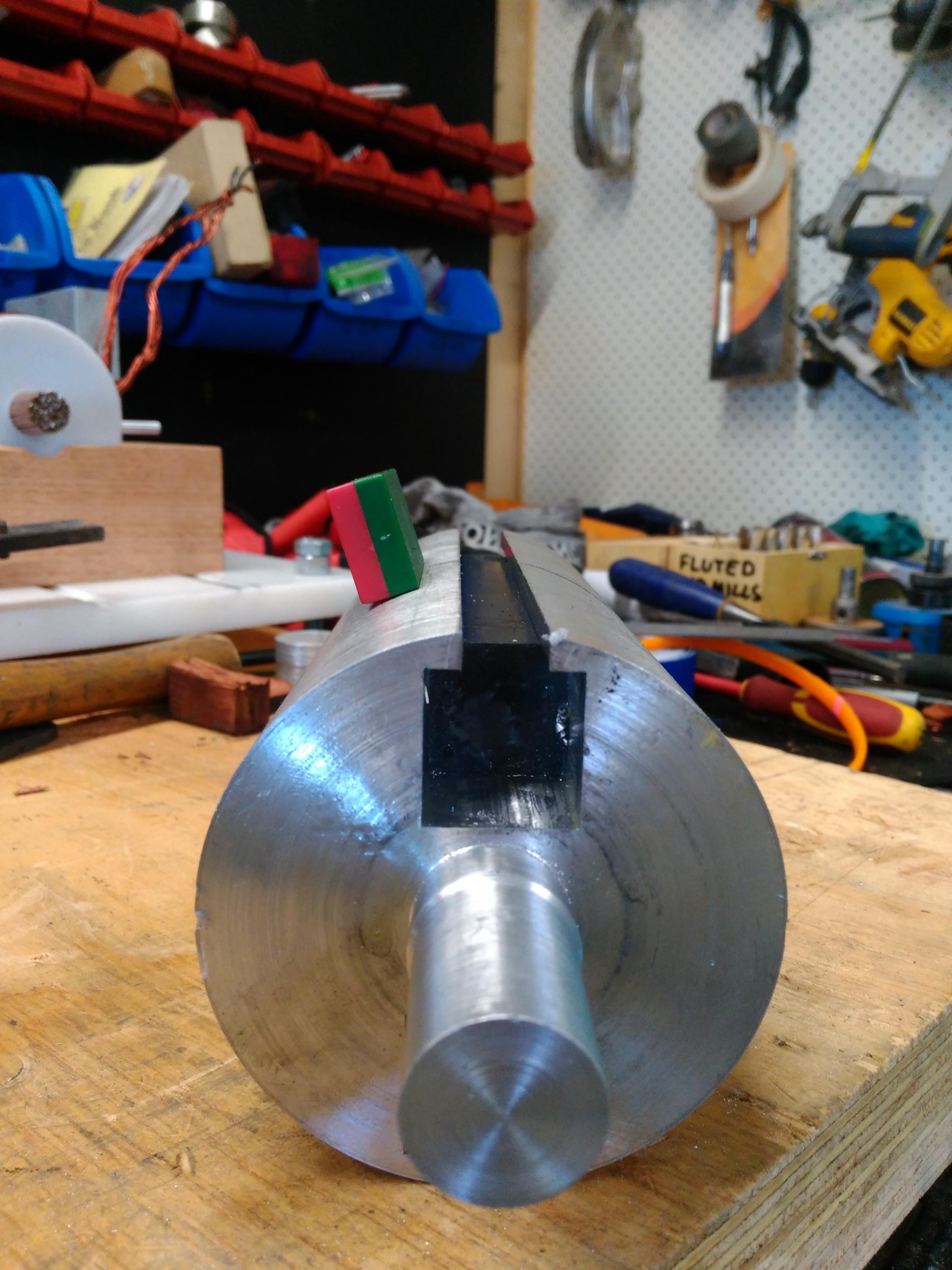

                                It turns out the slots were spot on, it was the magnets that were bent!
                                The magnets red side is north, peculiar to see where the magnet lines up.
