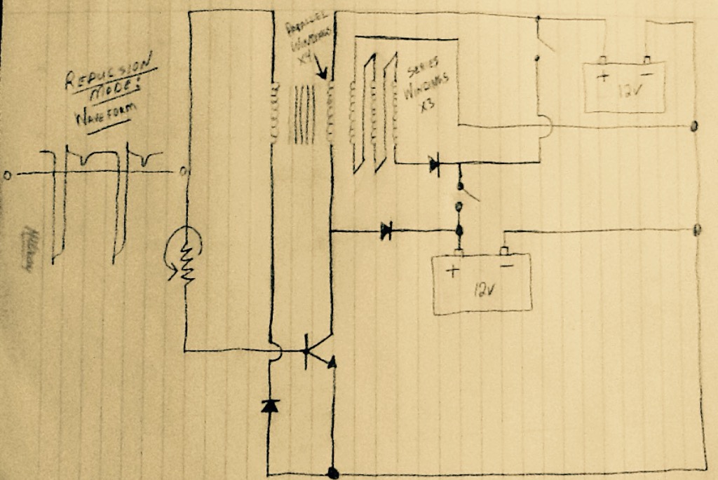

                  Here is a SSG drawing that I drew with the waveform also included, going negative. It can dump to the primary or the secondary. It still lost primary voltage when hooked up across the primary because I needed more coil surface area, I have not had time to do so.
                      Aaron I am not coming at you... Hope you are not thinking that... I am of course still learning just like anyone and I do not have all the answers by any means. Often I can become confused and always welcome the chance to reason out until truth prevails. So are any of these things I brought up in this post to be a move in the right direction?

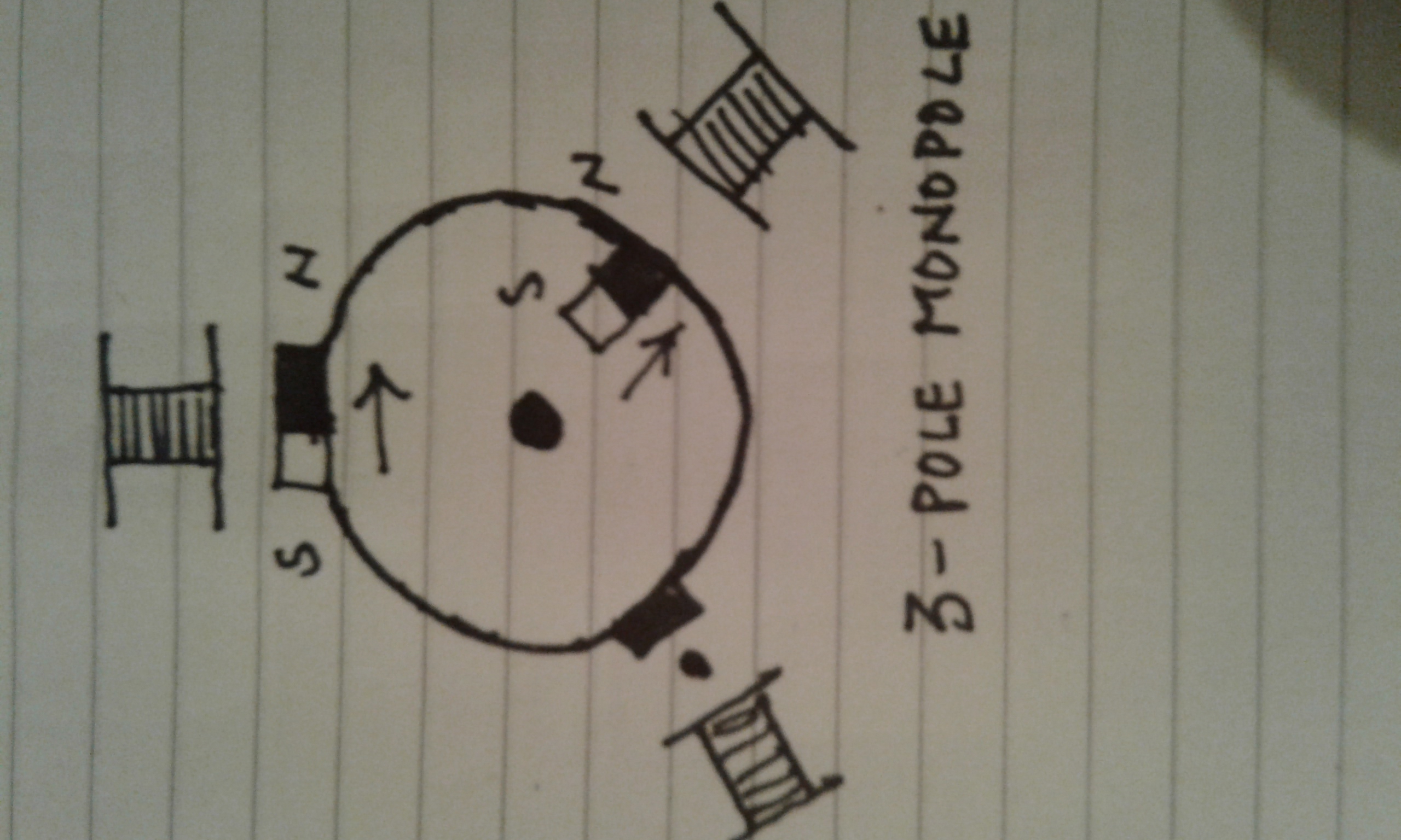

                      Hi Dave,
                      In my previous post i did mention it to Aaron that the N-face of the Magnet towards the coil core is the Natural Geometry for the Magnet's movement towards it and not at 90 degree, hence you flipp the Magnet at 90 degree (twice mutually) to fit for the direction for this Geometry.. does this not teach us what is it that we are doing ??? if you could make the magnet move inwards towards the coil inside i think that is all what we need!! but as i said it posses an Engineering challange but it can be done..! (btw this what is depcited in Stanley Meyer's EPG Magnetic circuit also!!), before we even get any further it has to be well borne in mind that the Bedini SSG/SG is an Accelerator machine which picks up speed with time (like a typical Particle Accelerator)and speed increase with time is the Energy gain! ofcourse the speed stabilizes at a point (since we have have scaled it to that level) the Radiant gain in the Battery is the Corresponding Electrical Equivalent of this ''Increase'' in the Speed of the machine.
                      The Natural Geometry posses another challenge in that the Increase in speed translates an orbital shift (imagine a Cyclotron) which makes the Magent confinement more difficult, hence John Bedini came up with this alternative arrangement to have the 'Rotor geometry constant, while have the Magneto-Interaction Dynamic by way of altered Magnetic Structure (Geometry)
                      Here it is again for all.Click image for larger version
                        Hi Dave,
                        I don't think you're coming at me - not in the slightest bit and I welcome all of it. There are however various clarifications that I think need to be addressed and defined because as you said, we need to be on the same page. I also don't have all the answers anyway as I stated in my first post and want to get the conversation going. I do have some for sure things I'll continue to share that wasn't left go guesswork when John shared them with me.
                        When you say the solid state SSG and ZFM produce a negative spike - now are you talking about during power on or power off?

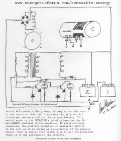

                        @Dave - you and everyone here probably already know this but this is the basic method that gave the best self running results I ever saw John achieve - or I should say that commutator method where caps were charged and then discharged to the front battery every 1/xth of the rotation - NOT this same circuit but with cap charger - large cap bank and mechanical switch:

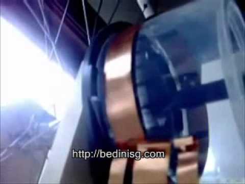

                          Here is a video of the commutator - serious Hollywood production here That was about 10 years ago but I posted it a couple years back on that account I think.
                          My results weren't that great because you can see my ultra low budget build, but John's kept the front battery up for very long times - may have even climbed - I don't know what the long term results were, but that is how he sent recovery back to the front. I don't recall if that was in the 2nd SG or any books or not. He did that at the "Palace" building he was in and was before Peter moved to Spokane so that must have been around 2001.
