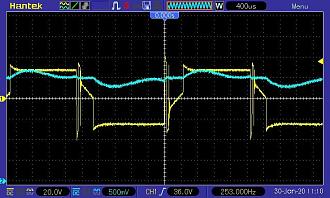

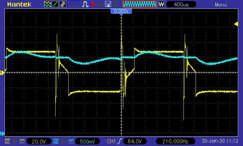

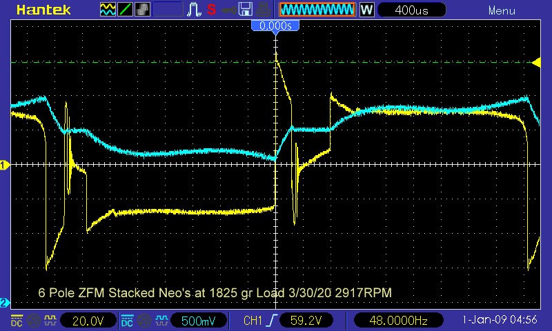

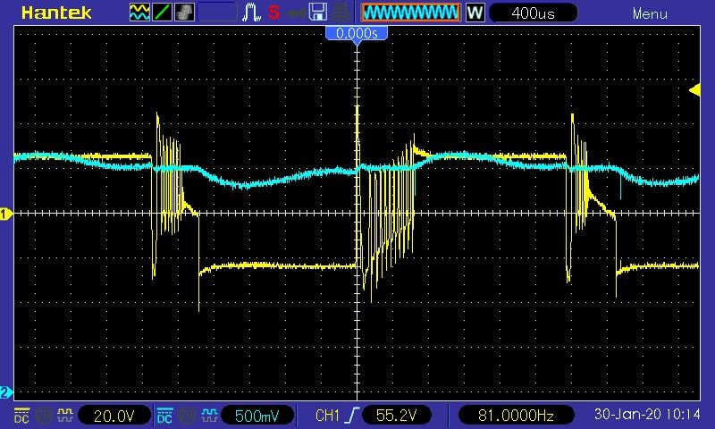

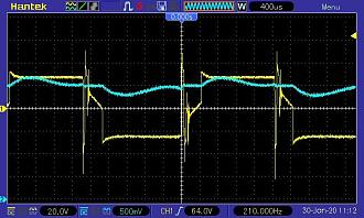

    Below is a sample of the data points for both options. The ZFM has slightly different characteristics between the two types of applied power - the LAB runs required a timing adjustment to compensate. The attached pics were all generated under no Load. Pic 2 demonstrates the oscope wave form for the LAB without the BEMF circuit, while Pic 3 with the BEMF circuit engaged. The Power supply mode with the BEMF circuit engaged is nearly identical to Pic 3 and not included.
    Parallel Mode with Power Supply no BEMF Circuit (Pic 1)
    4360 RPM 24.01v 0.60A 0gr Load
    3234 RPM 24.40v 1.46A 800gr Load 47.3% Eff
    2662 RPM 24.29v 2.12A 1350gr Load 44.5% Eff
    Parallel Mode with LAB and BEMF Circuit (Pic 2 and 3))
    4640 RPM 24.88v 0.65A 0gr Load
    3616 RPM 24.71v 1.52A 800gr Load 50.1% Eff
    2825 RPM 24.64v 2.22A 1400gr Load 47.1% Eff

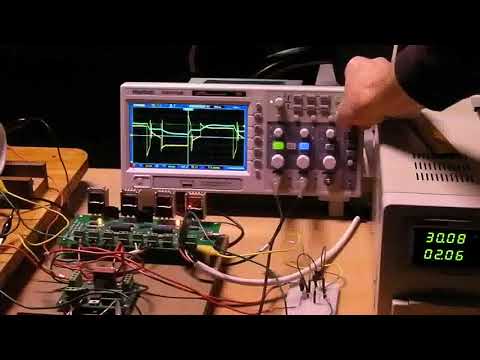

          4182 24.08 0.57 0 0.0
          3350 24.42 1.37 800 52.1
          2550 24.98 2.02 1400 46.1
          5186 30.18 0.69 0 0.0
          3343 30.03 2.03 1400 49.5
          6014 36.03 0.77 0 0.0
          4167 35.99 1.99 1400 52.7
          I may add some more info to this post later, but ready to move on...

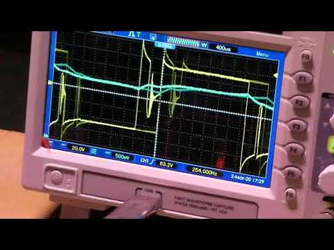

                ZFM Video 20.4 6 Pole
                So the next rotor configuration was designed to further explore the displaced magnetic poles of the coil. The static arc width of the individual coil poles was set to 560 by increasing the width of the Neo's to 0.75", unfortunately the Neo lengths and thicknesses available for this width are very limited. As a compromise the length was set at 1.5", a bit shorter than the rotor length of 2", with a coil to Neo gap of 0.130" +/-. Not ideal but useful nevertheless for exploring.
                So the coil arc dimension is 450 and the Neo's are separated by an arc of 600. So there remains a bit of play here that needs to be considered. That is the fun part and the most tedious to explore. For this config the overall length of the coil power on period is 490 taken directly from the screen shot. This value can be expanded or contracted a bit by the positioning of the reed mount with respect to the timing rotor face. The start of the power-on pulse (advance) can be controlled by rotating the reed mount cylinder.
                Since the coil's magnetic poles function in a simultaneous push/pull manner on the 6 pole rotor the coil magnetic pole arc value becomes very important. One can design for the static configuration, but does this hold true dynamic operation? Good question...
                Anyway, for the video the ZFM was operated at 48v to demonstrate the major point - BEMF value and its influence. By nature, adding more Neo's and coils for a given design will increase the BEMF. For this config the peak BEMF is typically ~15% higher than the input voltage at unloaded speeds. Reducing the number of rotor poles and motor coils will reduce the BEMF value for a given RPM. The reverse is true also.
                The load for the video was 1400 gr. yielding 25.5 watts or 18.8 ft lbs/sec of useful power at an efficiency of 46-47%.
                Changing the wiring from series to parallel mode at 24v yields nearly identical results.

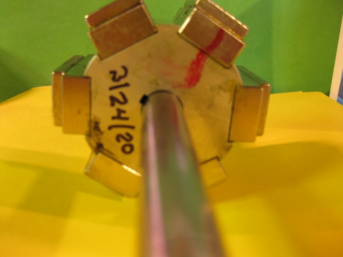

                  ZFM 6 Pole with Stacked Neo's
                  The testing program for this season has come to completion with the 6 Pole rotor outfitted with one set of six 2"x0.75"x0.375" Neo's stacked with 1.5"x0.75"x0.188" Neo's using the Loctite AA 326 magnet adhesive. The Neo's were first stacked and cured, then mounted very carefully on the rotor taking into account the nearly 80# pull force. Fortunately the Al rotor is non magnetic, however the adjoining magnets make this a somewhat tricky operation.
                  Click image for larger version  Name:	IMG_1698.JPG Views:	0 Size:	98.7 KB ID:	72786
                  The rotor was installed in the 3 coil ZFM assembly with the coil to Neo gap adjusted to 1/16" - tight. The ZFM was then tuned to the appropriate dwell and advance, then cranked up and tested both in serial and parallel mode. The longer length and greater magnetic pull force along with the tighter gap over the previous configuration did reduce the RPM, but improved the overall efficiency. The most reasonable configuration that yielded both output power and efficiency was in the 30 volt parallel mode. The virtual coil poles for this Neo arrangement were very similar to the prior posts coming in about 55 degrees - not ideal but close to. So lets take a look at the run data:

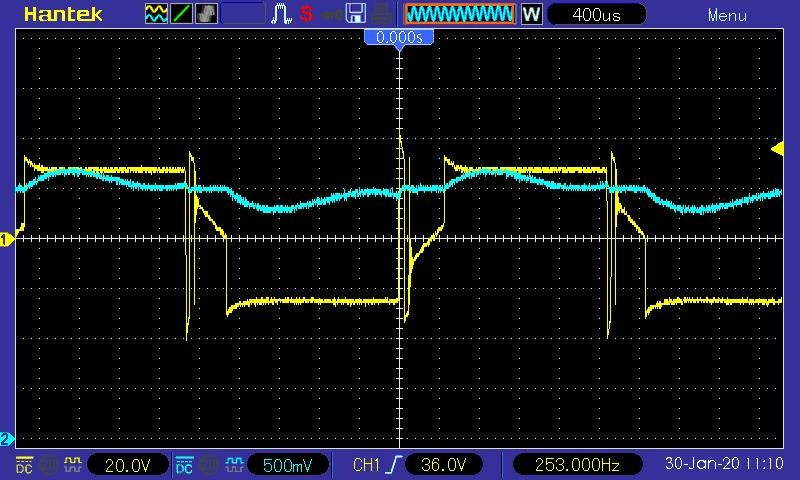

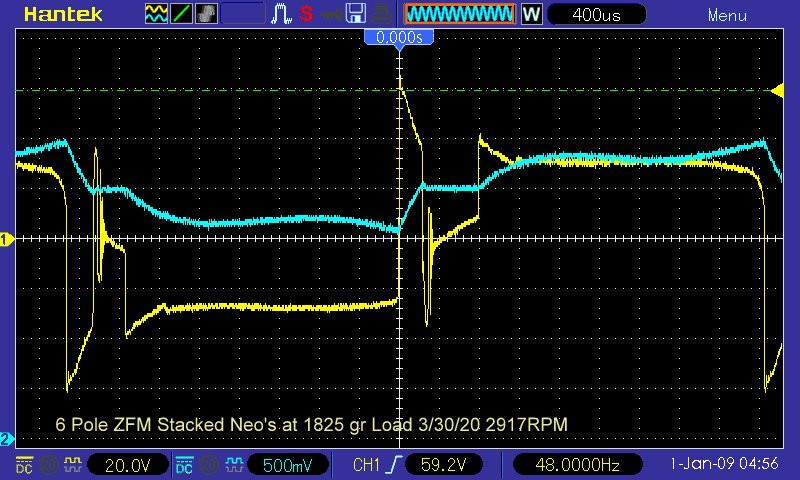

                  A quick expanded look at the oscope shot at high load below
                  Click image for larger version  Name:	pic_228_7.jpg Views:	0 Size:	120.0 KB ID:	72788
                  One will note how quickly the amperage (blue trace) returns to a zero value when the power is cycled off and the how rapidly the voltage rises on power-up - a definite characteristic of the air coil. So at this stage of experimentation all the goals were achieved, with the exception of the virtual coil arc. This particular ZFM configuration should be able to achieve 60% efficiency or more with the proper build techniques and tuning.
