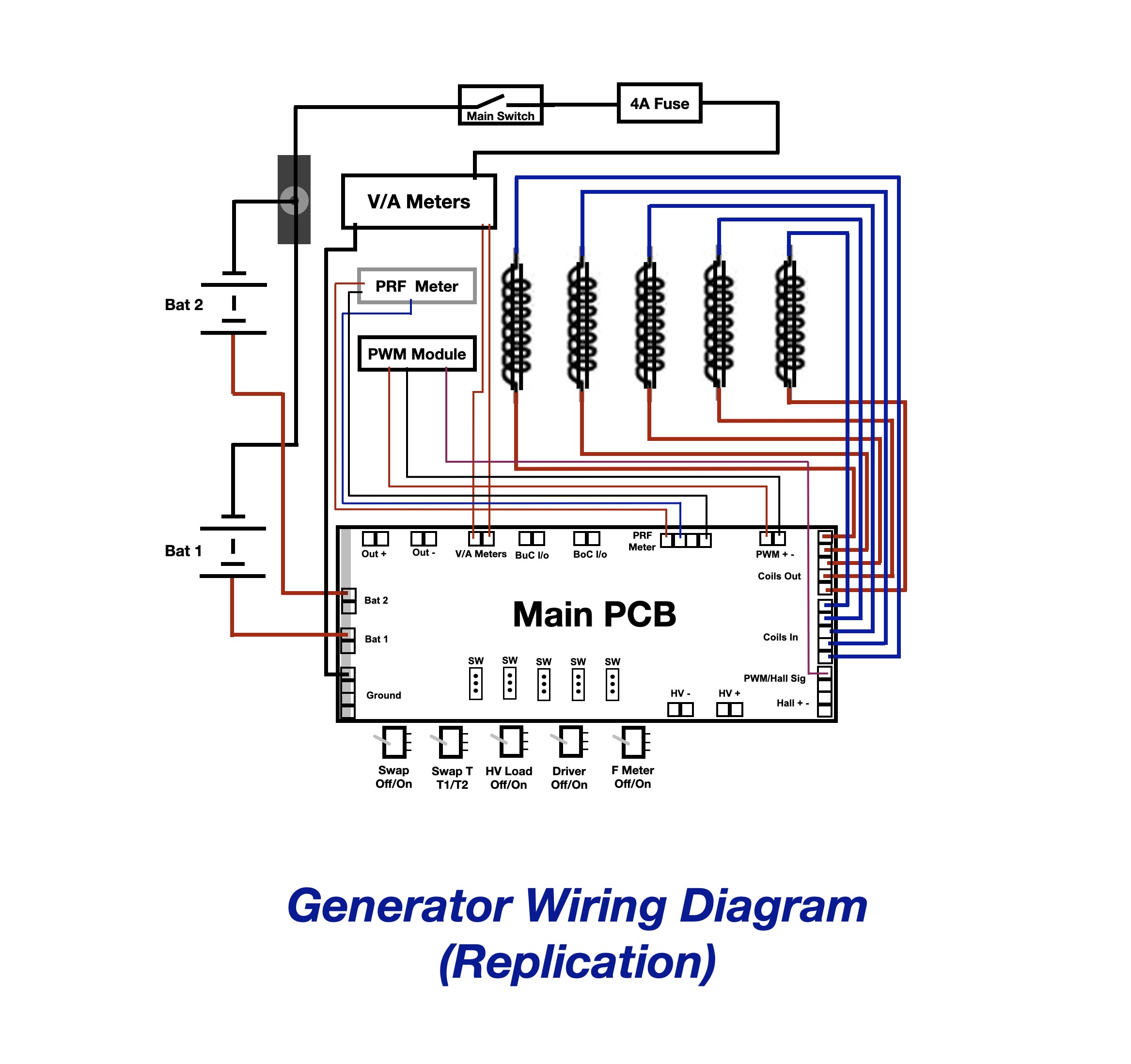

                          As some of you are keen to have a go at a build and have been asking about the main components etc., I attach the wiring diagram for the 'replication' circuit and have uploaded it to the 'Circuits' folder on the same Mega link. If anyone new to this thread needs the link again let me know and I will post it.
                          As discussed elsewhere, this is an updated PCB to the one I have been using for all my tests and is based on my findings of what works and what doesn't as, in my opinion, is not worth the effort and cost including parts that contribute little or nothing to the performance. This significantly simplifies the design, build, and components required.
                          The new PCB has now been designed and is off at https://jlcpcb.com/ for printing at the moment. I will assemble this board and replace my current one to check that everything works before I release it for others to use as Gerber files. Also, I have to write an extensive 'assembly manual' explaining everything about it, together with a parts list, and I hope to have that, and the board checked, by mid-December. Meanwhile, some of you may find the attached circuit helpful to use with what you already have or are compiling by other means.
                          A fascinating trip around the facility where these PCBs are made can be seen here: https://www.youtube.com/watch?v=ljOoGyCso8s&t=1423s
Name:	Generator Wiring Diagram (Replication).jpg

                            Hi Julian,
                            In regards to #12
                            So far using 1.5kV instead of 1.04 and 1.1kV is beneficial in most of the tests.
                            Is this your conclusion based on testing with the STW12N150K5 Mosfet in combination with DHG10i1800PA diode?
                            (waiting at the moment for a second RFQ for the diodes and Mosfets)
                            In reagrds to #13
                            Ok, great to hear! In the next on my list was having a look at the other components in your circuit, and for sure I would have questions about the exact parts you used, but I will practice a bit of patience then, if you plan to upload a parts list .
                            Best regards Rodolphe

                              Hi Rodolphe,
                              Yes, I have now tried the120k5, 150k5 and 170k5 with the 1800 diode. There is small improvement on CoP between the 95k5 and the120 and a bigger change between the 120 and the 150 but not so noticeable between the 150 and 170. Some battery formats (Ah and chemistry type) have a bigger improvement than others. Best CoP so far with an 18Ah LiFePO4 battery is 53.2 but I can’t say what that translates to in continuous Watts until I do power tests at the start of the year.
                              From my few tests so far with the supercapacitors, it appears that the battery chemistry is central to the phenomenon. That might mean that the pulses affect the chemical bonds in a way that draws vacuum energy in, just as with cavitation in water which is considered by some to draw in ZPE for the reentrant jets. This is just my speculation re the chemical bonds and I will need to consult with those who are working on that particular front.
                              For the best overall performance, without a big increase in Rds (Drain-Source resistance), the 150 works well but my new board will allow two FETs to be installed and then jumpers to select which one fires.
                              I would be ok with uploading a parts list for the forthcoming PCB within the next week if anyone wants a head start on that issue. It’s going to be 99% correct. The other components for the rest of the device will come in December.
