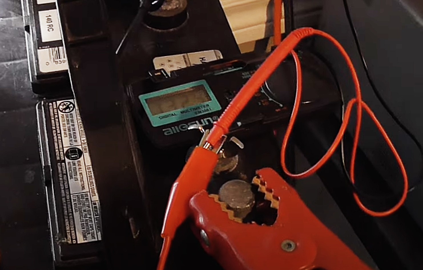

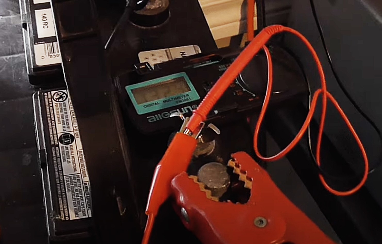

The first point of interest is the starting voltage of the battery that you can briefly see at video time 1.17 and which is shown and enhanced in Fig 1. The value is 13.24V so the battery has been freshly charged and is not starting to run the 100W load from around 12.50V as implied later.

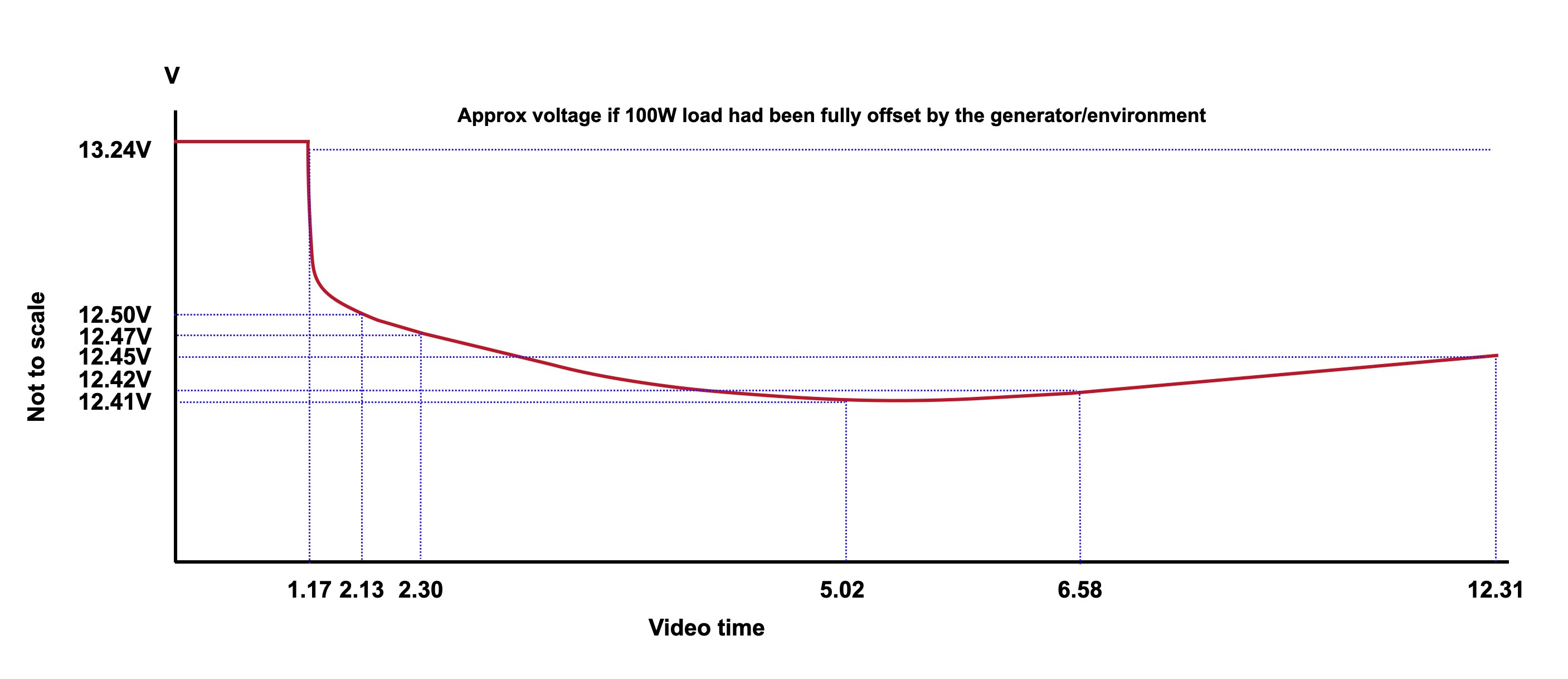

When the 100W light bulb is turned on via the inverter, the battery voltage naturally drops and which is to be expected when about 8A is being drawn down for the load. The voltage drops from 13.24 down to 12.50V (at time 2.13) and where part of this voltage drop is due to the internal resistance of the battery itself.
As time proceeds the voltage drops further, as expected and normal for a battery under load. The timeline of the voltage change over the video is depicted below and where the voltages are not drawn on an accurate scale and the X axis shows the video times where these voltages can be seen.
After about 7 mins we see a small 0.01V increase from the lowest voltage reached and over the whole demonstration the voltage rises back up by 0.04V.
The first and main conclusion from all this is that clearly, the system is not drawing in 100W of power from the environment for, if it was, then the voltage would not have needed to drop down nearly a whole volt from 13.24V to 12.41V but would have remained somewhere close to the original level. If indeed the cap dump pulses were serving to draw in local ambient energy, then the only voltage drop would be due to the 8A passing through the internal resistance of the battery.
The small voltage increase seen in the second half of the video is likely due to a modest energy influx, probably less than 10W equivalent and which is helping to drive the voltage back up a little. The only way for the voltage curve to reach back up to the original voltage level would be for the system to draw in considerably in excess of 100W to both offset the load and also to ‘pay back’ the energy drawn from the battery’s electrochemistry.
It is likely that if this demonstration was continued then the voltage would level off at a value reflecting the fact that overall there is still a net draw of 80-90W on the battery and, in keeping with normal battery behavior, the curve would remain fairly level until the battery starts to run out, whereupon it will decline steadily before a rapid decline near the end of the available capacity (Ah).
Overall, if the generator was genuinely supporting a 100W resistive load then the voltage would have remained fairly stable from the start and, as shown in the video, it gives the impression that an initial voltage of around 12.45 is maintained from the start, whereas in fact that is not the case and there is a significant and typical voltage drop as the battery itself drives the load.
