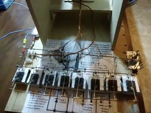

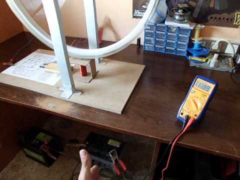

    Hi all from Spain.
    I'm just a humble user without studies and three months ago I decided to make a Bedini. For an uneducated guy like me was a challenge and more when almost every detail as videos, documents, etc. ... is in English. Well then there was a guy in town I try to make a radiant energy oscillator. Today I share with you one of my videos I've done. Hope you advise me to correct errors. Thank you and excuse my English but this translated with a translator.
    (Spanish)
    Hola a todos desde España.
    Solo soy un humilde usuario sin estudios y hace 3 meses decidí hacer un Bedini . Para un chaval sin estudios como yo fue todo un reto y mas cuando casi todos los detalles como videos, documentos, etc... esta en ingles. Pues bueno hay estaba yo un chaval de pueblo intentando hacer un oscilador de energía radiante. Hoy quiero compartir con ustedes uno de mis videos que he echo. Espero que me aconsejéis para corregir errores. Gracias a todos y disculpen mi ingles pero esta traducido con un traductor.

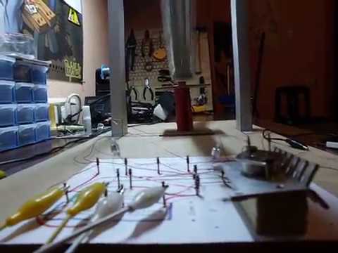

    Originally posted by min2oly
    I like the clean build, nice wheel too!
    Ok remember you asked :-)
    Dump (get rid of) the daftman layout - great for visualisation - poor for good charging/tuning. daftman layout is perhaps why many fail.
    solder everything directly to the transistor.
    put a capacitor in parallel w/ the power supply.
    put nice thick leeds from circuit to the battery (no small alligator clip leads)
    put the circuit right on the coil.
    transistor may be too big for that small wire sub w/ mje130007g
    and sub E/B diode w/ 1N914
    or...

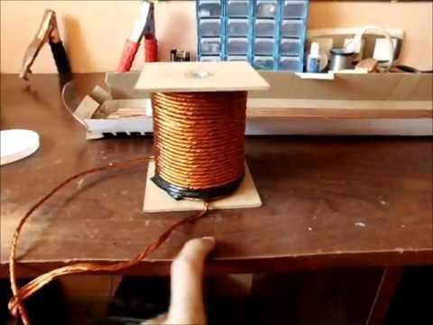

    for that coil and that wheel the thinnest wire "I" would use is 20awg (0.81)
    if you're going to replace it, go w/ 18awg
    I like your clean table. This build is a VERY good first step!
      1 Where to put the capacitor? In primary or secondary battery
      - Parallel to your power supply.
      2 Set LED thick. No where to put them.
      - Not LED - "Lead" the wire leads. The wire that goes DIRECTLY from collector diode to charge battery, and the wire that goes directly from primary + to charging - . I spelled wrong (leeds)
      3 Switch right in the coil circuit.
      - Not "switch", Mount the circuit onto the coil or right next to it. the energy is traveling too far from your coil to the circuit.
      4 You could spend some diagram with details
      - No change in diagram, just get rid of all that extra daftman wire. solder your emitter/base diode right onto the transistor etc...
      solder everything right onto the transistor

          Min2oly friend said one day as I'm just a humble kid from uneducated people and the truth that I have no words to thank all the help you're offering me "THANK YOU". I'm following the advice you gave me "THANK YOU" but would appreciate your help again How I can know if my Bedini has a higher COP?
          From Spain, Andalusia, Almeria, El Ejido THANKS a million
          (Spanish)
          Amigo min2oly como te dije un día solo soy un humilde chaval de pueblo sin estudios y la verdad que no tengo palabras para agradecer toda la ayuda que me estáis ofreciendo "GRACIAS". Estoy siguiendo los consejos que me diste "GRACIAS" aunque agradecería de nuevo su ayuda ¿Como puedo saber si mi Bedini tiene un COP superior?
          Desde España, Andalucía, Almería, El Ejido un millón de GRACIAS
