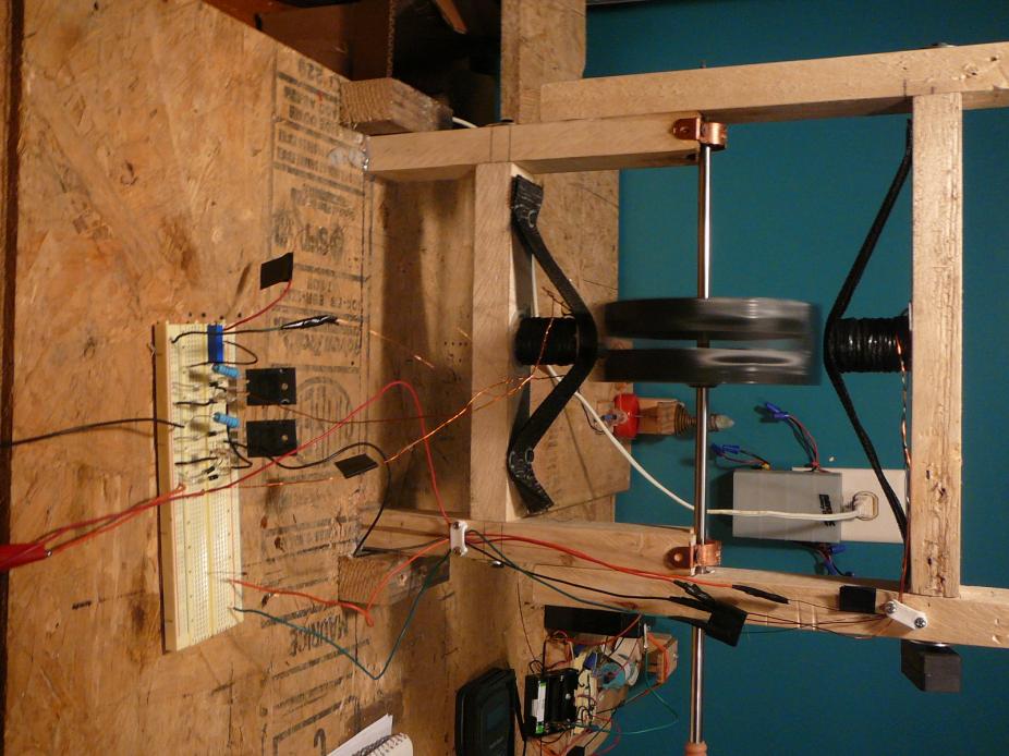

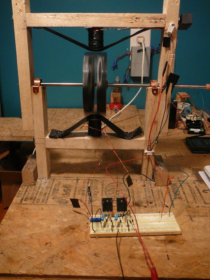

      The spools are 1 3/4" Tall x 1 5/8", and the wires on it come to about 1 1/8" Diameter. the cores are made from rebar tie wire and are 7/16" Diameter, 2 1/4" long with the excess out the back.
      On the current machine, I have not messed with the magnet spacing much at all. I set the coils only a few MM away from the closest point of the passing magnets. I did make it adjustable though, so I most likely will try everything that I can on this current setup before I start changing things.
      This is not my first build, but I am definitely still a beginner. I'm trying to learn and absorb as much knowledge as I can about every aspect of electronics and electromagnetism.....
      However, I am limited on funds temporarily, so I have been disassembling previous builds to make new ones. As I learn more, I will continue to design some permanent builds from the knowledge I obtain.
      I do not have a method for measuring the spikes.. but I would like to. Can you point me in the right direction so I can find out how to do so?
      ---One thing I have noticed is that because of the resistance in my Meter, when I connect it to measure the Current, it slows down the machine a little and therefore drops the Current measurement just a little, hence why I have added about 6mA to the Meter's reading.
      Thanks for your interest in my project! I'm antsy to get some ideas from other people, since no two minds are the same!

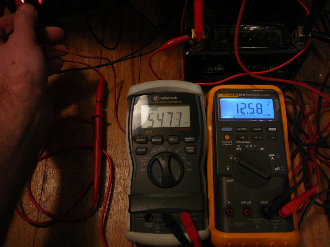

      More results:
      8:48 - 12.40
      9:51 - 12.42
      11:20 - 12.45
      12:49AM - 12.46
      12:12PM - 12.57
      1:00 - 12.58
      1:27 - 12.59
ID:	46875Click image for larger version

        [ATTACH=CONFIG]4410[/ATTACH][ATTACH=CONFIG]4409[/ATTACH]
        I like the dimensions on this build.
        definitely once you have the amp draw measurements, remove the meter so it does not get any back spikes and ruined.
        have you ever held the coil in your hand while it is running?
        on a build this small it was a very educating experience, for me anyway. For anyone who has not, monitor the amp draw and speed vs charging and how the coil feels relative to the distance from the wheel. feel free to move the coil, not only closer and farther from the magnet, but also side to side. the coil is usually perpendicular to the wheel, turn it slowly parallel. if the wheel does not continue to rotate, reverse the coil connections or rotate the coil. remember that coil is a magnet that is only on when the magnet passes, it's pretty cool to feel how the N and S are interacting... It's ok if you leave one coil in place for this. This is all just very interesting and fun things to do with a smaller wheel.
        this won't let you see how large the spikes are, but you can see how many spikes you are getting per magnet pass:
        22/26 awg with that core size should let you get all the way down to one spike if your wheel has little to no drag. I might have gone with 24awg for the trigger and wind 3 full passes up and down the spool prior to starting in with the 22awg. I think your 26 will be fine though.
        I have always had better charging with low RPM and 2 spikes there are many ways to take the rpm down. This is contrary to Aaron and Peter's last book however, so maybe I'm doing something wrong :-)

            I have not held the coil in my hand on this build. I most certainly will try that with my 2nd coil, and when I build another one, I will do it with only one coil! I did notice when I moved the coil around on one of my previous builds, it would change the timing and either speed up or slow down the rotor, but at that time I only had one meter (the Fluke that needs new fuses - couldn't measure current!!) and couldn't monitor input and output simultaneously... Now I have several meters, but the only analog I have is a cheap walmart one that has crappy range settings. I do not have a scope yet, either.
            The coils are fairly small, and I still have more 22awg, so maybe I shall scrounge up some 24awg somewhere and make a coil to your specs, with the trigger wire wound as you stated.
            On another note, I was messing around and noticed that one of my 2 transistors was not firing (neon not lighting with no charge batt) so I got to inspecting, and realized that the power wire was broken on my top coil!! So all this time I have really just been running a SSG with a coil adding drag up top!!! I fixed it, and am currently messing around with the base resistances and seeing what else I can do. I was kind of baffled before when my unused trigger wire was only giving me 5V output.. now I know!! Any ideas on what to do with it? Add it in with the 1st trigger? Match the resistance to the first and add a second pot? Run it into a rectifier and cap dump it, or direct return it? Do nothing? All of the above???
            Thanks for the vid, though! now I am going to play around a bit and see what I find out....
              Oh, yes.... I would like to add the final results that I got before I shut it off and fixed the 2nd coil:
              1:27 - 12.59
              5:31 - 12.64
              7:28 - 12.65
              Powered down the machine and let the battery settle for an hour and a half....
              9:05 - 12.50
