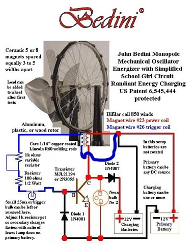

    Instead of connecting the the trigger bottom to ground (emmiter) you connect it to Primary Pos. The trigger is no longer working via induction but rather by a primary feed. The circuit goes into self oscillation. This is a typical solid state as first introduced by Patrick who also made many videos of it. It is literally the same circuit accept the movement of the trigger from ground to pos. I say it is typical because I have made other solid states that were not the same and I am not talking about those.

        Ed I don't know how else I can say it, it's a normal SG with the trigger bottom moved to the primary bus.
        The coil is smaller than normal but otherwise it's the same circuit we all know.

            Hi Bobzilla,
            Thanks for the answer, However i guess when you do as you said, the base is forward biased and drives the collector into saturation (Continuos ON State) how does this self oscillate? the only way i see is that the base resistor increased considerably to a high value..is that the case..? please revert with clarity on this ..

              Faraday it does not really require a lot of resistance. If you build one I suggest you start out with some extra but then find the right range by tinkering with it. This is nothing new to the forum, Patrick led the way several years ago and made a great video series where he not only showed the SS mod but also his CPD mod as an addition to it.
