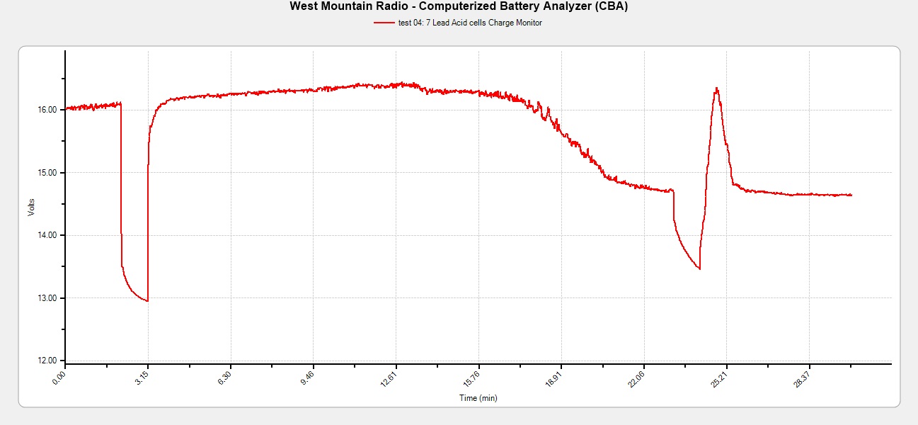

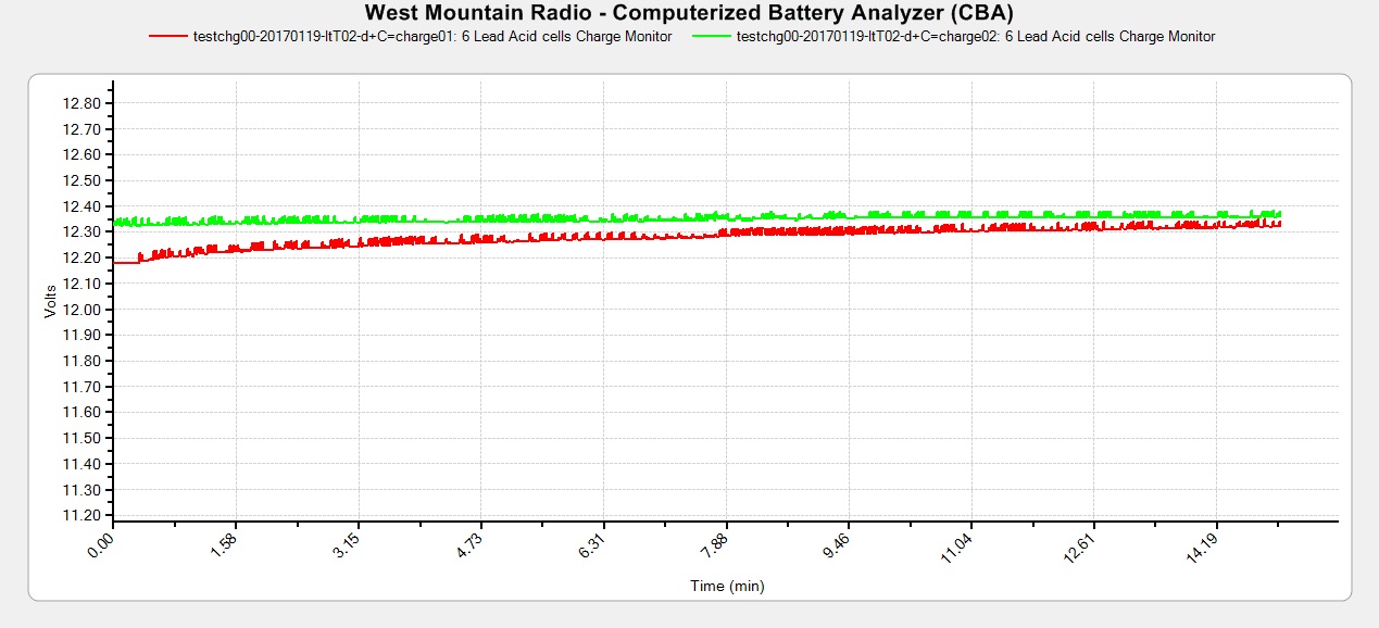

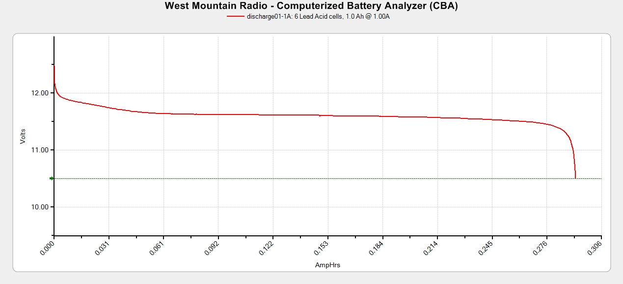

Update #2
1. The first battery - the one that read 0.55 vdc is epic fail, ready to be recycled.
Bon voyage, battery #1. Except -- tomorrow will be another day, and the computerized
battery analyzer . . .
2. Battery #2, 300 CCA instead of 230, responded to the 1AU by taking a charge.
Unfortunately I do not yet have a 10A12. Hello, Teslagenx or Tesla Chargers?
3. Battery #3, a gel cell, and fairly new, is still charging after 4 hrs. Previously
it charged to 13.3 vdc at the 1AU. After 4 hrs, it is knocking on the door of 12.97,
up from 12.59. And the front battery is at 11.68, presumably down from 12.40.
This concludes update #2.

This will be Update #3
1. The previous notes were made yesterday and last night up until midnight.
2. Today, Tuesday, was/is receive CBA day. But the neighborhood kitty cat slipped past
the door while a I was receiving it, and, well, goodbye little kitty . . .
3. As I was writing the "3", the CBA arrived. In the following comments I will
anticipate questions and provide answers.
4. What it is: CBA IV.
5. For more information, check with www.westmountainradio.com
6. Comes with a DVD because it is software driven.
7. In the box is also a USB cable, a pigtail adapter, and a spare fuse.
8. Operating Manual.
9. Need a PC with a Pentium 233 or better, and either 32 or 64 bit technology, w/Windows.
10. Other stuff not given here.
Until I get going with this thing, I will be happy to take questions, comments, suggestions.
Start looking for a new post in this thread, then.
This concludes Update #3 for now.
