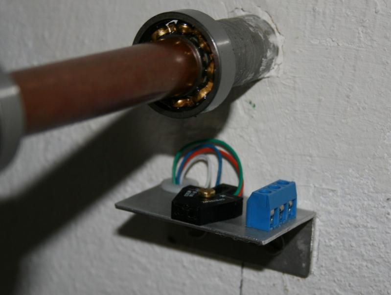

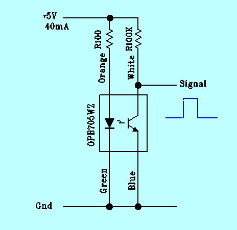

Hi All,
Here is the info on the RPM Sensor.
Circuit - Signal is connected to digital pin
Photo - Yes the bike wheel shaft does come out of the workshop wall.
The resistors are on a small circuit board under the bracket.
Sketch:

I hope this sketch is readable. Any suggestions welcome.
Peter

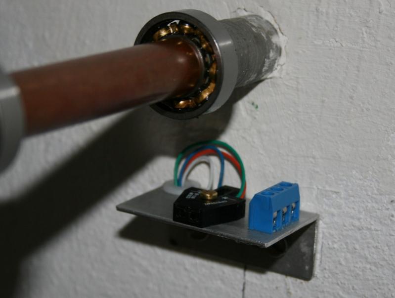

Sketch:
/* RPM sensor using a Reflective Object Sensor OPB705WZ from OPEK Technology
Peter
