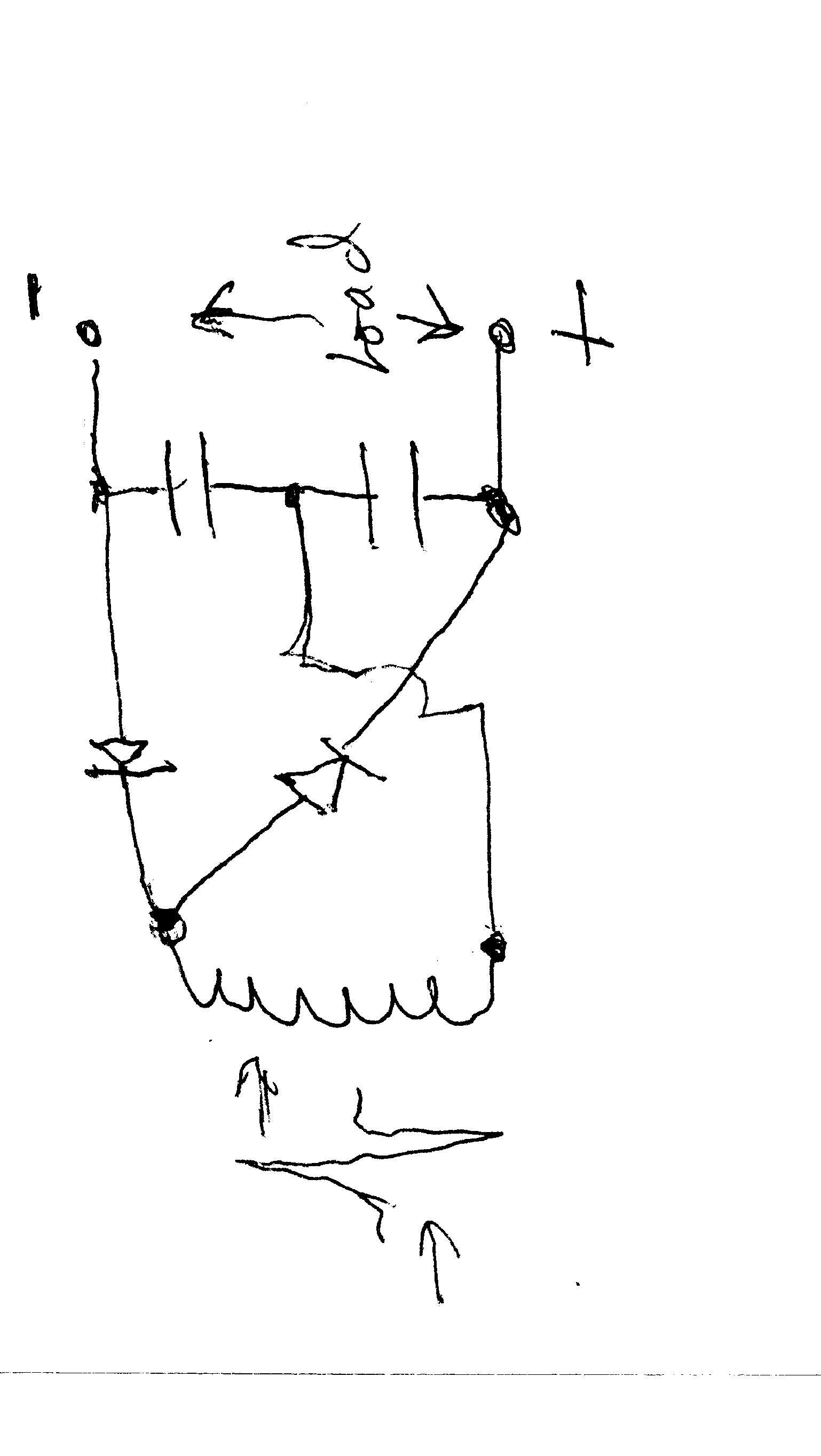

                  Hello, where and how are you using the output of the gen coil??? because Peter and Aaron had it conected to some caps and led light array, in a way that the gen coil only works on the peek of the sine wave so the drag happens only when the magnet is over the coil and not all the time, that way the drag is a lot less.
                  if your gen coil outputs for example 20v and you use it to charge a battery (12v), the gen coil would create drag almost all the time. Now.. if your gen coil outputs 13v and you charge a 12v battery the drag is a lot less.

                      Hi Rodolphe,
                      . I assume you mean you put your caps in series? The reason for this being that with the caps you had laying around this yielded the correct amount of voltage rating?
                      I think when I first measured the voltage it was around 23 to 25 volts across the caps the way I have it configured. So I started experimenting by adding LEDs in series with various resistors and checking voltage drop across each LED and the resistor. Then I tried paralleling more and more strings of LEDs with a common single resistor in series with all the paralleled strings. I wound up with 6 parallel strings of 7 LEDs each, all connected to a single 100 ohm resistor. ........... 42 LEDs in total ............ At 300 + RPM they are pretty bright, but get dimmer as the speed decreases. to 200 RPM where they eventually go out.
                      My caps are rated 680 uf and 200 volts. These were just some I had laying around that I got a good buy on.

                        That schematic you mentioned in post #11: very clever! Thanks for uploading the sketch of the schematic.

                          Hi Rodolphe,
                          One of the things I was wondering about is why they used AWG16 in the handbook: for the little amperage that goes through the circuit, even AWG26 would suffice… (maybe it was just what they had lying around).
                          I think the idea was to get the least resistance in enough turns to still get a usable amount of voltage. There is a trade off somewhere between number of turns and total coil resistance. It depends on whether you're after more voltage or more current.
                          Another approach is to utilize coil shorting, as in a magneto circuit where the breaker points are closed (shorted out) until the magnets are centered over the coil and then suddenly open up. That is something I want to try, but haven't gotten to yet. (Too many other experiments.)
                          In the thread previously mentioned*, post #244, you say that you have 2 generator coils:
                          Coil 1: as described per advanced handbook (10 twisted pieces AWG16 wire, connected in series, total length +/-305m)
                          Coil 2: AWG23, single wound wire, +/-4026 turns.
                          Both yielding more or less the same result.
                          To clarify a little further, coil #2 was wound first and used as a generator coil on a different SSG. It didn't produce much output using a bridge rectifier. It would only power two or three LEDs and wouldn't produce enough energy to power the switching circuit either. That machine was triggered by a hall switch and ran maybe 250 RPM.
                          When I modified my better SSG to replicate Peter's set up (Gary's "complete advanced" SSG build), I made coil#1 and added it like Peter showed. Then I decided to try mounting coil#2 upside down under the main power coil that runs the SSG. By doing this, I was able to inductively couple it and recover some energy that is normally wasted into the atmosphere without producing any measurable drag or reduction in charging! This coil, operating in this manner, will light the same number of LEDs (42) as coil #1 does. It uses the same voltage doubling arrangement as coil #1 and is totally dependent on the main power coil. (When the main power coil isn't triggering, coil #2 has no output.) It varies in output with speed also, but not as greatly as coil #1 does.
                          I also discovered that I can parallel the DC outputs from both coils to charge a small battery as shown in this video. https://www.youtube.com/watch?v=R8hne9qVCww
                          One other thing to note is that the two coils have different shaped wave forms as shown on the o-scope. The generator coil (coil #1) has the wave form I illustrated in my drawing of the voltage doubling circuit with a sharp positive voltage followed by a sharp negative voltage. And coil #2 has the same form form as the main power coil of an H-wave with a sharp voltage spike at transistor shut off. Neither coil has the normal sine wave form of AC power from the power company. That's another reason I didn't use a full wave bridge rectifier.

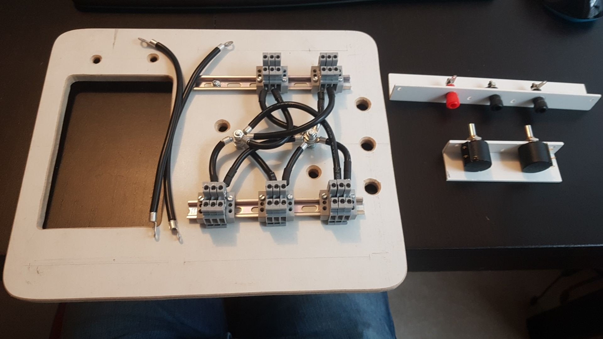

                            P.S. In the meantime I’m working on my comparator circuit. Frame parts is done, now need to solder all the (small) components).
