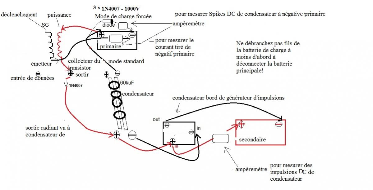

                            @Denis pourriez vous nous joindre un petit schema en ligne pour voir comment vous avez place les instruments de mesure de courant ?

                            @Denis could you contact us a small diagram online to see how you placed the current measurement instruments?

                              • #45
                                Thanks Mikey!
Name:	sg setup with comparator in forced charge modeA.jpg
                                sorry but this is in French, not that I speak it, I made it for the French guy.
                                It is how I have the meters and the set up.
                                Comparator: The printed board was gifted to me, I just filled it in with parts I bought.
                                Shall keep fiddling about with my small thing.
