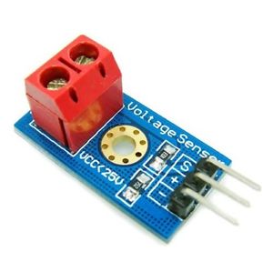

                        Maybe you could add this little module to the arduino in conjunction with your solar panel to make sure your setup only triggers within a set range...
                        This could help under low light situations, add some txt to change the freq as the clouds come in etc...
                        KR,
                        Patrick A
                                Click image for larger version. Name: $T2eC16hHJHIE9nysfqDLBQiTeVdoYg~~60_35.JPG Views: 4 Size: 12.2 KB ID: 3511
                                KR,
                                Patrick A
                                Nice! I will keep it in mind as I work towards the solar. I still have a lot of tuning to try out with this thing so it might be awhile until I get it on the solar. I am using my little tracker5 3a on my panel though and damm it works pretty good. It even charged up one of those 100AH depp cells I have, not the walmart but the real 100AH (blue ones). It took a few days to do it but it did eventually take it to 15v.
