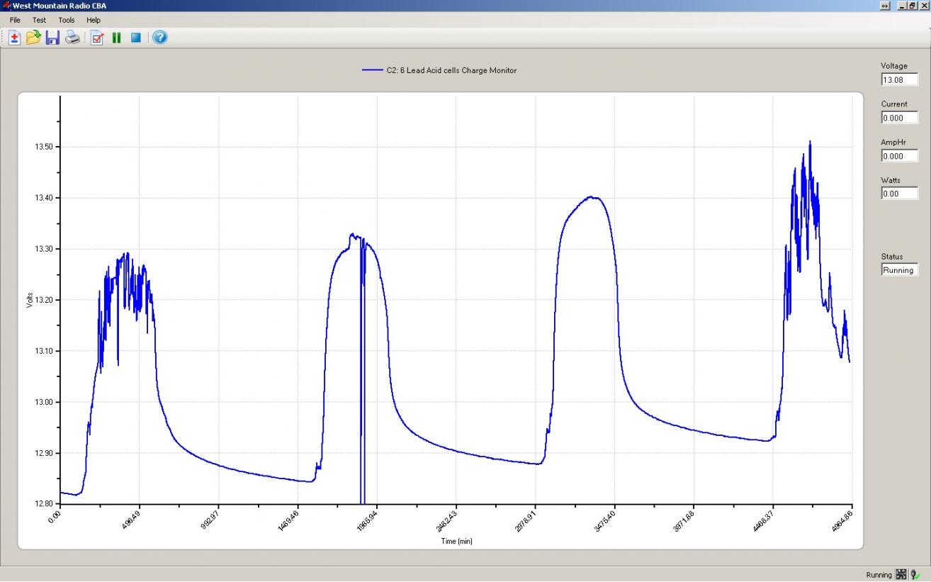

                              I've been charting the past few days as my Trojan T-105 charges up from this panel and SSSG.
                              You can see the first day was partly cloudy, as was today. Past two days were great. Pretty fun to watch, and I definitely get excited now about sunny days.
                              I have the resistance up so that it is only pulling 1.5 amps into the machine. Anything extra just pushes the cap voltage higher.

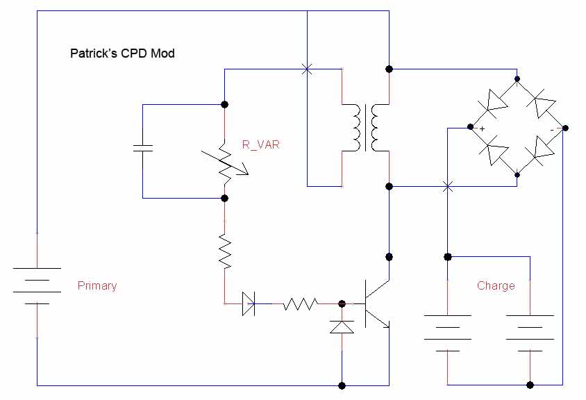

                              I would like to implement the mod that min2oly describes at 2:30 in this video
                              On this thread in the forum, John describes almost exactly the same setup as me: http://www.energyscienceforum.com/sh...?t=1801&page=3
                              And then min2oly responds with the circuit schematic. Has anyone else built this or had success with it? I am thinking of trying it.
