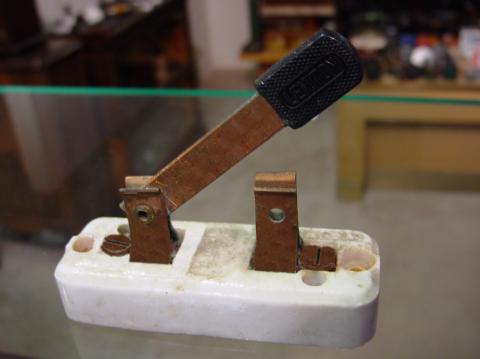

Hi Bob,
I think it would be a good idea to replace that switch with a snap action one that has no center off position. That's what I have on mine, and even then it will give one quick flash of the neons if I switch it while the wheel is running.
Safest thing is to not even touch the switch while the wheel is running. Yea, I know, Peter shows doing this in the video and I saw him do it in person at the conference. But with my machine, I do sometimes get a quick flash of the neons which can't be good for the transistors. So now I always disconnect the primary battery before throwing the switch. And if you have a capacitor across the primary it should be disconnected as well, so the stored charge won't blast the transistors while throwing the switch.
