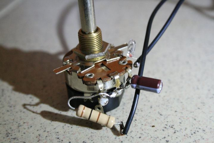

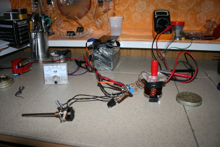

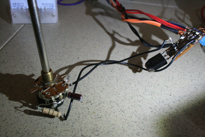

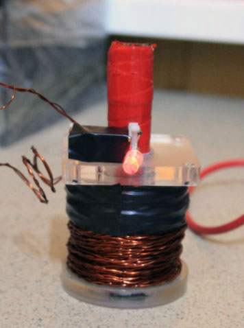

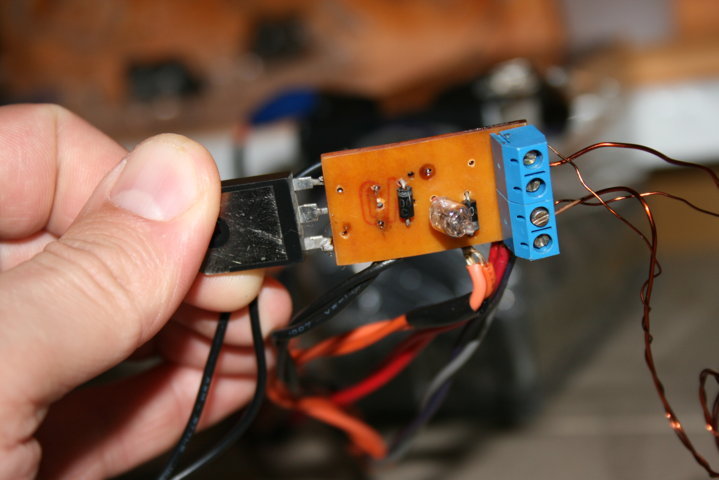

              @Patrick, first of all, thank you for your reply. I did enjoyed watching your videos, and this it's actually a replica of your work, but with only a single transistor, and with smaller wires.
              About "ckt" - you mean capacity? I use a 10 uF/50 volt electrolitic tantalum capacitor. Schematic it's the same - I use a 2,2 Megaohm/2Wat pot, in series with one 100 ohm /2wat resistor and with a 12 volt/100 mAmp light bulb (to observe the current from the base of the transistor). Transistor is D209L (from a ancient computer power supply), but the oscillator worked also with a ST13007. Coil is twisted bifilar: 0,5mm trigger/0,7 mm power, ~27 m. length, with a R60 welding rod as a core (it worked also as a aircore, but frequency it's much higher... not sure if it's better or not). Unfortunately, I don't have an oscilloscope, so all the setup it's somehow... intuitive.
              One of the problem was the diode, I was using a 1n4148 instead of 1N4007 (on BE junction of the transistor), and now, after replacing with the 1N4007 diode, it's working, also, with battery, not only with light bulb as load.
              The dump charge, depending on frequency, is between 15-20 volts.
              I'm not sure if the dump (charge) should be more frequent, and with lower voltage, or more rare, and with higher voltage.
              Anyway, when discharging frequency it's rare, the mAmp draw it's quite low (2~10 mA), but battery charges forever. With higher frequency of the discharge, charging it's a lot faster, current draw it's also higher... but I'm not sure if it's a radiant or a conventional charge.
              In your videos, it's seems like even for slower frequency discharging capacitor, voltage spikes looks to be quite strong - maybe 60-80 volts?
              What it's your opinion on this?
