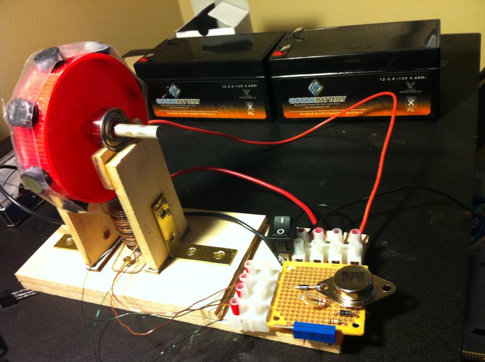

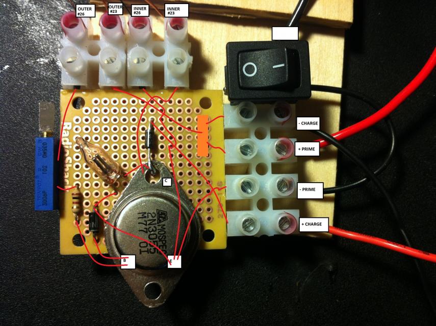

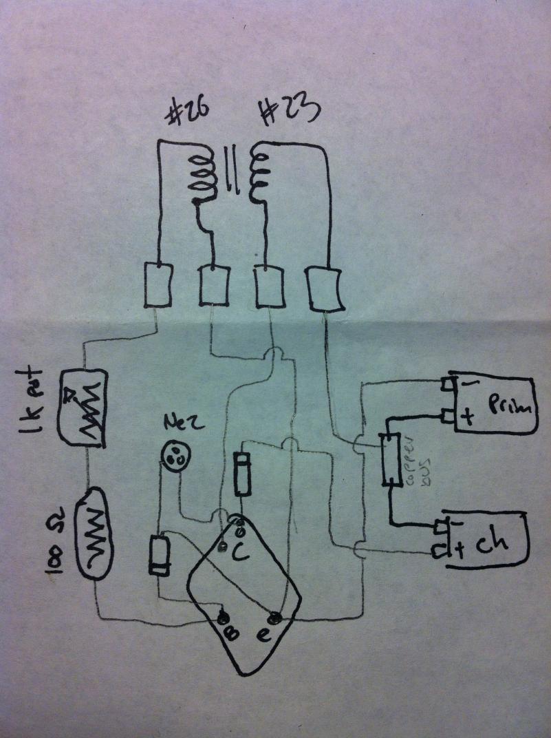

Hello ALL, im a new member, i just finished building my monopole using the instructions provided for this experiment as accurately as i could, yet it's still not working, sorry to bother you with this, but i need help, i have rebuilt the circuit 8 times and it seems to be accurate, but obviously there's something im doing wrong... here's a picture/diagram of exactly how i wired my circuit, and another one of the rotor/stator, if any of you can spot the mistake please let me know. wired this way, the coil gets Really hot (above 200F) also the transistor. when i crank the shaft the motor doesn't start, and it seems like the poles are NOT shifting, it stays on attraction mode. the picture/diagram is based on the exact wiring i have on the board, this is my 8th attempt at rebuilding the circuit from scratch with new parts. all parts were tested and so were all the connections... thanks!
SSG monopole not running

I know what John K has said to you , but here is what I see. First the magnets what are they? are they # 8 ferrite magnets or dime store magnets.
Second the coil is not big enough in my opinion, just my opinion. The pot needs to come out of the circuit and insert a 470 to 680 ohm resistor. The circuit looks right.
In the original postings on the school girl motor, as it ran on a 9 volt battery 450 turns on the coil was enough.
If it was me I would use a old solder roll and fill it with wire number 23 for the trigger and number 20 for the power coil.
The solder roll size would be 2.30 inches high and 2 inches diameter, hole diameter of 7.50 filled with the correct welding rod.

Thanks to all, first, gary the transistor is seen from above, not below, that is, the cap is on top, so the base and emitter are in the right position... John B. thanks for your reply, the magnets are ceramic from radioshack, they are not very strong... the coil has about 500 turns of #23 and #26 magnet wire, thats all the wire i had... i will try your suggestion to build a bigger coil... do the core welding rods need to be copper coated mild steel?, or can they be bare mild steel?, here's a pic of the batteries i'm using, just in case this is the problem... thanks to all for your help... cheers!

I just noticed that your protoboard (perforated PCB) is upside down. The norm is to place components on the non copper coated side so that when you turn it over you can solder the legs directly to the indivdual copper coated perforations. Its probably not that much of an issue, but since I cant see under your transistor I cant be sure. It is possible that one of the copper coated rings is touching the base or emitter pin AND also touching the case of the transistor. Incase you are not aware, that whole flat surface (the "brim" of the tophat) is the collector, any connection between this outer shell and the inner pins pretty much = short circuit. Flipping the board over may solve your problem, or alternatively, if soldering is not yet your thing, use no board at all. I see you have made use of the terminal strip to hold your wires, why not use the same method on your base and emitter pins? Quick and easy to change, will make things easier to trouble shoot. You can clamp the E->B diode straight to the pins this way, and use a small nut/bolt/washer assembly on the collector casing to attach your output diode and end of power strand. Make SURE the power strand connects on the ANODE side of the diode/collector case, directly to the collector itself is the best method, but if you leave enough leg on your diode you can connect it to that, its being connected to the collector anyway. All of these methods are for simplifying the process, as you get better you will solder as many connections as possible. Check for any conductive paths under the transistor, a small dab of solder in the wrong place or an off cut in the wrong place is all it takes. If you are uncertain of the pins still google 2n3055 datasheet and you will be able to get a visual reference there. You can do this with any electronic part.

Hi Ren, your post was very helpful, thank you very much... so i checked for shorts as you said, but i did it before you posted. you were right! i did have a short, the coil and transistor are not getting hot at all now, the transistor's collector case is not touching the board at all, only the pins go to the other side, but the case is in the air... now nothing is happening, which i assume is an improvement... i did blow up a couple of transistors at the beginning, and one time (this one is amusing), as soon as i cranked the shaft, the wires of the front battery got so hot, that the insulation burned out completely. The circuit seems to be fine now after re-checking a million times, and i will build it again with the board right, i actually like to build it, i'm beginning to memorize it now... i think the problem has to do more with the trigger coil as you and John B. said... i'm waiting on more wire to arrive and the copper coated rods to build a new bigger coil (thanks John B. for the reply)...
thanks for suggesting the voltage read on the trigger coil, didn't think of that... i measured twice, the first time it was reading 0.041V... then i shortened the gap by about 2mm and it read 0.12V... guess its still not enough since it didn't start... heh... and i did crank the shaft as fast as i could by hand as you said... i'm curious to learn how much is needed to start the system... thank you Ren, John B, and John K. for your help, and i will keep at it until i see it run and hope to go into the advanced experiments in good time, i think this system is genius and i appreciate very much the workshop style of teaching that you guys put up here for everyone to learn... cheers
