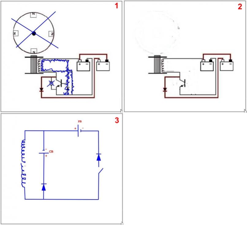

Below is depicted simplification step by step I have tried to do. Bicycle wheel with magnets and transistor (crossed with blue) is switching mechanism which I have simplified with on/off switch. So you can notice that schema on pic 3 reminds a lot on schema from the previous video. Only difference is that in the place of light bulb is charging battery.
