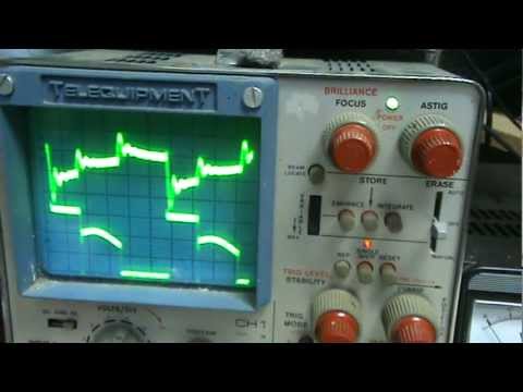

        Hi guys,
        Here's a video that explains what Mikey is talking about.
          Thanks John, was very concise i wonder the scopes could be of 3D version, people could understand better on what we all are talking about.
            ...And what would that 3rd dimension be I wonder?
              Thanks Faraday. I'd love to have a 3D scope! According to Tom Bearden we would be seeing longitudinal waves - would be great to see what they looked like
                Oh I get it...a 3D scope. People would actually understand if what you are talking about is more clear. A scope will always be 2D: Voltage vs Time. The way John demonstrated in his vid is already 3D. So I am guessing you want a 3D visualization.

                      It would seem to me your 3D image would depend on what kind of detector you used for the third axis. For example a magnetic detector could be used to show the E and M field relationship which is used in a defined way in waveguides.
                      As for display, if your detector for whatever you wanted to see (such as a longitudinal detector ) was converted to a voltage input. It could be put into a conventional scope with a Z axis input connector and displayed as a Lissajous pattern. This would not be a 3D image, but it would give a relationship type image on equipment readily available today. The problem is deciding what you are wanting to see and coming up with the detector unit.
