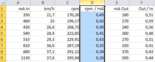

Continuing to run the Snowman SSG in a basic stable state to gather data for establishing a performance baseline that can be used as a comparison point for other improvements to the system.
Becoming more familiarized with SSG2 (new board) and have started to get a sense of how it all works - more tuning required, however most of the data points are relatively consistent with the existing set up using my mower batteries and a car battery. Info below is based on about 10 run cycles.
Using the car battery (Only for initial tests) as a Primary source it usually takes about 5.25 to 5.35 hrs to charge the mower battery to15.4v at about a 1.55 amp rate - 8.3 amp hrs or slightly less. The Charge battery has been receiving about 0.75 amp rate or total ~4.01 amp hrs from the SSG. Upon discharging at a 0.48 amp rate the Charge battery drops to the shutdown voltage of 12.2v after 8.5 to 9 hrs yielding ~4.1 amp hrs.
So far the overall charging system efficiency (Output/Input) is close to 50 percent, but improving. The Charge battery input and output are about equal with some reads above 1:1 on the output side.
Using a Sears clamp-on to do the amp reads - there is some reading bounce that is interpolated to the mean. Bounce is ~ +/-4 percent. Discharge of Charge battery is via a 6watt automotive bulb 0.48 amp rate using DMM to measure the amp draw. The clamp-on meter is used during the actual runs and agrees with the DMM amp read.
Conditioning of the batteries to be used for the actual tests continues.
So the above information creates a great starting point for the next modifications - first up is getting the freewheel time to increase - the magnets and tape definitely slow the wheel down due to air resistance.
More to come in this adventure!
