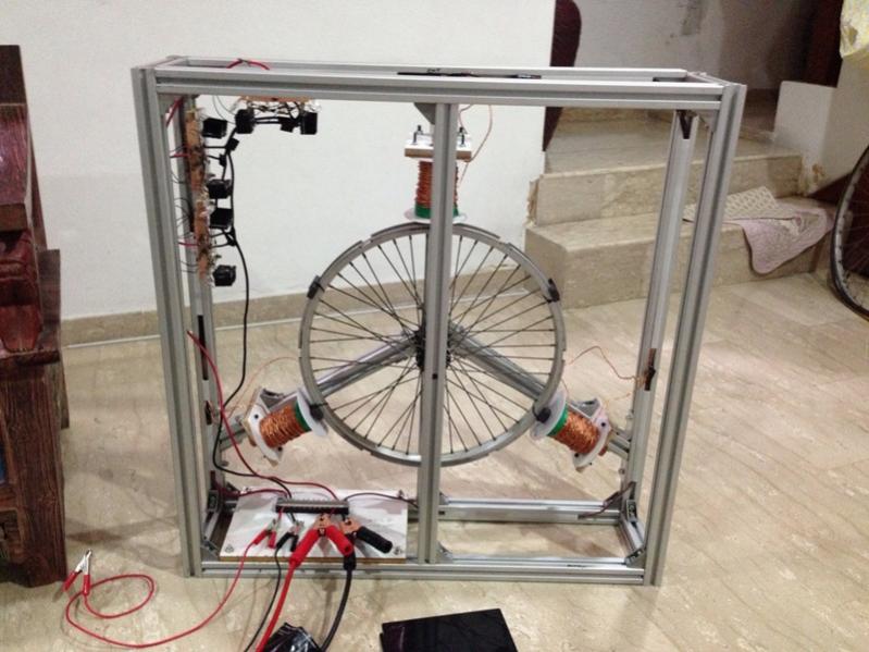

    Hi guys! I've just built myself a 3 coil monopole bedini motor after I bought a copy of Bendini Sg beginner's manual. I tweaked the number of copper wires 7+1 into (4+4+4)+1, which is 3 Spools of 4 x 115ft awg #20 copper wires + 1 x 115ft awg #23 copper wire in one of the spool. The reason why i got 115ft instead of 130ft because the copper wire I ordered online shortchanged me . Nevertheless, I fired up the system yesterday and it worked!
    My primary battery is 18ah and my secondary battery is 26ah. I was getting good results for the initial testing. I was getting about -0.1V/30mins in the primary and +0.3V/30mins in the secondary batter. Then I tested my neon bulb for the safety feature, all 12 neon bulbs lighted. I thought "Checked, all safety bulbs are in place" . I did not measure the amps that the primary battery is supplying(I do not know if the discharging rate is slower than C20). I left the motor on through the night.
    However, in the morning, when I checked the voltage in the pri and sec battery. I got -0.6V(12.29V) for the primary and +0.5V(11.89V) for the secondary. The COP dropped. I accidentally plugged out the secondary battery. I realized that only 7 Neon bulbs were lighted, the remaining 5 were not light up. I retested the safety features and confirmed that the remaining 5 bulbs were not lighting.
    Some reasons I thought why the NE bulbs did not light up when I plug out the secondary battery.
    1) Was it that the 5 transistors connecting to the 5 NE bulbs were fried?
    2) Was it that after a night of running the voltage dropped and did not fire the 100V NE bulb
    3) Was it some of the 115ft copper wires did not have enough length to fire the 100V NE bulb after the voltage of primary battery dropped through the night.
    -Am I able to check if the transistor is fried by testing it with multi-meter without removing it from the board?
    -How do I calculate C20 discharge rate for the batteries. Is it ah/20?
    I would appreciate if anyone in the forum could help me out. Thank you !
    Mark
    This is a snapshot of my model. (all the circuit boards are on the top left of the model)
Name:	2014-01-25 12.10.01.jpg

      Also, where are the rest of your magnets? It will send more pulses with more magnets in those gaps.

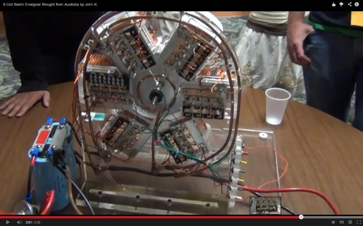

        sorry, another thing I see with your build , ..place the circuit for each coil near each coil, thus keeping the wires as short as possible.Click image for larger version
Name:	closeup of circuitback5.jpg
ID:	46043 The picture is a build by John Koorn ...notice how the circuits are all close to the coils? And also that copper common rails? You can hook each circuit up in series via this method for good conductivity, rather than having long skinny trigger and power wires like you have at present.

            Hi Dennis, thanks for the reply and advice! I'm still sourcing 6 more magnets to fit into the 17" wheel, making a total of 12 magnets on the wheel. My secondary battery started out at 11.4V after I drained it empty with 2 x 50W spotlights.
            It was only a few seconds when I accidentally plugged out the secondary battery. Isn't the NE bulb suppose to be a safety feature if the secondary battery is plug out accidentally? Is there any way to check the transistor if it is burnt out, because it would whole lot of trouble to de-solder and re-solder a new one. Yes, I am using MJL21194 transistor too. If it were to short circuit, where would it be?

                sorry, another thing I see with your build , ..place the circuit for each coil near each coil, thus keeping the wires as short as possible.[ATTACH=CONFIG]3072[/ATTACH] The picture is a build by John Koorn ...notice how the circuits are all close to the coils? And also that copper common rails? You can hook each circuit up in series via this method for good conductivity, rather than having long skinny trigger and power wires like you have at present.
                Why would shorter wires be better too?
