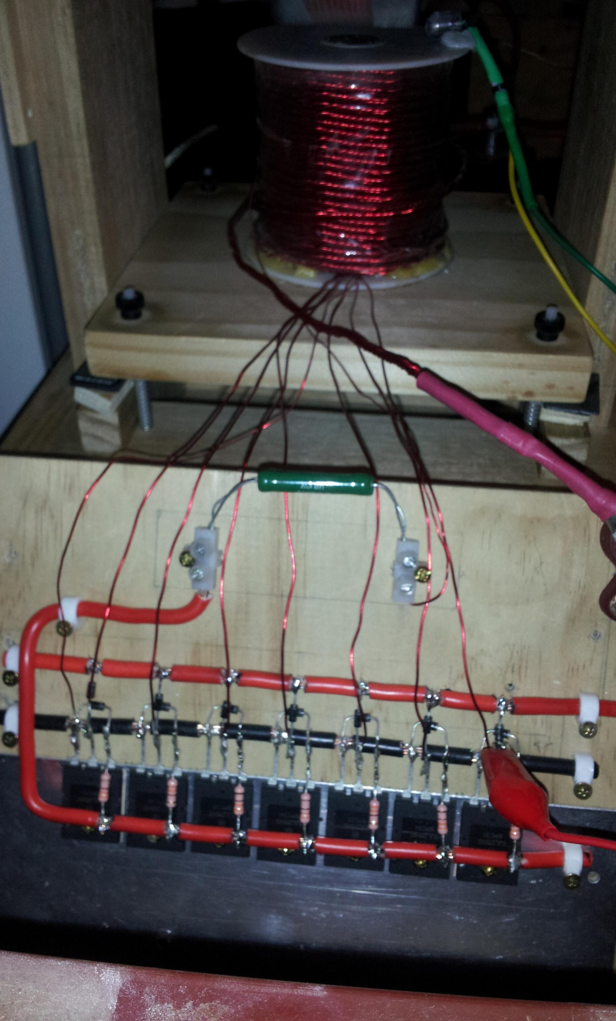

So with that in mind I attached my timing light on the coil perpendicular to the passing magnets and then proceeded to alter the coil gap and resistance until the magnets created a visual "bar" close to dead center (or 90°) to the iron core, this was once the wheel was up to speed as this alignment changes based on RPM - see video for what I mean. This resulted in the highest RPM for the lowest amp draw but I need to stress something... This was NOT the highest RPM that the machine can attain. I can get my machine to go much faster especially if the gap is only about 3 mm or so and I kick start it by shorting a high resistance 10W series resistor for example.
In this current configuration i am using 330ohm base resistance, 16.7Ohm 10W series, gap is about 8mm and RPM about 285 with 21 magnets, it draws about 1.2A. I have to give it a "fling" at startup to get it to single pulse.

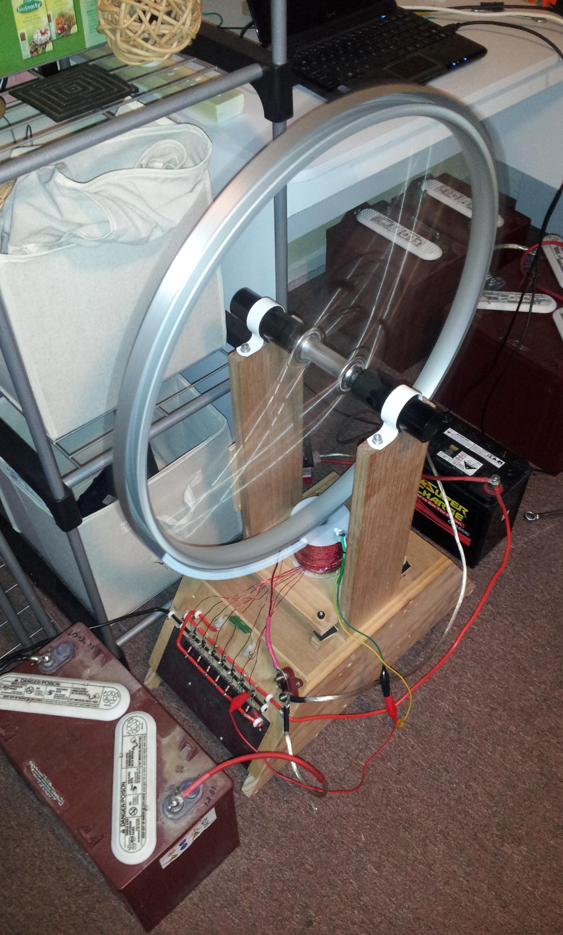

Also here is some pics of what I'm calling my "CLASSIC" ssg built along the lines of JB's original.
