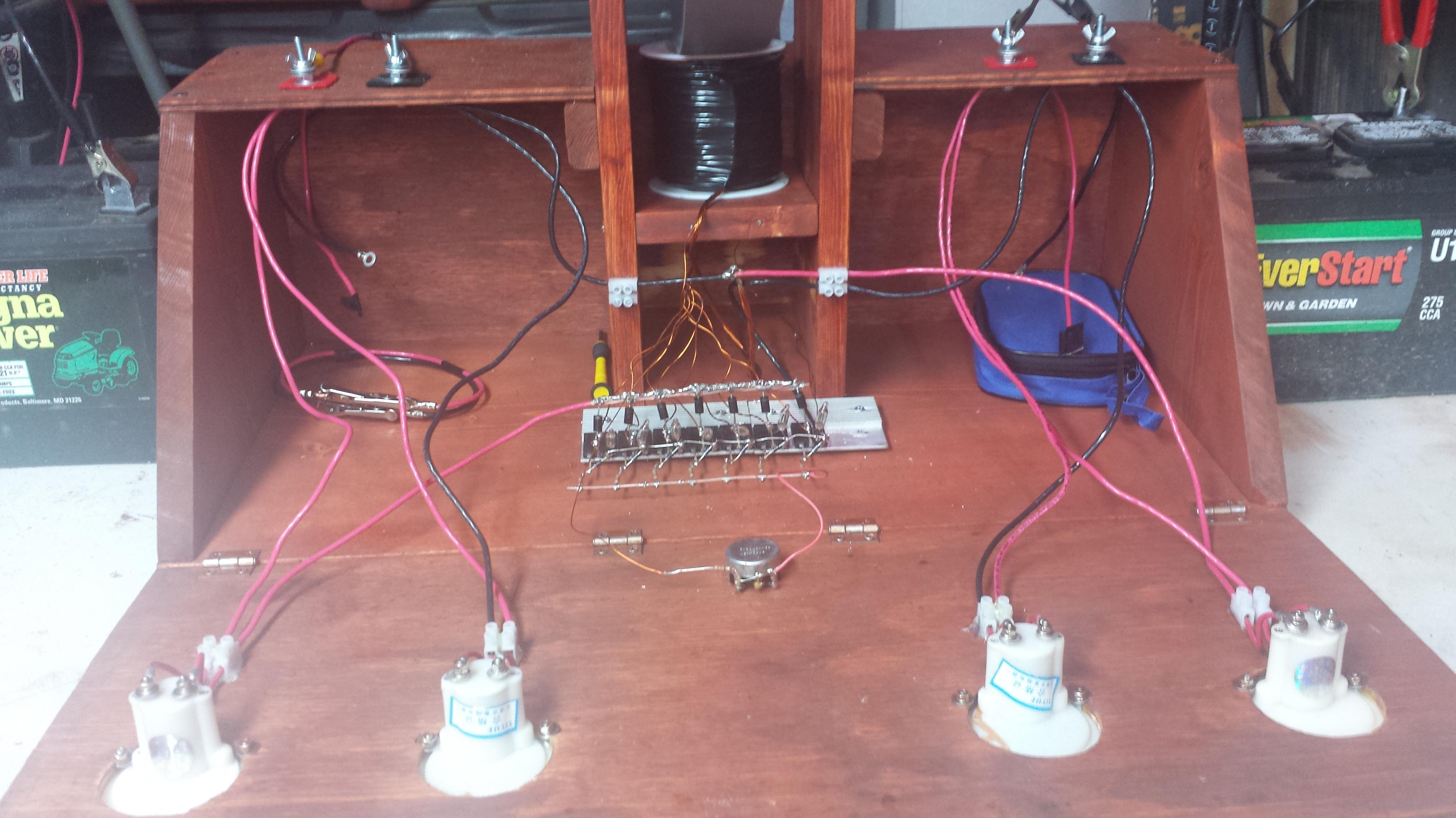

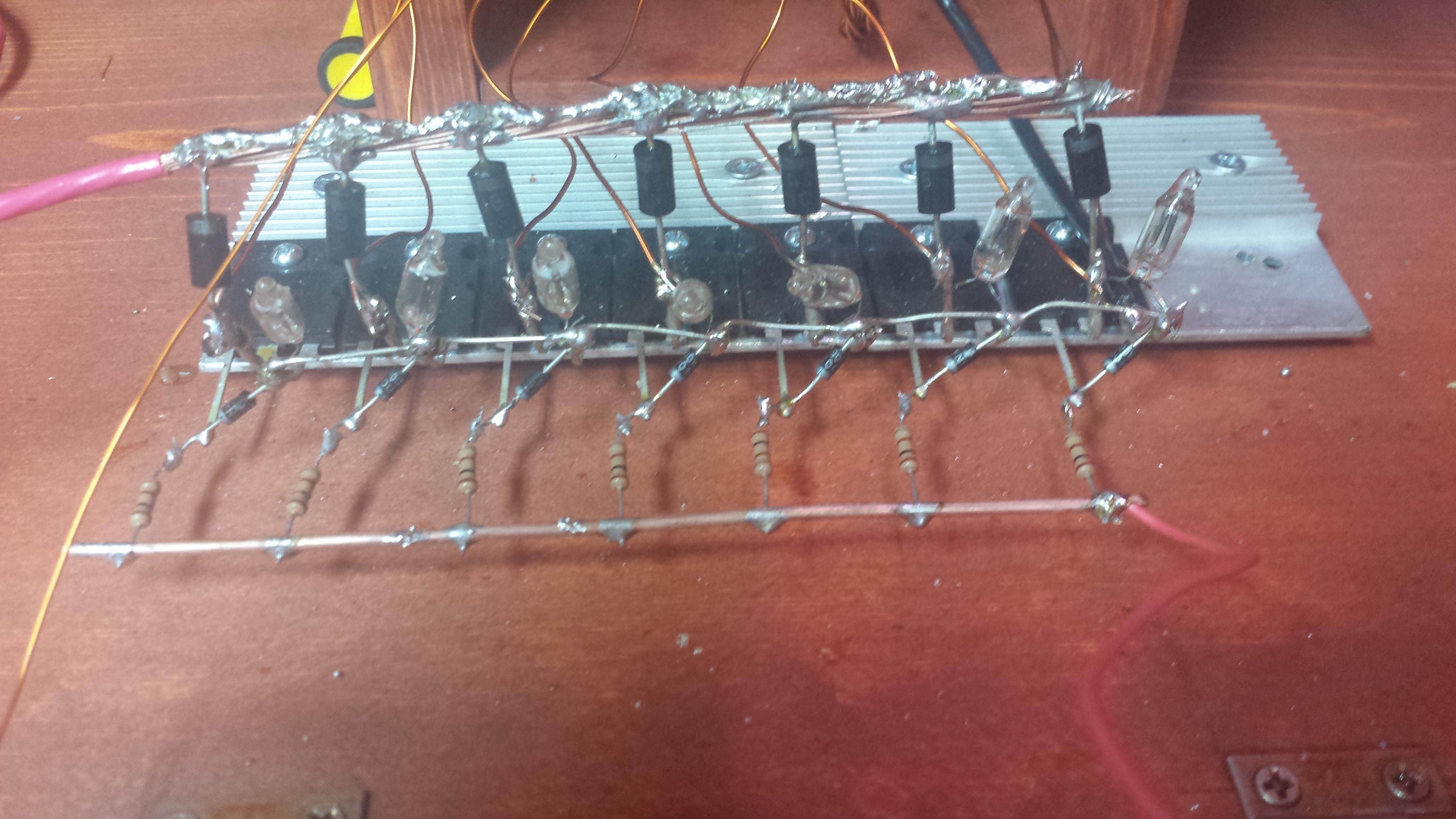

I replaced all the 470 Ohm resistors with 100 Ohm resistors, I added a 22 Ohm resistor inline with the pot (Im still using the 1k wire-wound pot).
At the moment, I am hoping to de-sulfate an old lawnmower battery. It holds around 5-6 volts, and will take a charge up to 13 volts, but after disconnecting from a standard charger it quickly falls back to around 5-6 volts (takes about an hour).

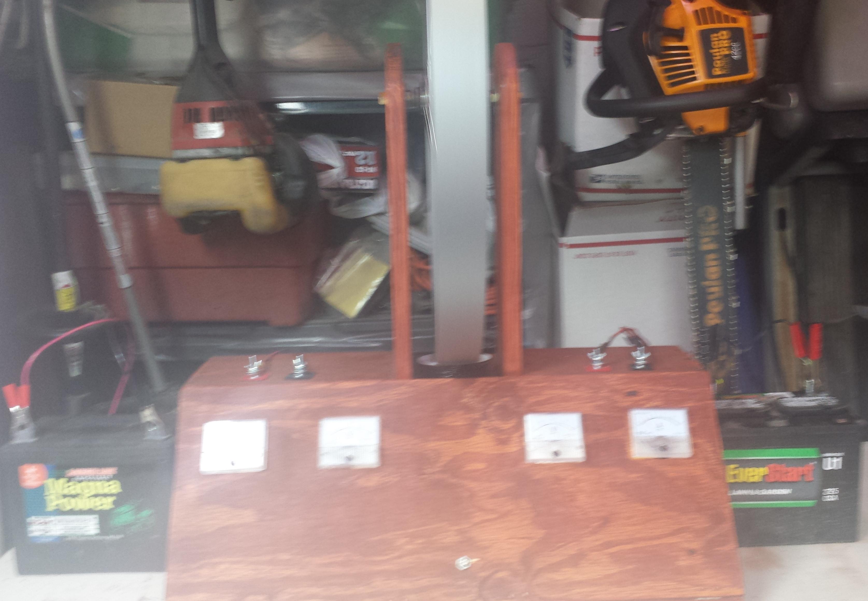

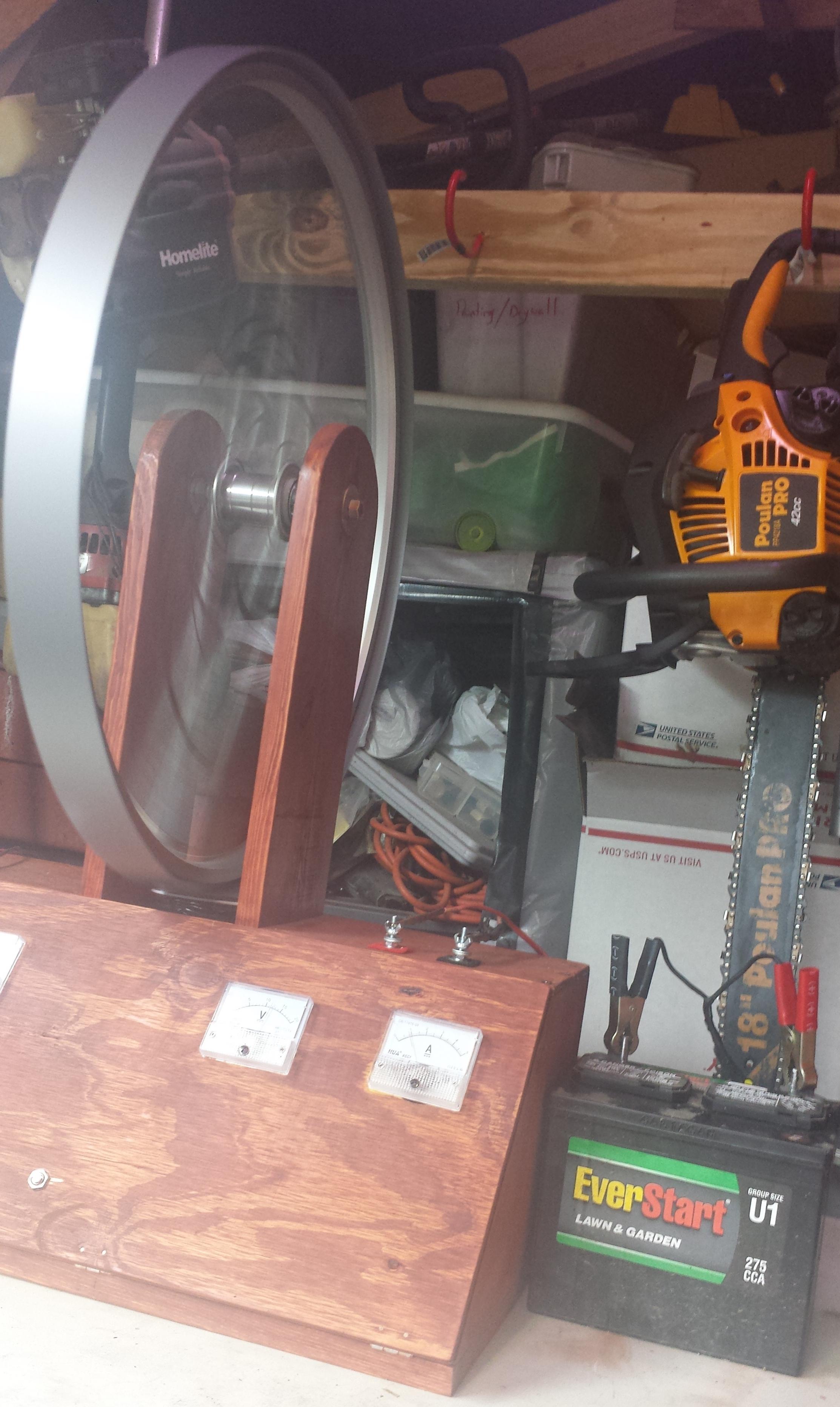

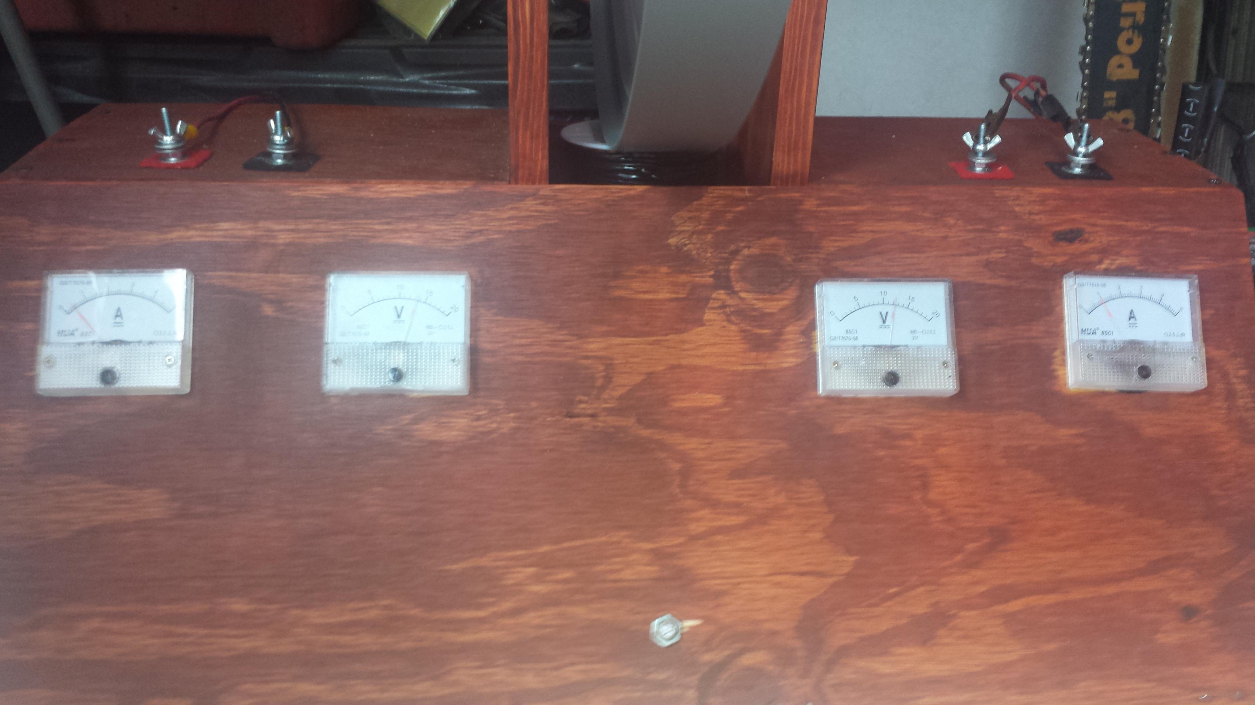

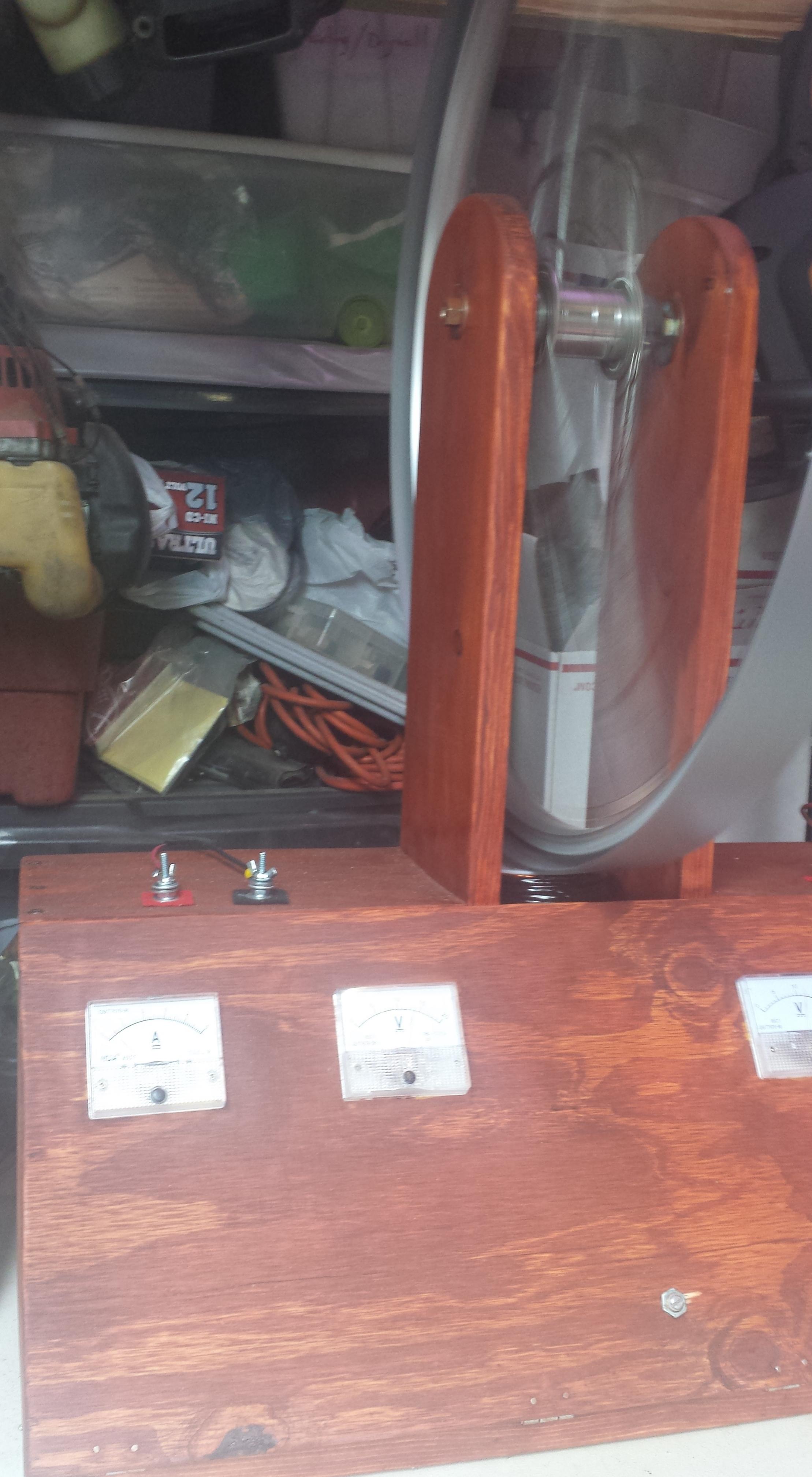

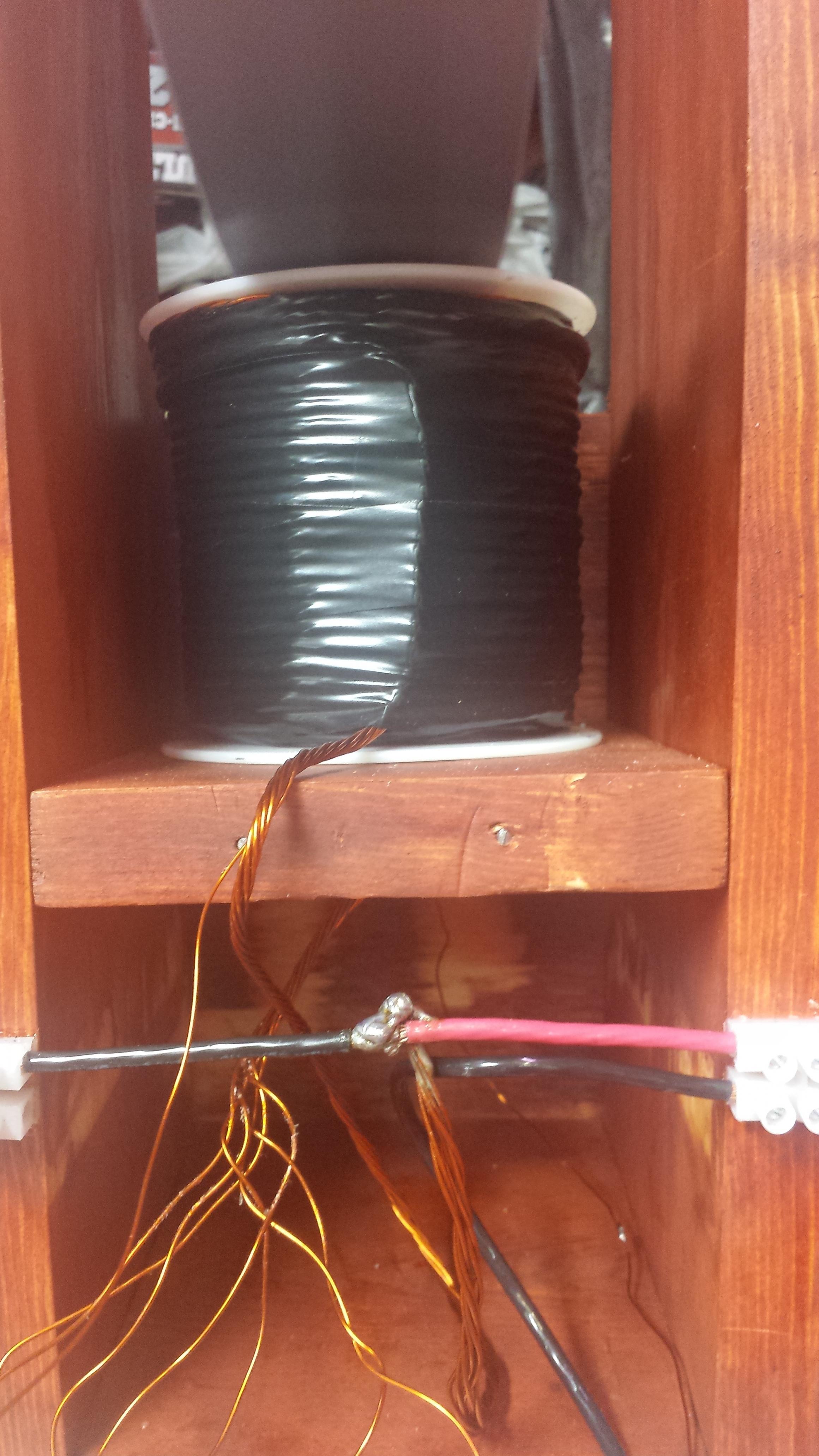

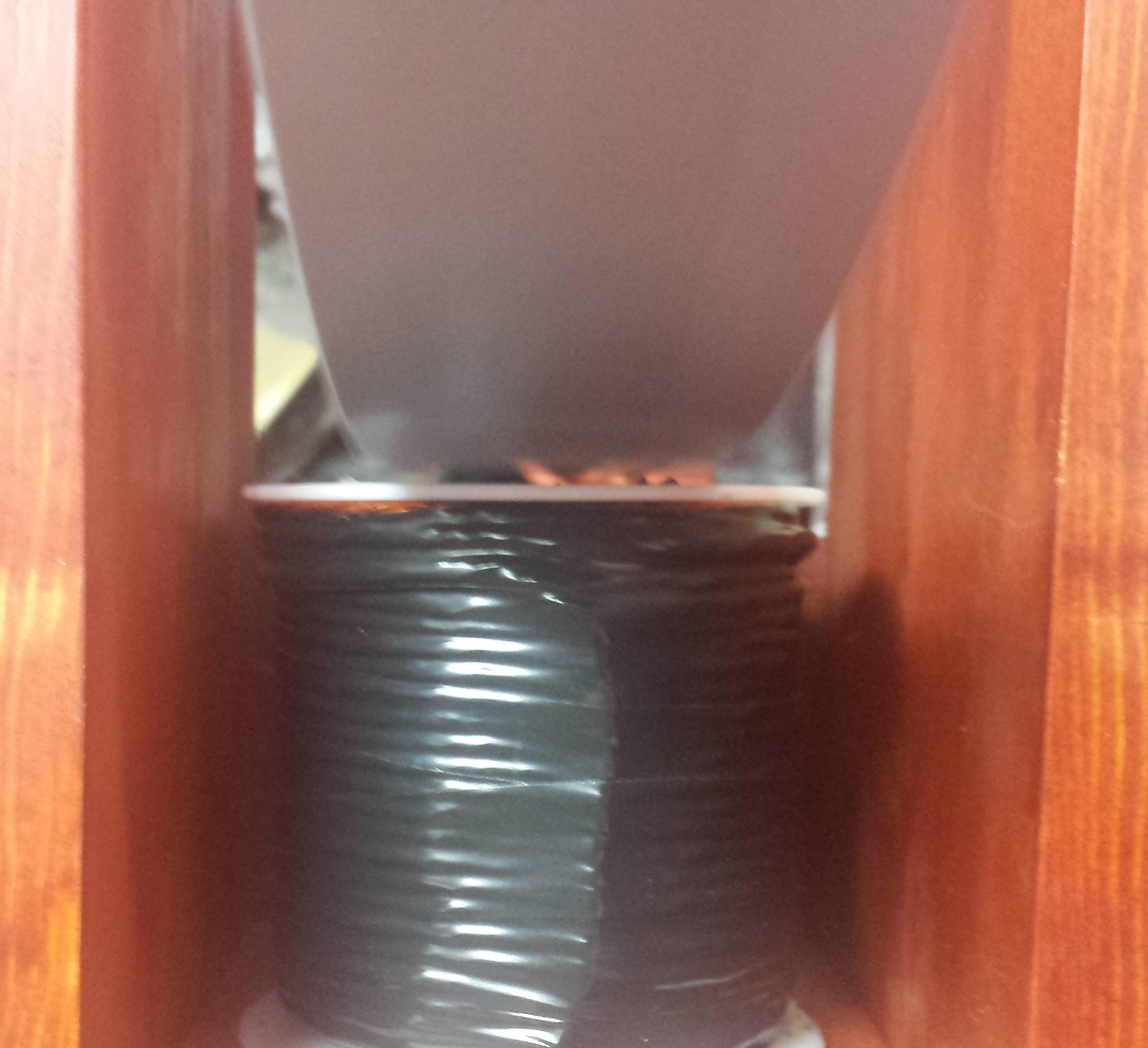

Here's some pics of the machine... I know the solder-work is sloppy, but hey, Its working!!! The machine was running when I took the pics... I have to make 2 posts to get all the pics in. (Only allows 5 per post)
