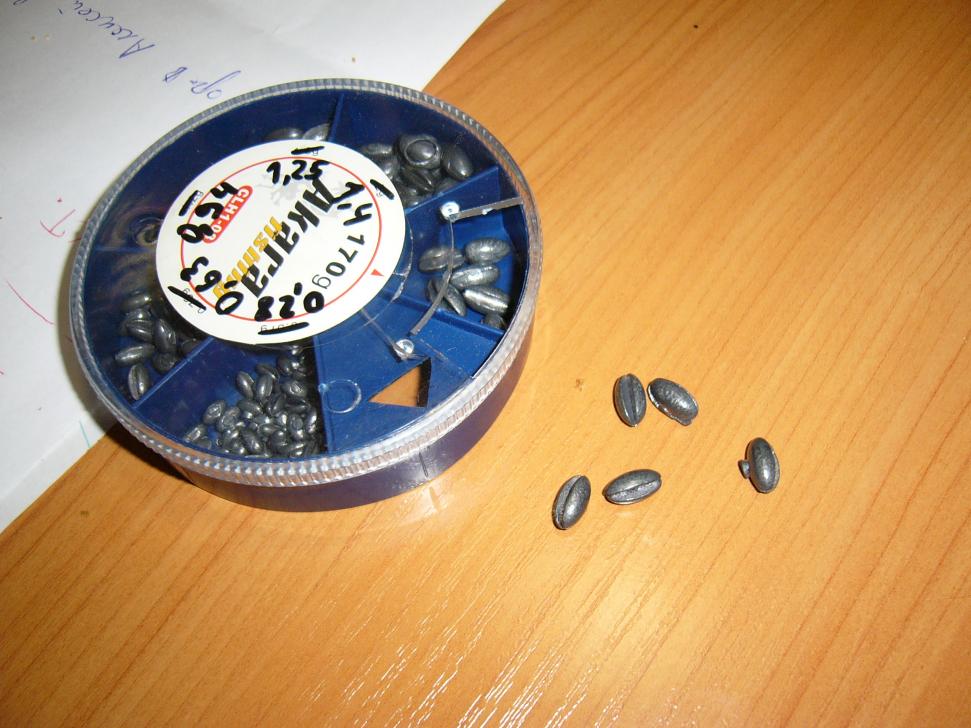

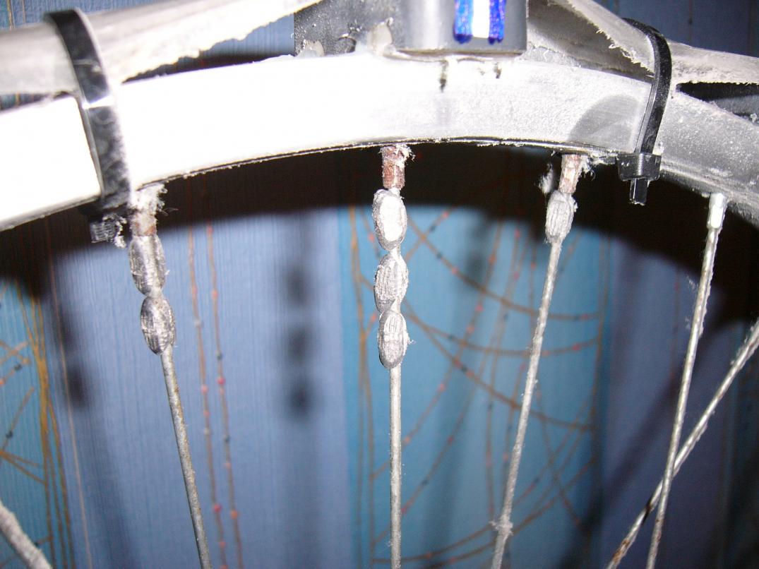

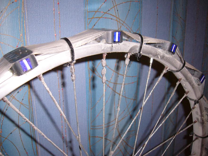

Give your wheel a big spin - hard as you can - & wait for it to come to a complete stop after all the rocking has finished. Mark the top of the wheel, on the wheel, against a fixed position or another mark on your SSG. This mark should be at the very top or Top Dead Centre of the wheel. Repeat the process, adding a real big blob of glue (possibly with some other heavy non-ferrous material mixed in it, like brass) at this point should it come up to the mark again. Keep repeating the process with progressively smaller blobs of glue (I used - you guessed it - Liquid Nails, mostly on its own, because it's very tacky & the wheel can be spun immediately after it has been applied without it coming off), until your wheel never comes to rest in the same place twice. You can expect the whole process to take around six or so hours, so find something else to do whilst the wheel is spinning or you might be driven insane watching a spinning wheel. Liquid Nails takes about a week to dry to its full strength, so re-balance your wheel using the same procedure after about a week to check it at least. My builds never needed this, maybe due to the even-ness of blob placement, but it pays to check. Now time it from when you stop spinning it until it comes to rest. Congratulations on breaking the eight point five minute "glass ceiling"!
