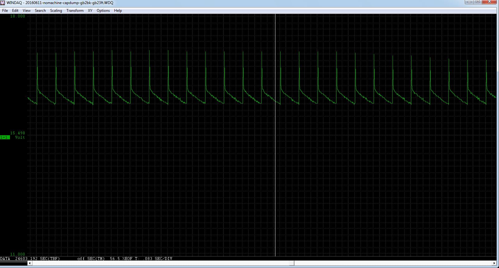

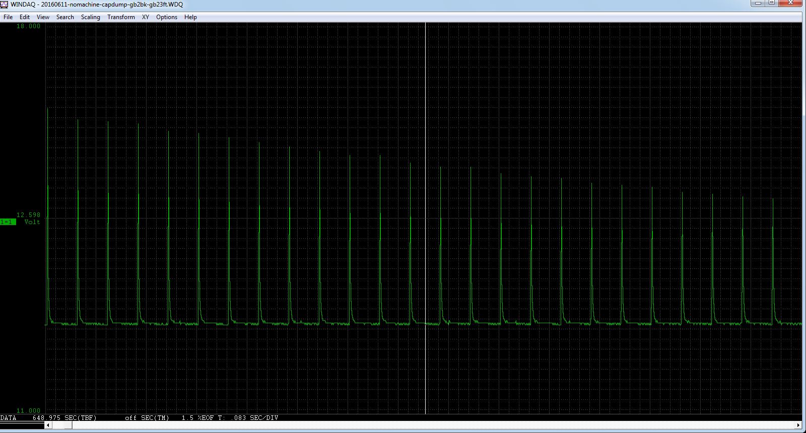

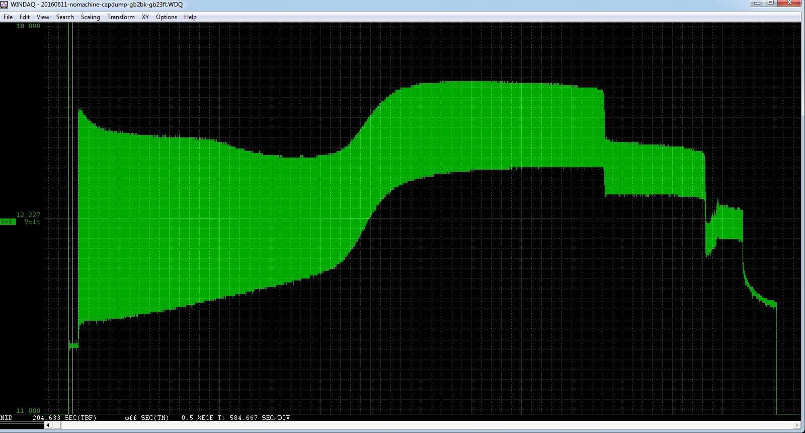

I will explain a little in text though. What this video is showing is some of the parameters that should be considered when setting up a cap dump.

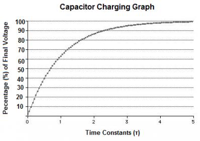

First I consider the "punch" to the battery. This can be affected by on-time of your dump period, the size of the caps you choose, of course the target battery size is also a factor.
The frequency of the dump should also be considered. Your desired current draw (higher/lower) will be affected greatly by this. The "rest" between dumps is what we are talking about here, 1 sec, half sec, quarter sec, and so on. The over all effectiveness of your charging will depend a lot on the frequency you choose. Too fast and you will waste energy but too slow and you will not get the charge battery up to where it needs to be.

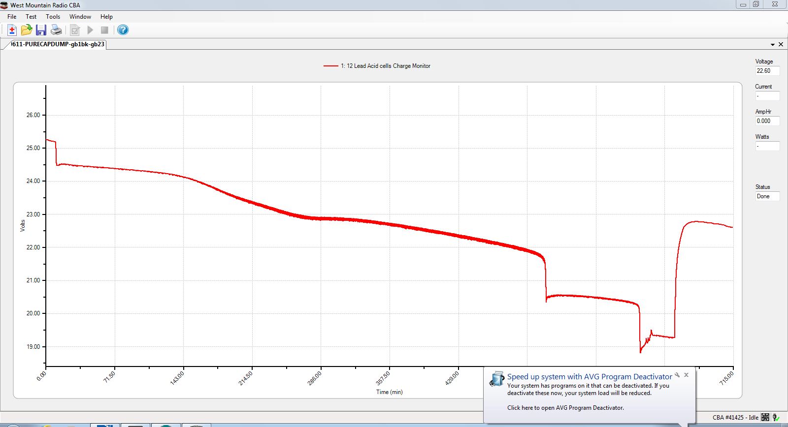

I am going to make a chart of a fuller run at this but I wanted to show all the adjustments in this video prior to doing an untouched one. In other words I don't want to mess around with the one coming up.
