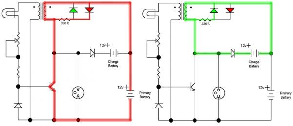

Originally posted by kingstingtin View PostI connected the LED under the scheme: [ATTACH=CONFIG]1377[/ATTACH] My device works in a mode repulsion. This means that the red LED lights up when placing a magnet on top of core? Magnet should be exactly in the center of the core, or have small tolerances?
I'm not sure about which colour LED lights up when, I only use one LED and swap the connections to see either the coil on time or off time as needed. I'll check mine tonight and let you know.
Originally posted by alfinip2000 View Postsorry to interuptcan someone please tell me repulsion and attraction mode..my superpole light LED exactly after pass the centre..i cant get in the between magnet like John K youtube on timing. even on my sweetspot..TIA
cheers,
Alfin
I recommend you read through this thread which talks about attraction and repulsion modes Complete Bedini SG Book!
