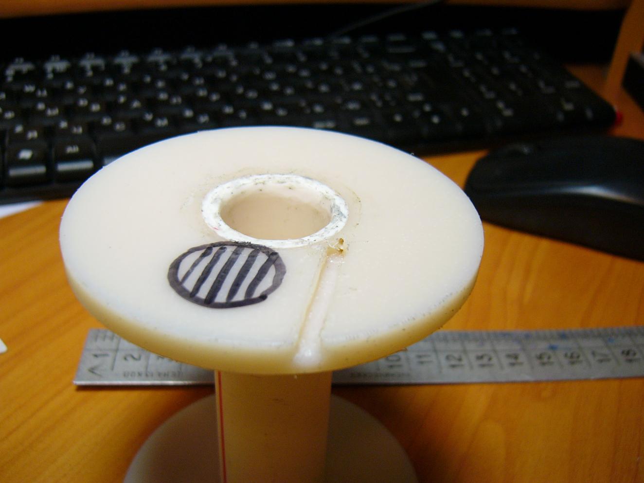

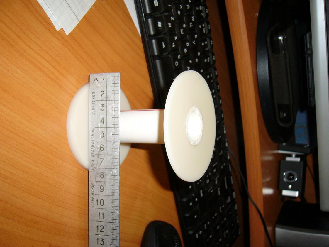

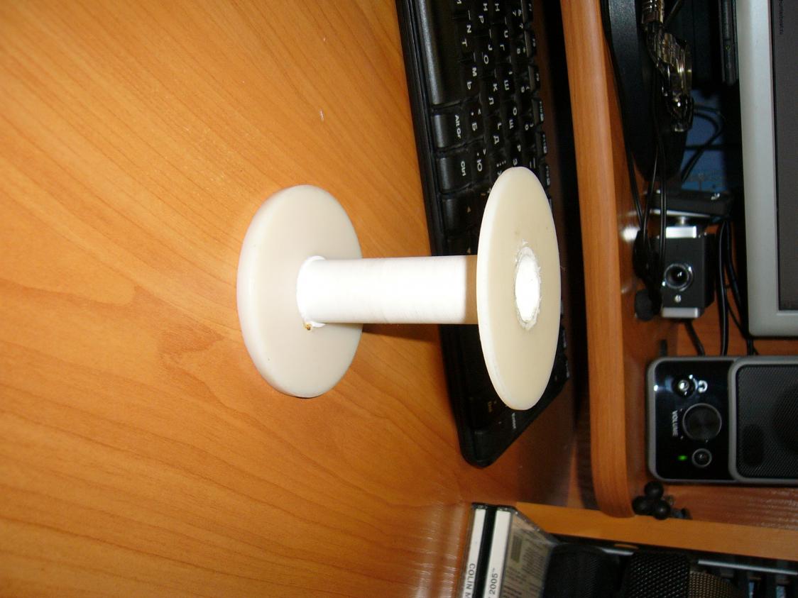

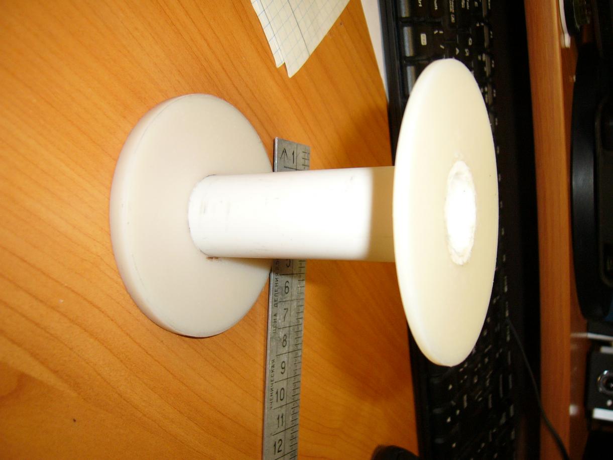

Now I made a new brake coil body. This time, I tried to keep the size specified in the manual. Height of 3 inches (75 mm) and a diameter of 3 inches (75 mm) hole for the core a little more than 3/4 inch (20mm). I also made a wind-holes in the bottom of the spool.
Next week should bring the wires (#25 and #23). Of 50 meters each (about 160 feet, with a margin).
