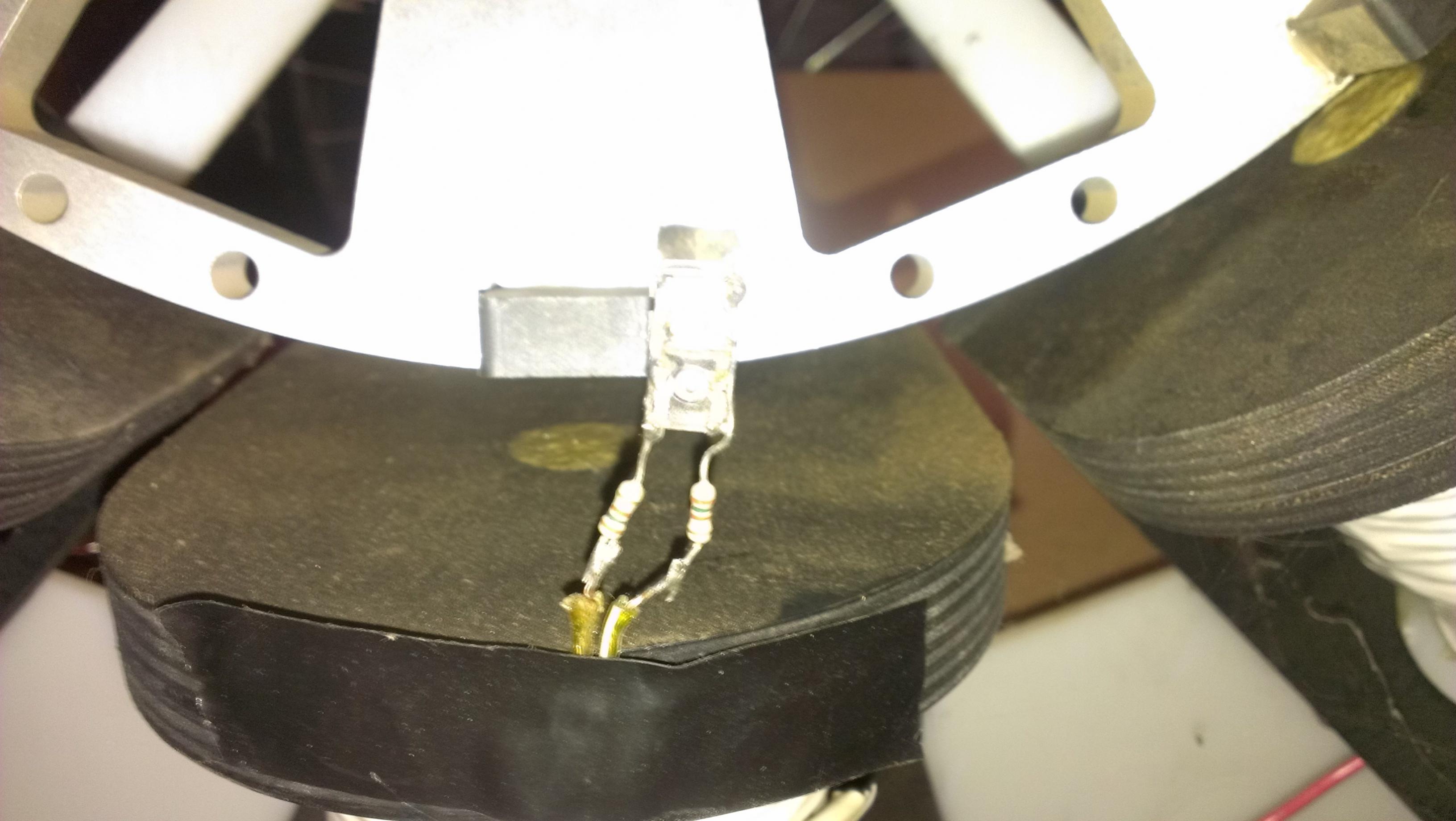

You asked about the timing light I showed. If you want to make one it is very simple. Get two led's one red and one blue. Connect them in opposite polarity to each other. I prefer the little square high power LED's sometimes called piranha, like the fish (any led's will do though). Get two 150 Ohm resistors and use those for the legs then attach some wire with clips on the other end. You want to be able to clip it on to check but unclip it while running most of the time so it doesn't steal from your circuit. See picture for what I'm describing.
This picture shows the light. There are no marks on the magnet because I had only temporarily put this on a machine to see the width of my on time.
This connects across the coil. You can check your trigger coil or your power coil with it, in either case just connect one side to the top of the coil and the other to the bottom. The reason for two LED's in opposite directions is because your coils charge one way and discharge the other so with the led's you can see and time both. You will want to put timing marks on your magnets at the center line so that you can see where your firing in relation to the coil and also how many spikes per pass.
