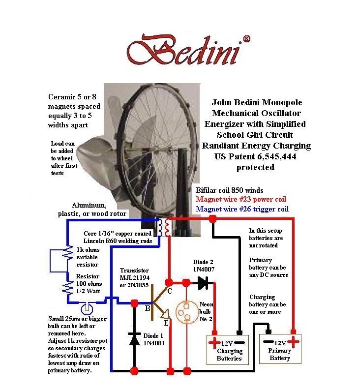

    1. Never use a heavy Rotor for SSG/SG (SSG/SG is a NOT a Torque motor it is Speed Motor per weight of the rotor)
    2. You must have 450 Turns for the gauge of wires you used for the Bifilar coils.
    3. It looks like every thing other than your Transistor has gone bad. change it and you may have it running again.
    4. Type of Magnet really doesn't matter, Yes Ceramics are recommended since these will not saturate your core. Neos will.
    5. Repulsion mode is more efficient than the Attraction mode but they both have an advantage when used together in a Dual Mode configuration.
    6. Finally, have the pot setting done from lower value to higher value once you get continuous spinning and arrive at a sweet spot with maximum speed for least current draw.
    There is no reason why you shouldn't be getting it running with all these above points taken care of.
      The coil doesn't want to repel the magnets on my rotor, it seems to attract them instead.
      Attraction is better anyway but if you want repulsion then simply reverse your polarity on the coil, either way will run though. Put your "tops" where your "bottoms" are now and the bottoms where the tops are. It's an electromagnet so your direction of current flow matters for the magnetic field it will produce. This is a common issue and results from the direction you wind the coil when you make it.
      You may have to reverse your trigger or maybe not depending on how it is currently configured. The base of the transistor will fire on the Positive side of the wave that is inducted to the trigger so you want your polarity on the trigger correct or the timing will be off. Most people do not notice but look closesly at the diagram and note that the trigger is in reverse polarity compared to the power winding.

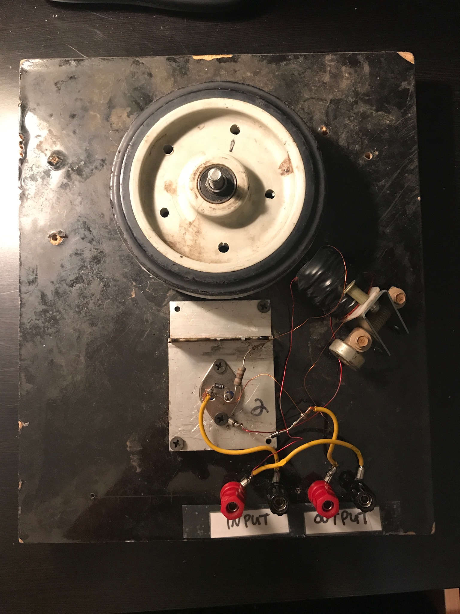

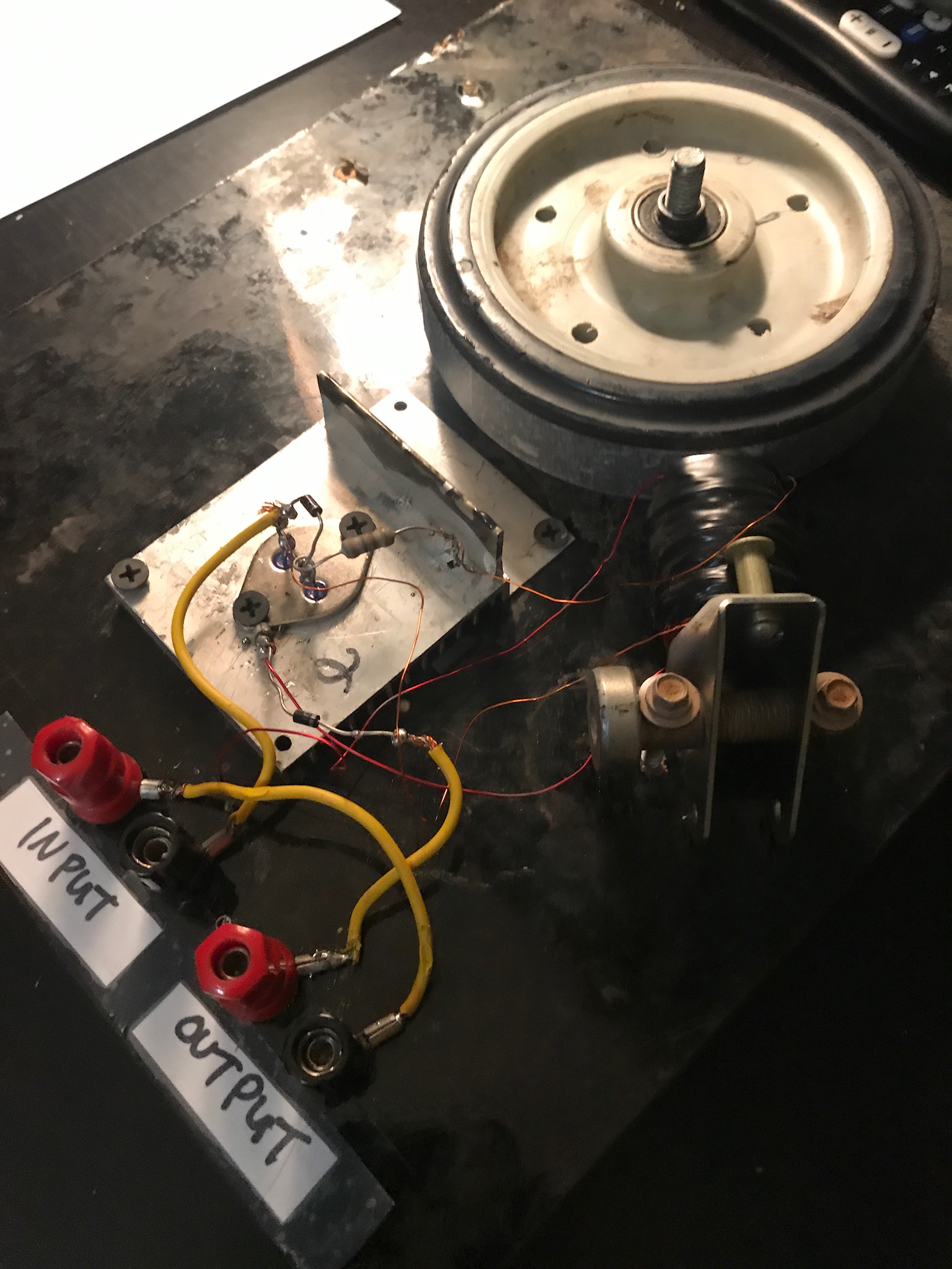

                  Well I guess it isn't fried. I hooked it up this morning and it's working fine now. Here's my setup. I don't even have a neon on this circuit because it's on my other setup with the bike wheel at my shop. This setup in the pictures is a lot smaller so it's more convenient to experiment with at the house. This is the one I'm using currently. I just make sure I have the charging battery hooked up before I hook up the primary battery. I'm going to order a couple neons tonight as well as some other components. When I tune this thing, where do I hook my DMM leads to so I can check the current draw? I have the potentiometer but I just need to wire it in.
                  I also want to experiment with a basic cap dump circuit so I can actually get a positive charge and use the batteries that I charge. Charging them with negative is basically pointless other than to run tests and get a feel for the way the machine works, correct? For now I want to just charge small lead acid batteries, so would I need to make a trifilar coil? I wind two windings together and then go over them with the 3rd winding, or do I wind all 3 together at the same time? I have about 1000 ft of 23 magnet wire. I also have about 600 ft of 18. Should I do it with the 23 first until I am familiar with the circuit? I will probably use the bigger coil spool for the trifilar, or will this small one work? Eventually I would like to charge my deep cycle 12v I use for my solar panel at my shop. I think a cell has gone bad. If I wind a 18 age trifilar on the 3" spool, will this do anything useful to that battery?
                  What components and circuit is better to start out with for the cap dump? I know there's one that has the 555 timer, another with the FWBR and SCR, another with the mechanical commutator. Should I start with the FWBR and SCR first? Can anyone give me a component list with part numbers? I would like to learn how to tune my current device and once that is done I wish to experiment on the next level. I have all 3 books, but it looks pretty costly for all 8 circuits on that machine. Besides, if I'm going to have an 8 strand coil, I might as well go with the 18 instead of the 20 like it has in the book.

                        circuit looks to be hooked up correctly...
