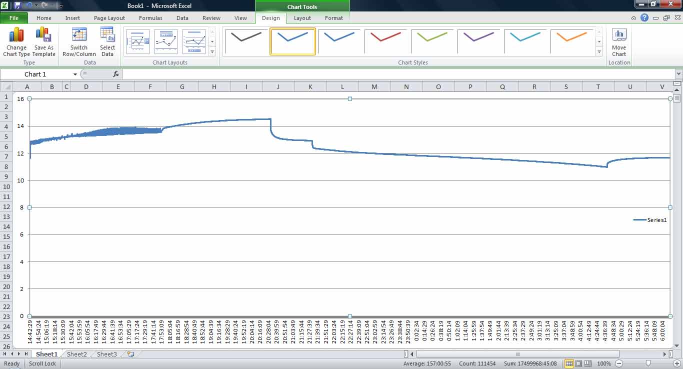

                    Here is my small Alum battery conversion.
                    7.5Ah battery was cycled for 2 years w/ the normal acid. starting to show signs of degradation and build up on the plates as well as on the bottom of the case where lead falls and eventually shorts out the plates. I purchased the battery brand new w/ no acid. Charge discharge once or twice a week.
                    I purchased some alum while shopping for nuts and candy http://www.nuts.com/ no idea if it has the elements we need or are looking for here.
                    so I tried draining all the acid and could not get it all out, my best guess is about 2-3% remained and whatever was soaked up between the plates.
                    I boiled some distilled water and in a separate room temp pyrex bowl, I added one part water and one part alum. I mixed until clear then added another part alum mixed until clear then added another, at this point the mix would not clear nore would all the alum dissolve
                    so that's 3 alum to 1 water.
                    I added the alum water mix to the battery using a pipet making sure to get only the mix at the top while the undissolved tiny bits of alum remained at the bottom of the mixing bowel.
                    after filling the battery, it had a standing 12.5ish volts. I had charged it prior to dumping the acid.
                    I preceded to charge it w/ a Zap battery charger a friend gave me - it uses a cap discharge method. it dumps a large cap of low voltage 14/15volts across the battery. the plates started to form crystals immediately. In fact I could see the entire chamber filling with crystals and looking like it would become solid as most of my other crystal batteries have done as well.
                    at the end of the charge cycle it was looking 70-80% (guessing) solid. I proceeded to discharge using 7.2 watts (600mA) for a few hours.
                    At the end of the discharge cycle, the mixture was 100% liquid again. And now after many cycles there is a thin coating of crystals remaining on the plates at all times.
                    here is one of the recent charge discharge cycles:
                    the first charge you see is using the Zap charger, this charger only goes to about 13.7 volts +/-
                    the second charging you see is on a solid state CPD mod'd aluminum coil energizer.
                    I only take it to 14.5V in this pic.
                    The discharge is at 7.2 watts (600mA).
                    I do all these runs in the garage where the temp has been fluctuating between 30-50 degrees .
                    My leftover alum mix is in a jar and remains a milky very thick liquid, I recently grabbed a little bit of it warmed it up in a microwave to get it more liquidy to make a small copper/magnesium battery after pouring it cooled completely solid...
                    Peace,
                    Patrick
                      SO you charged it till 8:30pm, rest till 9:30pm (bedtime for the kids ) discharge till 4:30 am (no sleep for patrick) and then let it come back up a little. So you are roughly pulling 2.5 amps for 7 hours in a 7.5 am hour battery. Looks like a winner. Nice! I do not think I have that concentrated of a mix, maybe I should thicken it up some more before I dump it in my next batteries. I mixed until I saw sediment stay, but I wasn't boiling it, just heated it up. Aln
                        thanks for pointing that out Al,
                        I should not do the maths on the fly in the AM (too old now for simple arithmetic) :-)
                        That was charging at about 3.6 watts (300mA) at the peak draw and discharging at about 7.2 watts (600mA)
                        I should get another amp meter to track the amp draw on the discharge so I don't have to think about it. Also, the amp draw changes as time goes.
