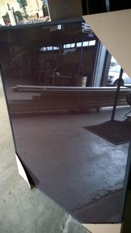

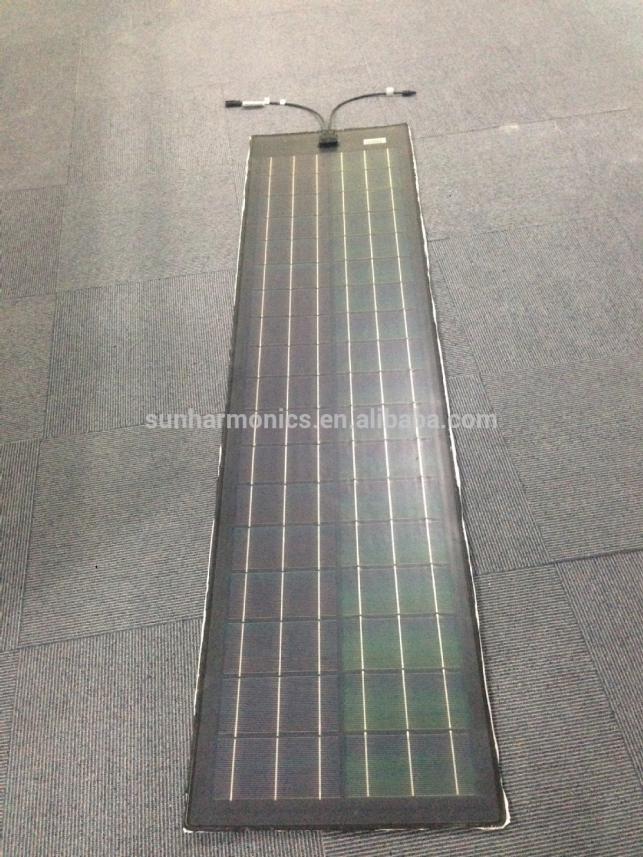

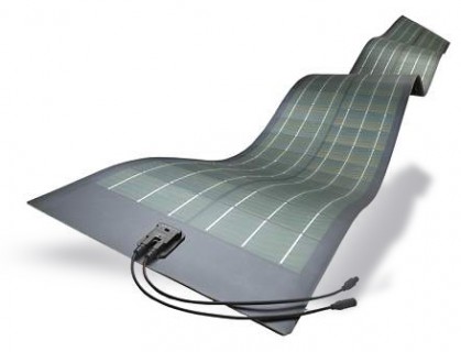

Frustratingly a panel showed up that looked ideal for 24V made by a US company... That company NanoSolar is now gone... Probably shouldn't have posted that, sorry folks
NS 100 B
Peak nominal power (Pmp or pW) 220.00 (W)
Voltage at nominal power (Vmp) 37.00 (V)
Current at nominal power (Imp) 6.00 (A)
Open-circuit voltage, Voc 47.40 (V)
Short-circuit current, Isc 7.20 (A)
Maximum System voltage, Vsys 1000 (V DC)
