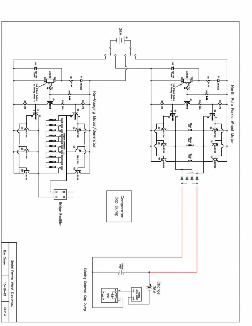

                  Originally posted by AlvaroHN View Post
                  I have an issue with the idea about running a ssg circuit, and send the recovery to a cap that would be the source for a bedini-cole circuit in the same rotor.

                            Patrick, can you tell me how it was connected? I do know that it was a bedini-cole with all 6 coils in series, but I don't know any more than that.
                            Alvaro
                            • #44
                              Alvaro
                              I just found this: http://www.energyscienceforum.com/at...9&d=1409348374 posted by you in the ferris wheel thread
                              So I see that in the ferris wheel when the hub motor part is off there is no battery seen by the circuit,… and the problem that I have is that when the cap feeding my bedini-cole circuit is below the volts generated by the power coil the energy flows back through the transistors, so I just need a switch to isolate the cap until its voltage is higher than the generated by the power coils, and let it fire there like a big punch.
                              Maybe the comparator cap dump circuit can do the job... SSG --> comparator --> bedini-cole -- > some thing else
                              Alvaro
