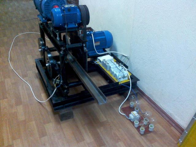

        This is the Russian Design working on Romos Technology
        This is the Indian Company Design, and i think they also used the same 80Kg weight or more in this image ...

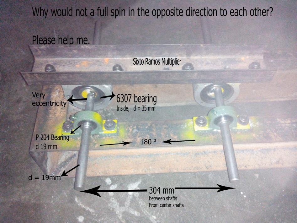

            I have 4 bearings P 204, Inside diameter d= 19= mm, 2 shafts diameter d= 19 mm length500mm & 2 bearings 6307 Inside diameter d=35mm. it's very eccentricity. Length between shafts from centers is 304 mm. Look the images. Why would not full spin in the opposite direction to each other. Please help me.

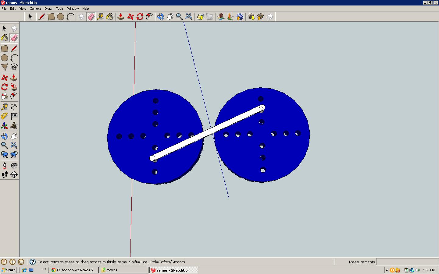

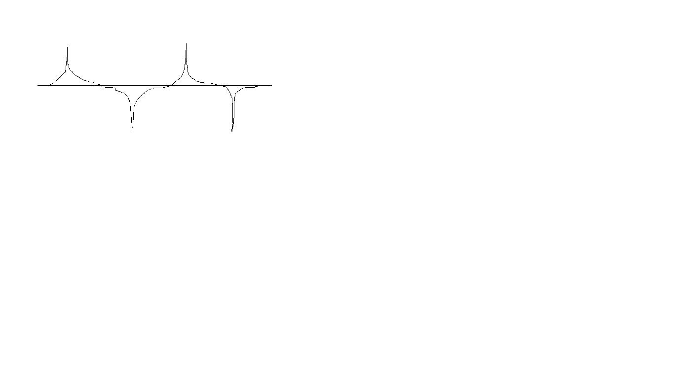

              I have been intrigued by this machine for a while now and finally got around to studying it. the first thing i did was break down the rotation into 45 degree steps to see the reaction of the linkages throughout rotation. The first thing that hit me was that this thing creates a "torque impulse". If you start like the pic i posted and think of the left wheel being the drive. at this position there is a maximum relationship between the drive and load...the ability of the drive to pull the load (since it is going clockwise) and the ability of the load to impede the drive are at maximum. if you proceed from 0 degrees to 90 going clockwise on the drive, because the force goes from tangential to perpendicular on the drive and load the torque or leverage on the linkage would fall and rise in an exponential fashion causing an impulse instead of a constant connection . If you mapped the torque from drive to load it would look like the second picture. As we have all learned with electricity impulses cause weird things to happen. along with the torque being an impulse...the low torque angles also allow the drive to speed up unimpeded adding the momentum to the flywheel then during the high torque angles transfers the flywheel momentum plus the torque impulse to the load.

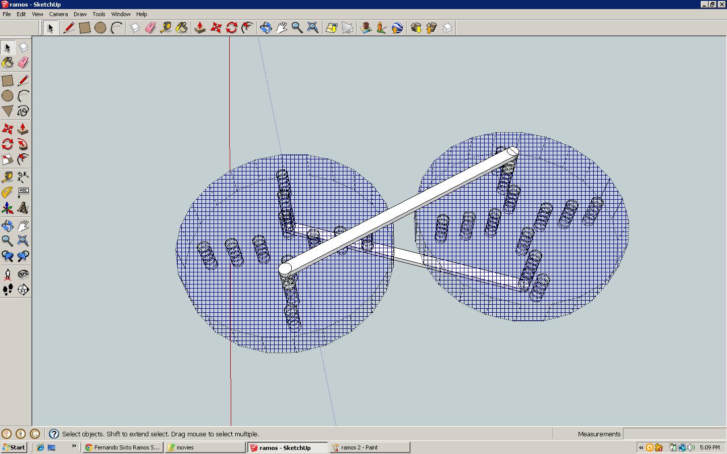

              The second thought was about all the wasted energy caused by the shaking. especially if you are supposed to add an inverted pendulum to assist the roation. the easiest way to stop the shaking would be to put a counterbalance of some sort. but instead of just putting a weight I came up with a way to put another linkage on the opposite side so that you could have two inverted pendulums that would assist rotation as desribed in the original invention but because they would move in opposite unison they would cancel out the shaking (if balanced equally). It will be tricky to mount the gears this way because a shaft would interfere with the linkages but i have two options i am working on to make it work.Click image for larger version

              realized the design i posted is technically wrong. the connecting bar would not be at 0 degrees on one wheel and 180 on the other...it is supposed to be long enough to go from one 0 on one wheel to 0 degrees on the other and when swapped the the counter roatation would be at different angles relative to there respective gears.
