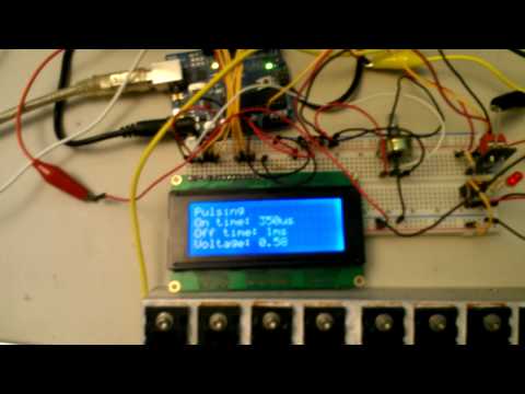

              I uploaded a video showing the basic wiring of the 8 circuit SSG board:
              Solid State Arduino 8 Circuit Bedini SSG Wiring - YouTube
              And one of the oscilloscope output:
              Solid State Arduino 8 Circuit Bedini SSG Scope Shot - YouTube
              I will post some more when I get a cap dump circuit working. I am also going to setup voltage monitoring on input battery, cap bank, and output battery.
                Here is another video with simple cap pulse discharge.
                  Bluestix,
                  What made you decide to run the coil with the core in it? would love to see the performance inprove if you got rid of all those TINY wires and alligator clips. Great build thanks for sharing!!
                    Bluestix,
                    I just haven't taken the core out of the coil yet. I am going to do that next and see if I can increase the pulse frequency.
                    Now that I have a working prototype I am going to put together a better version with all soldered and bolted connections using shorter wires. Also going to hook up the earth ground. I am going to try putting a few more capacitors in parallel too.
                    Thanks for the help.
                      Bluestix,
                      I removed the core and it runs much better. It's quieter and I can run it much faster. It's running about 750hz now.
