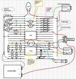

                        • I have been building one of the Beck's blood electrifiers but am not clear on how the electrodes need to be wired. Per the updated schematics using the LM358, how do the 3.5mm jack electrodes need to be wired?
                          Thanks for any forthcoming help.

                            Christian,
                            The only difference between 3 and one battery version is additional circuit around IC7660 which raises voltage from 9 to slightly over 30V. LM358 circuit is all the same as well as connections to the output socket. 3.5mm socket has three terminals; one is the outer or a "collar", and remaining two are normally connected together inside. Once you insert a plug, one of them will be pushed away and separated. You can check this with Ohm meter or small bulb in series with a battery which will make a conductivity tester. Now, the outer terminal which is usually closest to the front of the socket connects to the potentiometer (outer terminal shorted with a center one). When you hold potentiometer so you're looking at its back and terminals are up than left and center legs are connected and wired to the socket, as above. This order is necessary so adjusting pulse amplitude will be done same way as per any audio equipment; clockwise - louder.
                            When you determine which remaining terminal is connected to the tip of inserted plug, run the wire from this terminal to the 22uF capacitor. Last terminal should be connected to the join point when pin 1,6, 2.4M and 150k resistors meet.
                            • Thanks for the reply, Vtech. Unfortunately, that did not answer my question.
                              I've got the 3.5mm jack wired up as you described (per the attached diagram), though being from the audio industry, I say Tip-Ring-Sleeve for a stereo plug. What I am trying to comprehend is how the TRS 3 connections need to be wired to the 2 stainless steel electrodes while returning to the correct locations. As I am making the cables from the jack to the stainless electrodes, I am unsure of how the electrodes need to be wired into the cable.
                              Sorry if that wasn't clear before...and I hope it is now.

                              • Ok, I follow you now. Since the pulse being sent is bi phasic, changing polarity, it doesn't matter which electrodes connects to the tip or sleeve. Soldering wire to the stainless electrode will not work. In my very first prototype I used small double terminal block - https://ultimachine.com/sites/defaul...gableGreen.jpg and two U bent pieces of SS welding wire. Later, I used flat pieces of thin SS strips and I rolled their ends to fit smaller female terminal. I just soldered cable to the other end and used heat shrink tubing to insulate all metal connections.
                                Now I use carbon fiber gel pads instead and cables with prongs designed for any medical pads. I buy sets with 2.5 and 3.5mm plugs already on. There are also platinum pads available but more expensive.
