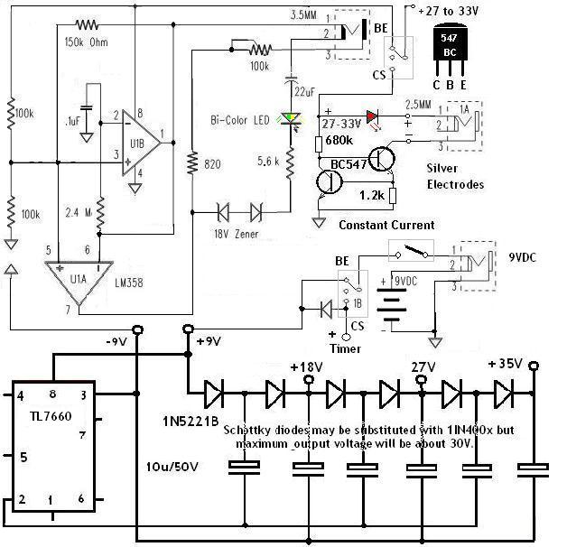

  • Mr.Algorythm the updated new schematic pic is very hazy. The previous one was much more clear.Please make the new updated schematic pic clear as the previous one .
    • Updated but this is as big as it gets. If this last one isn't good for you I can't do anything better...

                • Hi silenroc, Both diagrams are in post 215 and the current limiter circuit has been posted as well. Schematics below is the one I use for assembling my units.
Name:	BeckSchematic w CC Rev1.JPG
