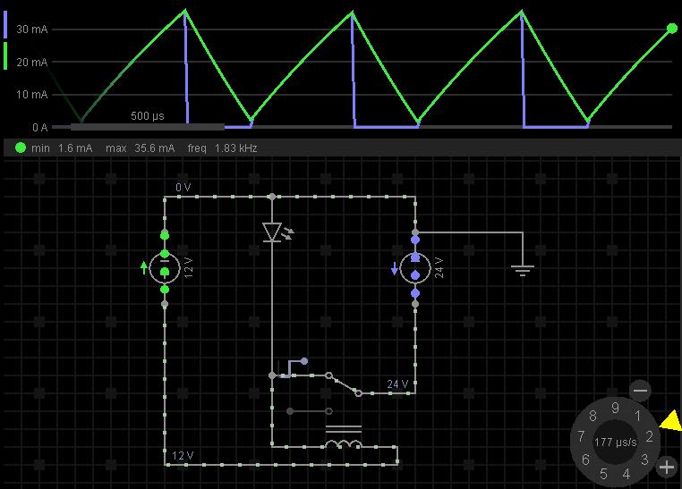

    what I have running right now came from a desire to build something that uses normal current charging along with radiant charging. I wanted a system that would pulse normal current then radiant in alternating pulses. I have used two AA batteries to charge 4 AA batteries a few times now so without hard data (working on an arduino batt logger for hard data) it apears to be a %200 system witch is also backed up by simulations.
    In the simulation i used a self triggered relay as the switch and the inductor but in reality I am using a reed switch and a coil running a low friction flywheel with magnets. the way I am using it is this...two run batteries are in series pushing current through an inductor and then through one inverse charge battery (like a tesla switch). because I am using two to one for instance (24v run and 12 volt charge) it leaves one battery of potential accross the coil. the current simultaneously charges the coils inductance and the inverse battery with forward "normal" current. once the switch disconnects the diode allows the coil current to continue to discharge through the inverse battery "radiant" style. in the ciruit simulation you can see that the source ramps upward to the peak then shuts off while the current continues on and ramps down due to the coil inductance...giving the seeming 2 to 1. I have not tried a transistor version or anything other than the reed switch setup I have now but as a stated I have ran it a few times (3-4) and it appears to do just as the simulations show...I charge about twice as many batteries as I am using to run it...sometimes only 3 because of the losses in the motor section. I do know that a voltage on a battery does not prove anything so as I stated I am currently working on an arduino data logger for the batteries so I can track the charge/discharge and also be able to drain the batteries through a known resistance and log that to figure the capacity and get all the hard data...but at the moment I am just able to run it and watch batteries charge...but so far it looks promising and I have never seen a system that used both normal current and the inductive kickback from a coil in one system so i decided to share so all you smart people can make it better or try it out.
Name:	2 to 1.jpg

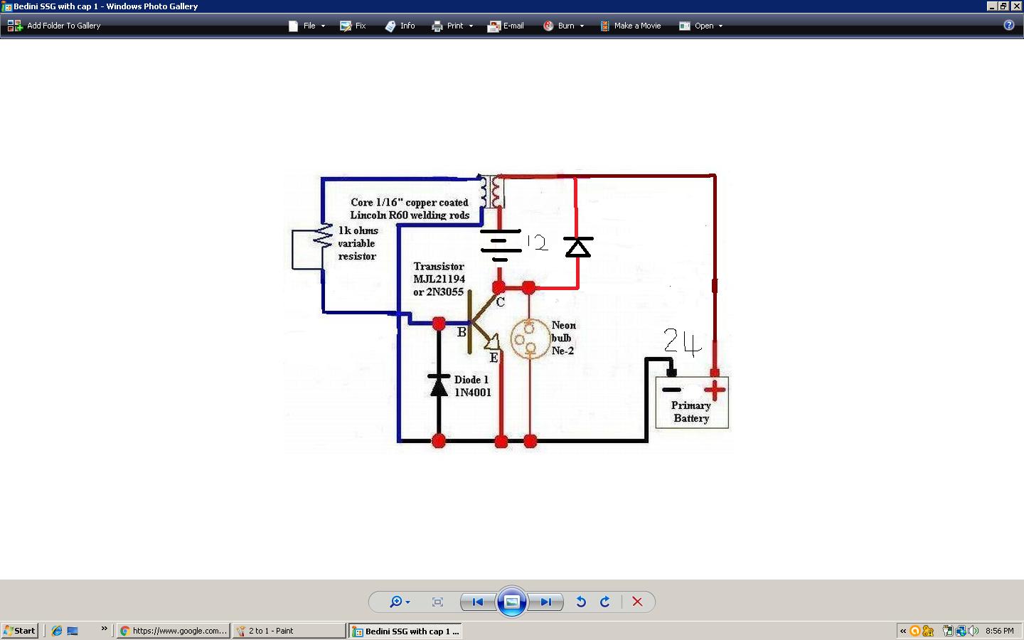

    it would also be really simple to change an sg into this type of configuration to see what differences it has.Click image for larger version
Name:	2 to 1 sg.jpg

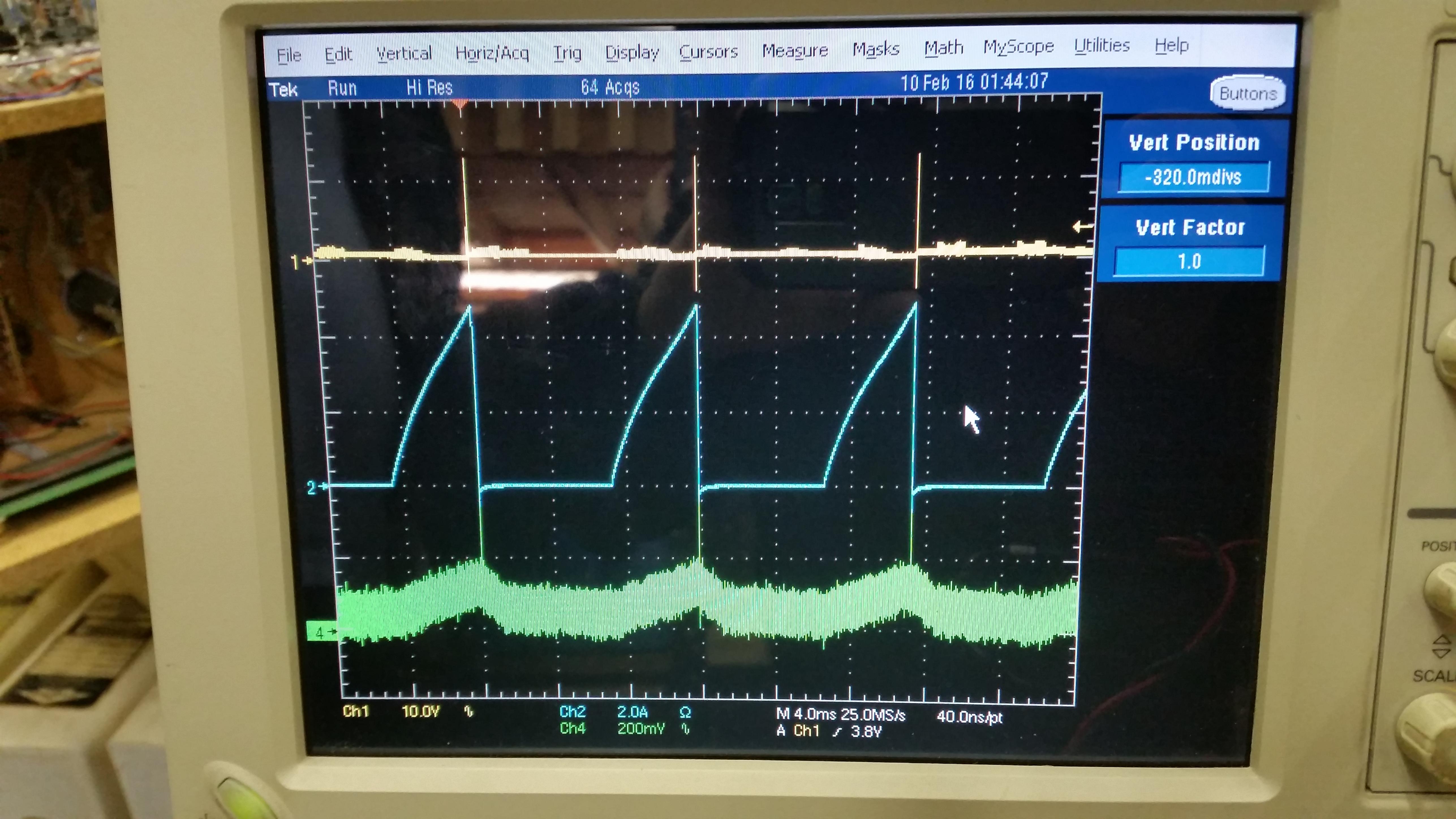

      Here is a scope shot for quite a few weeks ago of an almost identical schematic I've been testing at Graham Gunderson's lab.
      The bottom green you can see the charging battery receiving the current pulse and then the spike.
      It makes one hell of a charger, that's for sure.

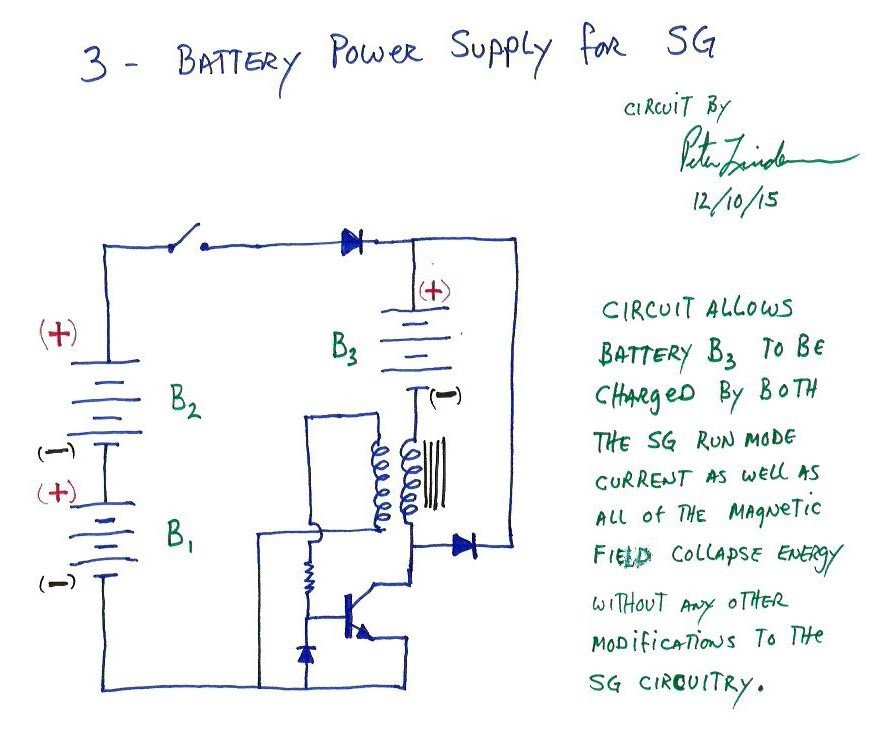

            Hey Bradley,
            The circuit Aaron is talking about is one I developed last December for an advanced SG project. Here's a drawing I made:
            It's remarkably close to your drawing. This circuit is designed to run with an automatic 3 battery swapper, to keep an SG wheel spinning for a long time. Also, the extra diode on the positive line is necessary to make sure the Radiant goes 100% to battery #3.
            Enjoy,
            Peter

              Peter - thanks for posting that. Super simple variation that does charge the battery like mad.
              Bradley - I'd recommend looking at the differences between the 1N4007 diode, which is commonly used with the SG and the UF4007, which is ultra fast.
              With the 1N4007 with the typical SSG, there is kickback to the front because that diode is really slow so you get some extended running time.
              With the UF4007, its so fast that virtually everything goes to the back battery.
              I guess it depends on if you want extended running time or you want the output battery to charge quicker.
              The difference is plain as day when you try both and you scope the diode or even just the batteries.
              Diodes make a huge difference depending on your goals.
              With the old Ainslie mosfet circuits pulsing a battery into an inductive resistor, I bypassed the junk intrinsic diode with a high quality fast one and got a 100% increase in the kickback going to the front battery. That just means the intrinsic diode is slower than molasses.
              I wouldn't get too caught up in the diode deal but if you want to throw everything at the back battery or in this case, the single opposed battery, then you might want to consider using UF4007 - they're cheap too.
              I got 400 delivered for under $8 on Amazon prime.

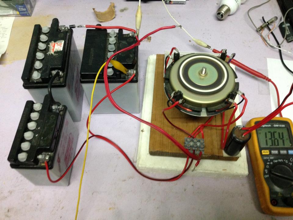

                              Here's one version I quickly put together. I already had the tape drive motor SG, so it only took a few minutes to get this running.
                              It's charging the heck out of B3!
                              I'm thinking about how I might be able use this in a four battery Tesla Switch
