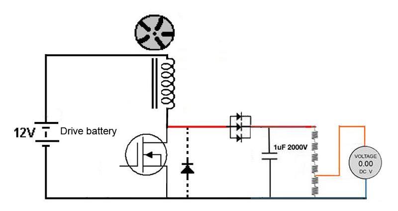

      My 'developer' friend in South Africa assures me that when the coil reverses its polarity as the HV pulse is generated, then the pulse can't be shorted through the coil in my setup as that part of the circuit becomes 'open circuit' for the duration due to the high inductance that the coils present to the rising edge of the pulse.

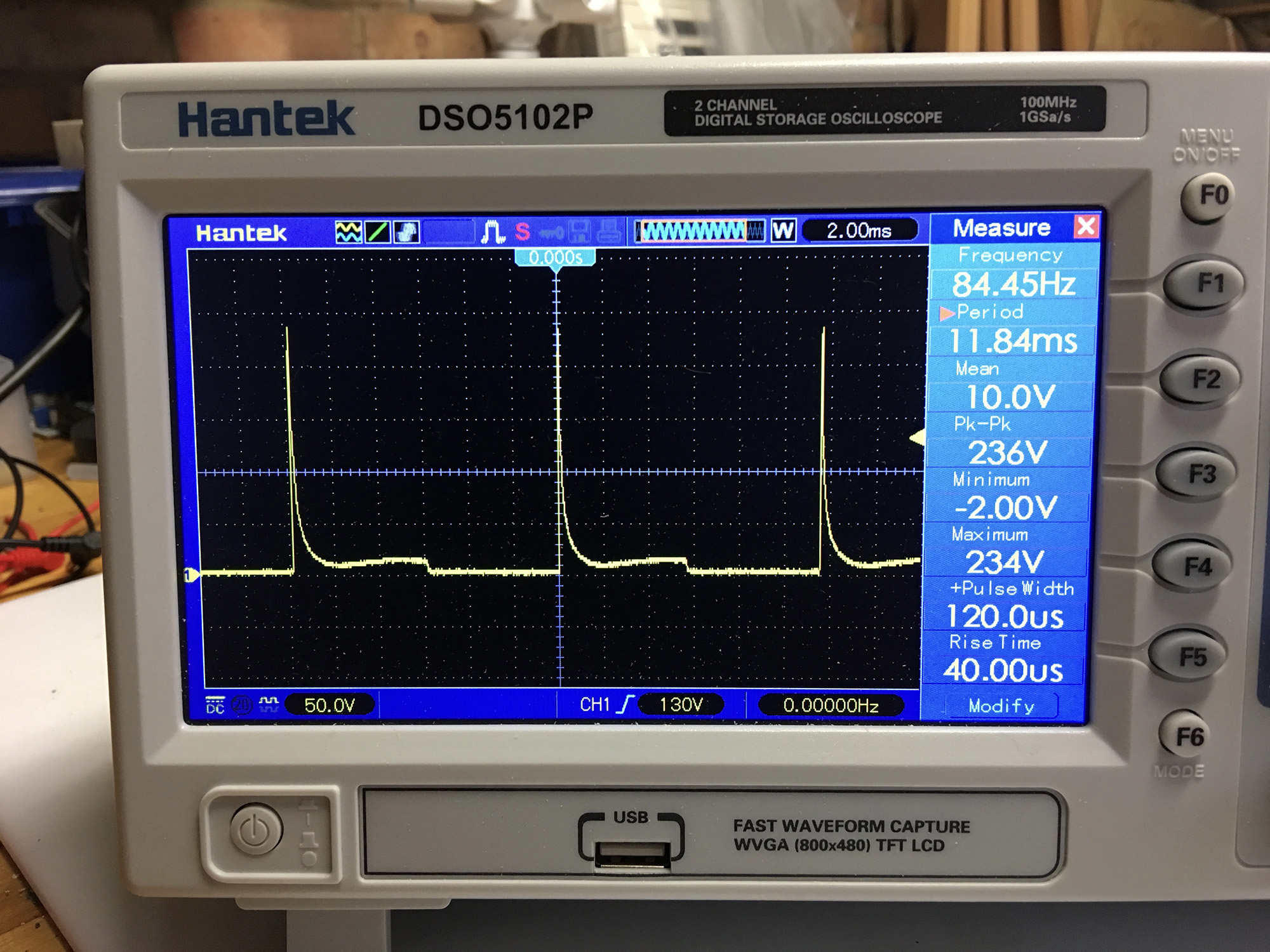

      My circuit instantly charges a cap of 0.22uF (2000V) when the HV line is directed to it via a 9:1 potential divider indicating that it is reaching a voltage of about 550V (see HV Measurement pic). However, the peak spike voltage seems to be a little over 2,100V based on the scope diagnostics.

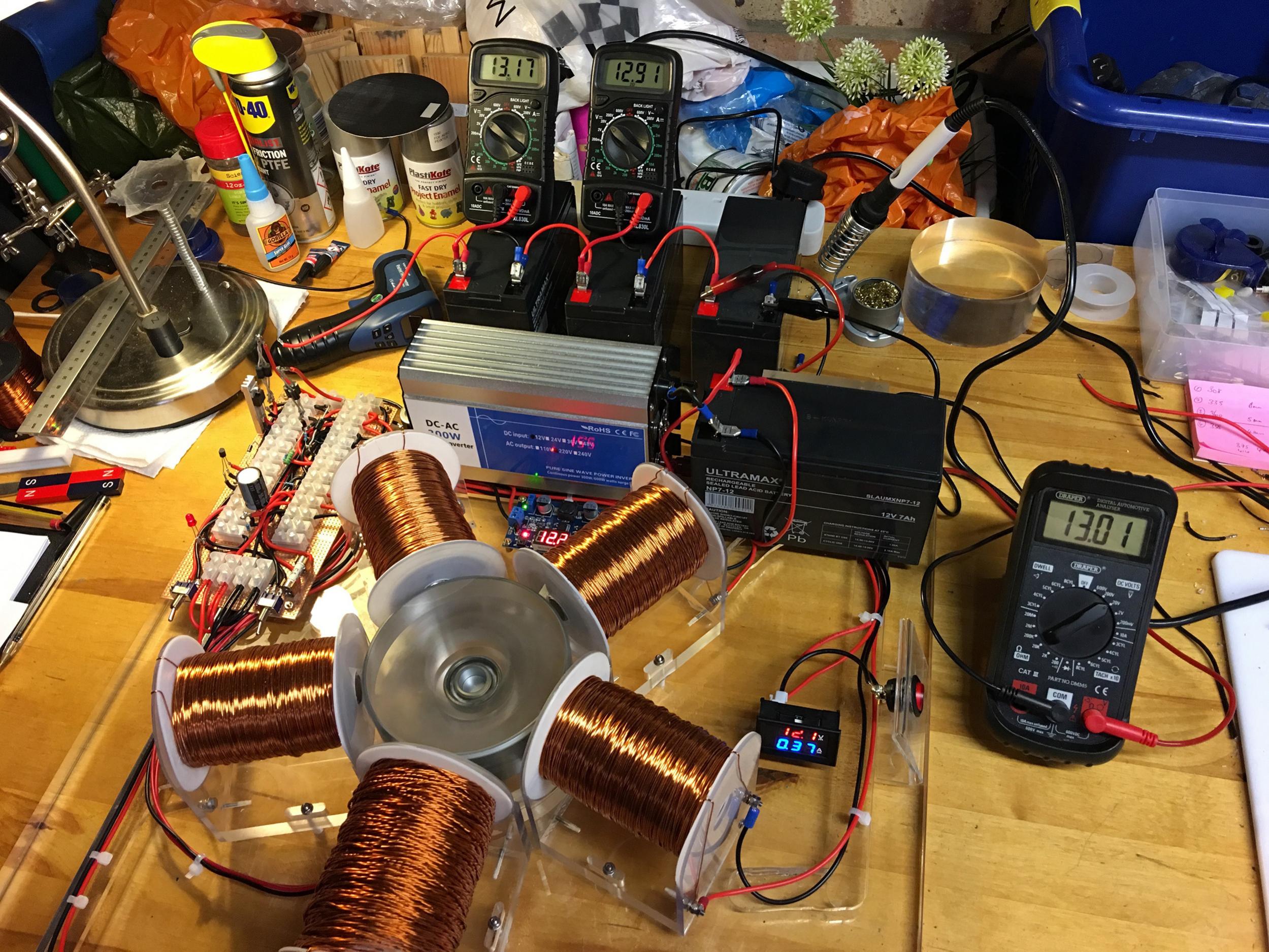

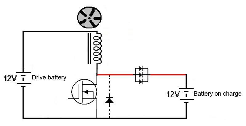

      I will soon see how well it charges a second and third battery (Charging second battery pic) while the drive battery is disconnected from the HV. As for routing the HV back to the drive battery he says he experiences no issues with his generator although it may take a time to show up as a voltage rise on the battery. I will need to do a longer test when I return from my trip.

        What you have shown in the attachments is the "drive battery is disconnected from the HV" and the HV line connected directly to a cap or secondary battery. This is the common ground mode (aka generator mode) of the two battery Bedini SSG system. And it does charge like crazy.
        I think if you also hook the HV back up to the run battery at the same time, you will see the HV spikes disappear and the cap and/or secondary battery will not charge. This would be very easy to try and then report back what it does.

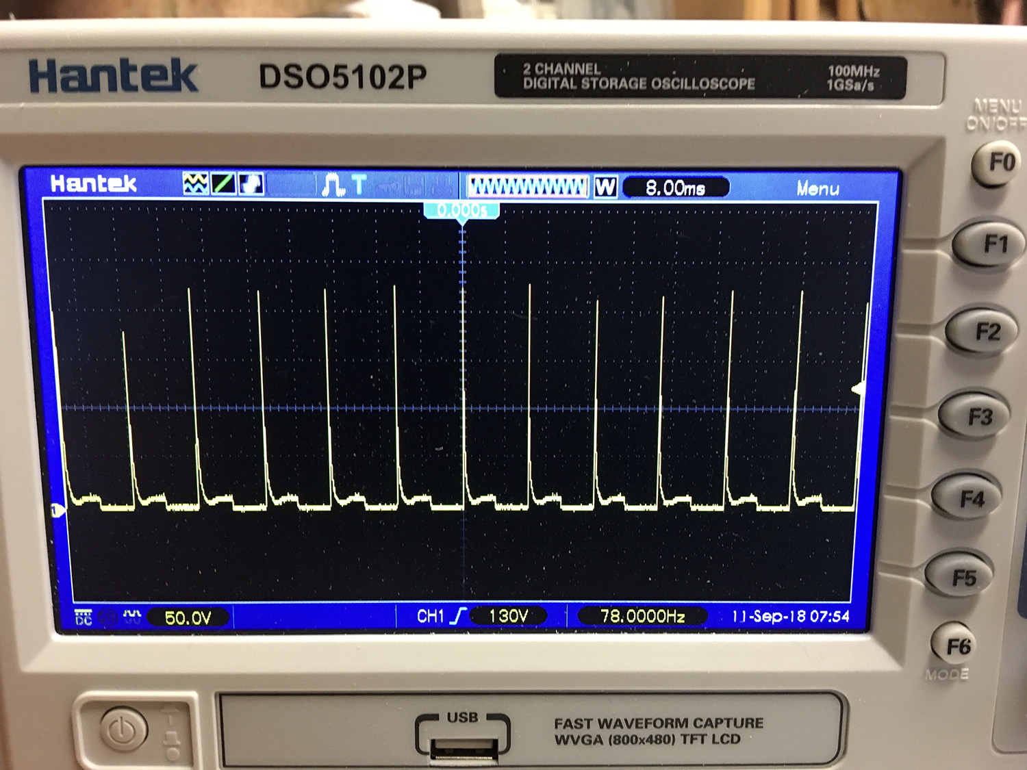

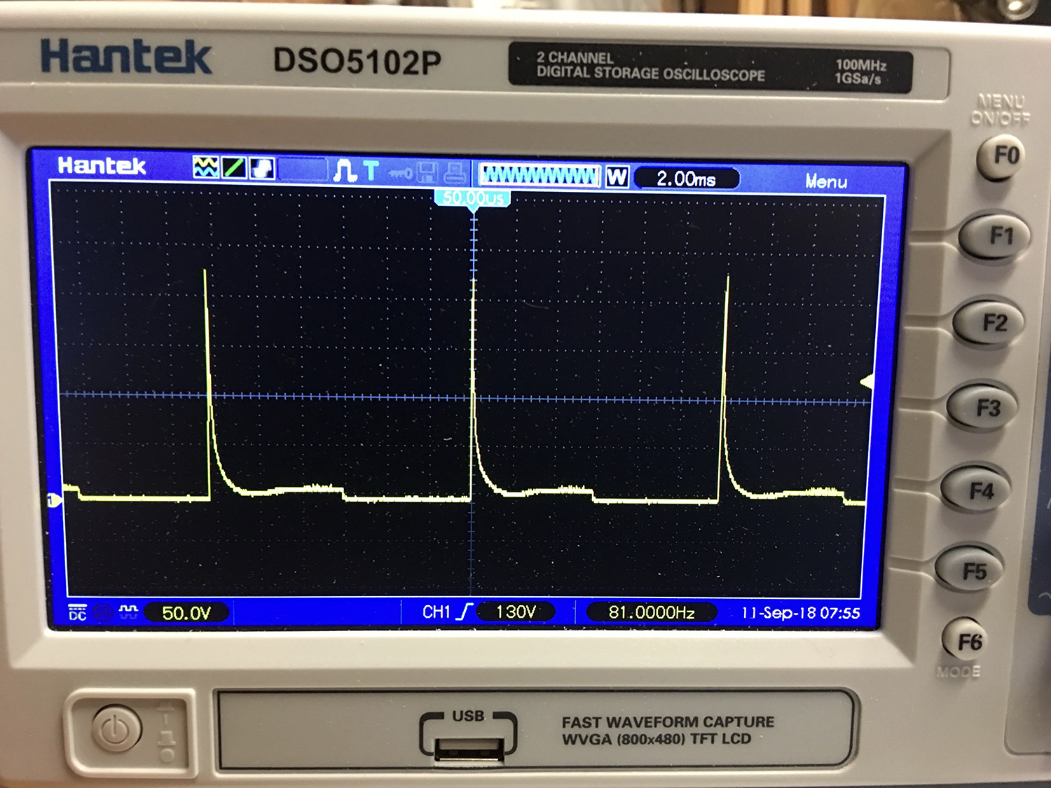

          Glad to see that your progress is very positive. It rotates at good speed! It appears that the generator is running around 1000 RPM based on the screen shot numbers, nice! You should be able to tune it for your needs.

            I have spent the last few days running tests with various battery configurations. I can confirm that the arrangement where the drive and external battery are connected with common ground results in neither battery charging. Does the common ground interfere with the way 'radiant' energy interacts with the batteries?

                                The reason arrangement 1 and arrangement 3 don't work is because the diodes are connected directly between the two ends of the coils as I previously pointed out. And arrangement 2 charges best because this actually is the two battery common ground circuit .
                                Arrangement 4 also works well because it is the conventional two battery Bedini method of radiantly charging secondary batteries with them being in series with the diodes between the bottom and top of the coils.
                                The only way to charge the primary run battery is by using only the two isolated windings in the main run coil with bridge diodes connecting them back to the run battery.
