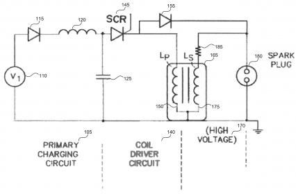

                            • Plasma Ignition picture. http://www.google.com/patents/US8555867
                              On this picture, 120, an inductive element, is that the Bergstresser coil?
                              There is also an inductive element, 220, on the boostercap side, would that also be a Bergstresser coil?

                                Those are not Bergstressor coils.
